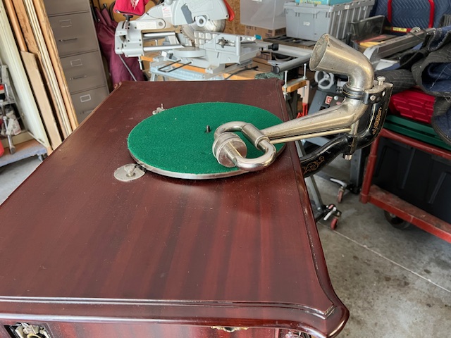

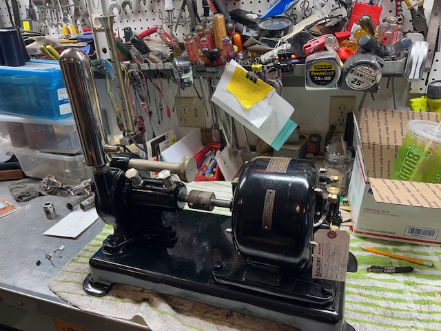

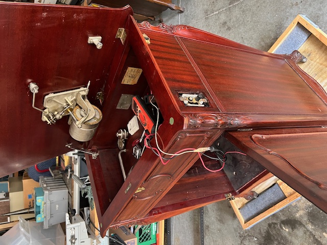

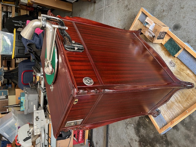

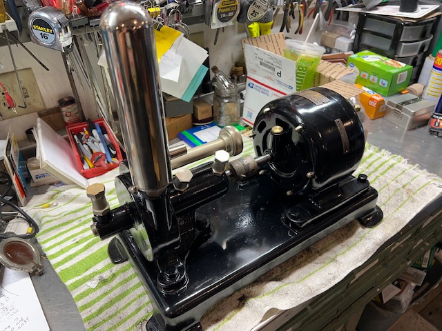

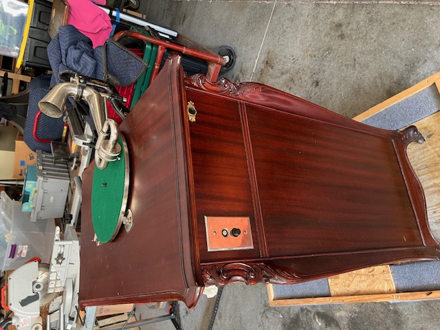

I am making some progress on the Victor Auxetophone. I had to rewire it also. The old cloth covered wire was very brittle. I couldn't find single strand 14 gauge cloth covered wire so I had to go with cloth covered stranded wire. The push button on/off switch is a bit corroded and will need to be dealt with. The connections are showing about 100-250 ohms of resistance when on. The finish is the best on the sides shown. The left side and front doors are a bit sun faded. I might just leave it alone. I don't have the skills to do anything with finishes and I don't want to have it all stripped and redone. The air pump, motor, and base look great but it is EXTREMELY heavy. I may have to assemble it in the cabinet instead of putting the whole thing in at once.
Many thanks to Paul Baker for rebuilding the air pump and Beaudry Motors for rebuilding the electric motor.
Here is the link to the original post: viewtopic.php?t=59522&hilit=auxetophone
Not sure what record to play on it's debut. Maybe a good Sousa March will get the neighbors all riled up.
