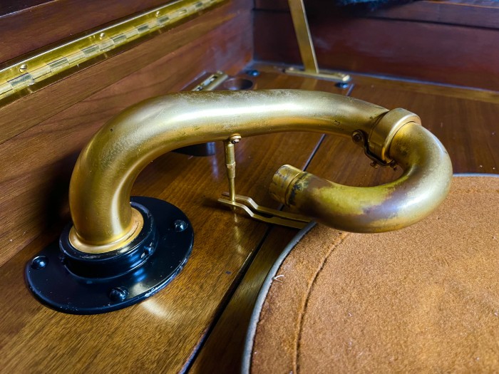

Hello everyone, I have a question regarding the tonearm on my Victrola XVI. I noticed strange specks, for lack of a better term, on the gold plate and was curious if this is something that can be cleaned, or if I would be better off having the gold replated or simply leaving well enough alone.
I previously had an Exhibition reproducer rebuilt by Wyatt Markus, and it came back looking shiny. I’ve since replaced it with a different reproducer, but I wonder if the same treatment could be applied to the tonearm.
Thanks for the help!

Have you tried ammonia?

Lucius1958 wrote: Mon Aug 04, 2025 12:45 am Have you tried ammonia?
- Bill
Thanks for the tip! I’ll give ammonia a try. I wasn’t sure what to use because I didn’t want to damage the gold plating.

As suggested, an ammoniated cleaner is very effective on gold plated parts. If you have access to an ultrasonic cleaner the L&R Jewelry cleaning solution is very effective. Also the Kotton Kleanser for metal product works well and will not harm the gold or lacquer finish. Brush is on for a few minutes and wipe off with a soft cloth, repeat if needed.
Below is an example of a very rough Credenza taper tube before and after treatment with Kotton Kleanser. Not perfect but much improved.
Show us your results.
Mark
