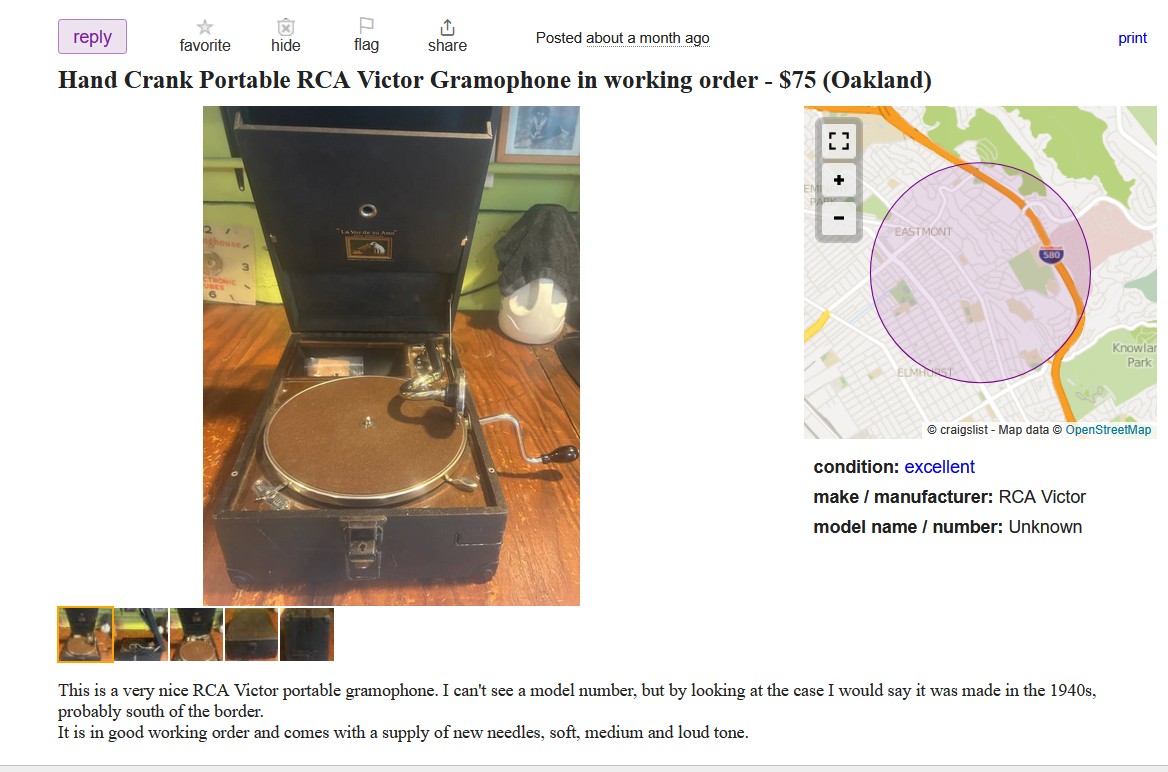

About a three weeks ago, I spotted an ad for this one on Craigslist-SF, coincidentally in Oakland, but for $75.00.
Since I don't drive, getting to Oakland can be a pita, but when I saw the ad was still up last weekend, I contacted the seller, explaining my transportation problems, but adding the IF he ever makes it into San Francisco, and IF it's still available at the time, I'd buy it and throw in $35.00 for gas money. Long story shot, he dropped it off today.

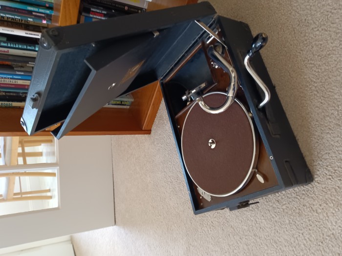

I've only given it a cursory wipe-down and oiling, and tested the motor, soundbox, etc..
It will need to have the motor re-greased (bumping spring), and at some point, the sound box will have to be overhauled with fresh gaskets, since it's a little high-pitched on some notes.
Inside, it looks brand new--the plating, turntable felt, Rexine, and wood veneer motor-board are virtually perfect--but there are a few scuffs and paint specs to take care of on the outside of the case, along with two tiny places on the bottom where the covering has worn through--both the size of half a dime. Nonetheless, I think, price-wise, I did very well.

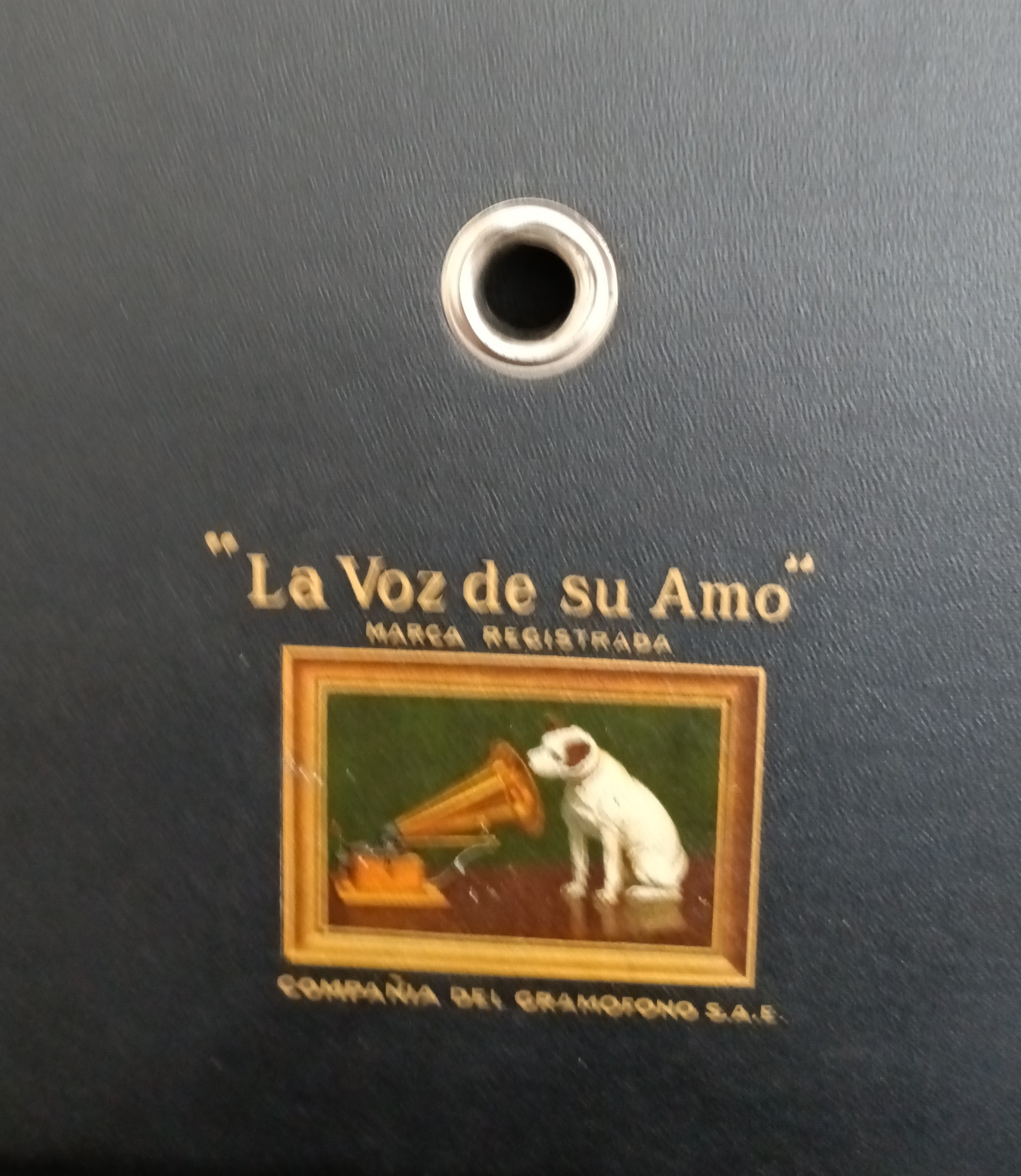

I'm wondering, though, if this is an export model shipped to Spain from the UK, or if it was manufactured in The Gramophone Co's Barcelona plant. There's no ID tag under the turntable, or other markings that I can see. It does not have the auto-brake so I'm assuming it was manufactured before 1930?

I don't know if our Gramófono branch made full machines... A logical hypothesis is that cases were made in Barcelona, and the machines assembled with parts imported from the UK...

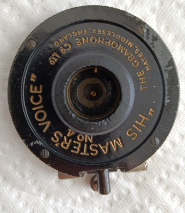

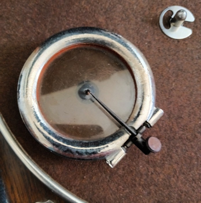

The sound box, I think, is pot metal. I'll post a photo of it later today. As an experiment, I squirted a little "Goo-Gone" around the perimeter of the diaphragm and let it set for a few hours. Believe it or not, there was a definite improvement in the sound quality--far more mellow and less high-pitched. I'll want to have it re-built to get the maximum sound quality, if it's possible.

Damfino59 wrote: Tue Aug 05, 2025 11:23 pm
Check to see if your soundbox backplate has embossed letters. It may be actually brass.
The lettering is recessed and painted orange/gold --

OrthoFan wrote: Wed Aug 06, 2025 3:28 pm
I can see some paint loss. It appears to be pot metal.
But that doesn’t mean it’s not rebuildable. You’ll just have to do some research on who to send it to.

Damfino59 wrote: Thu Aug 07, 2025 12:24 am
Many thanks. When I first tried the sound box on Monday, it sounded high-pitched and restricted--not much volume. The next day, I noticed what looked to be a small black smudge in the center of the diaphragm where the needle bar is attached. I blew into the throat and out popped a small black hard shard of what looked to be a fragment from a broken record--about ½ inches in diameter. (How it got into the sound box is anyone's guess!) I then applied a couple more coats of "Goo-Gone" to the diaphragm gaskets and set it aside.
Yesterday, when I tested it, I noticed there was a slight "give" when I tightened the needle screw. I have to say I was amazed at the difference in sound quality--very little surface noise and no high pitched ringing on the upper notes. Along with that, the volume was greatly expanded and the mid-range notes were clearly audible. After the record played, I inspected the needle tip--I used a conventional loud tone needle--and it was clean without black dust. This encourages me to take my time in having the sound box rebuilt.
