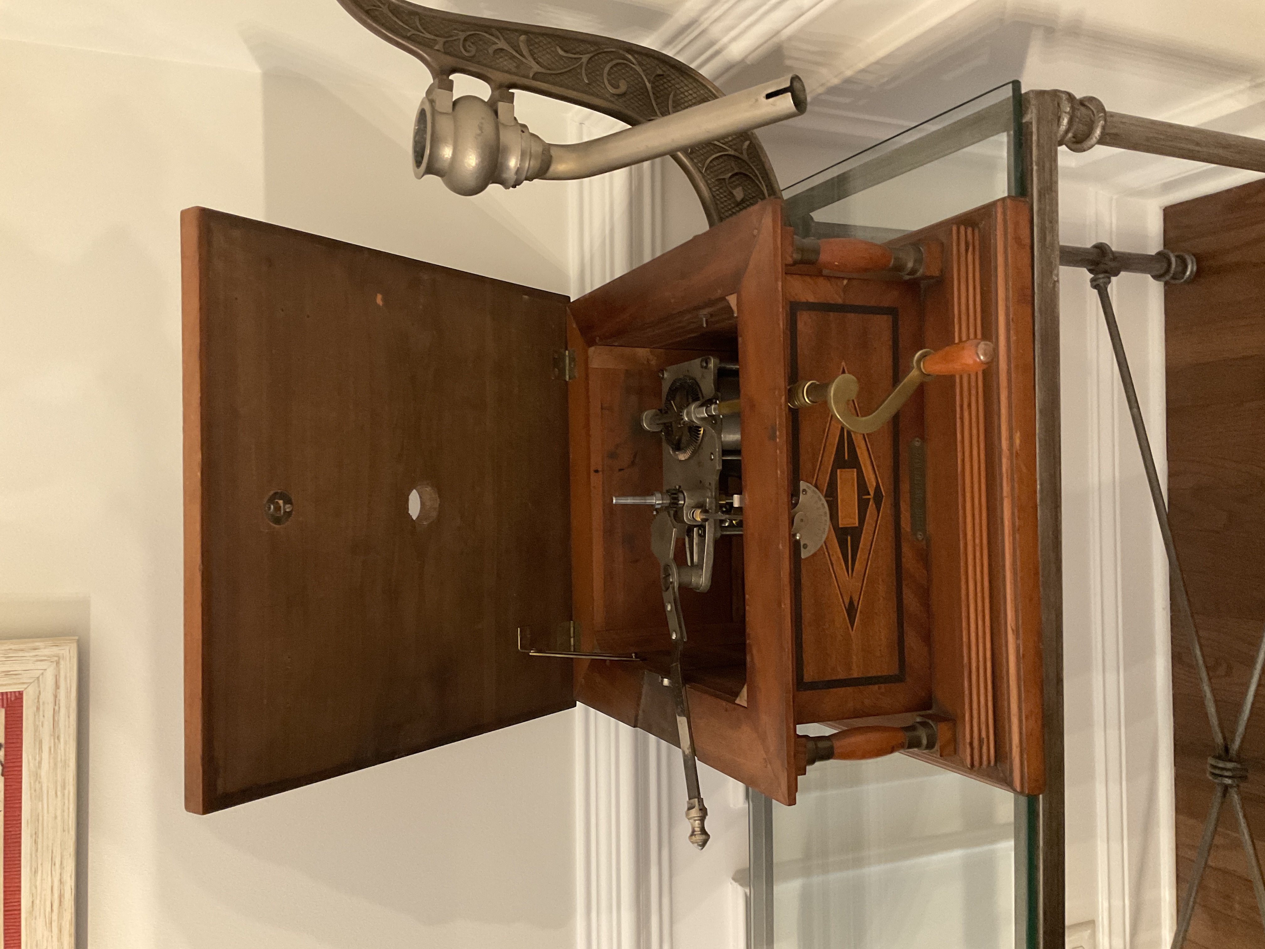

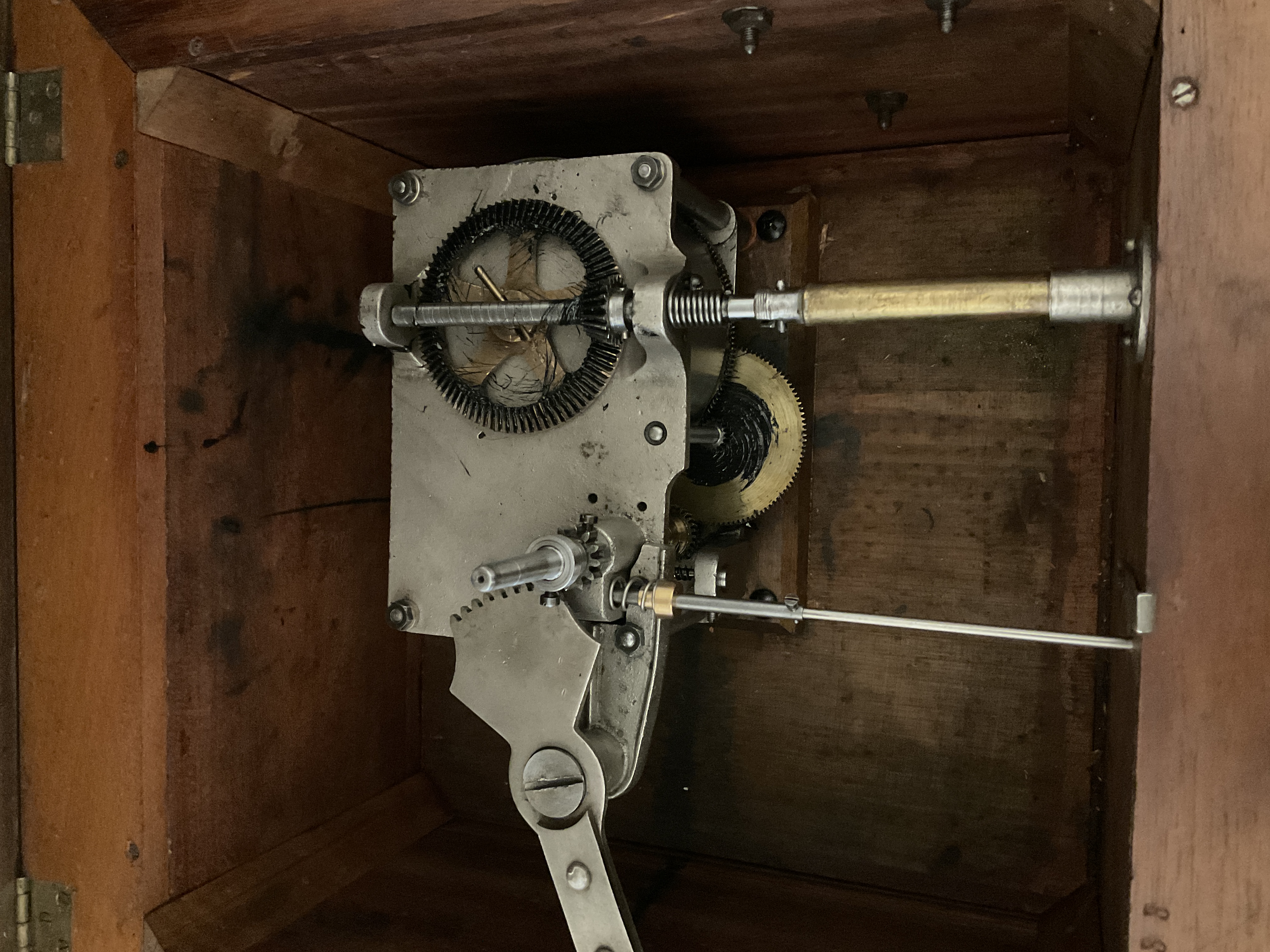

I have been working on this Pathé’ Concert # 20 outside Horn phonograph and the motor is very worn out. It will not play a 20 inch disc all the way through. Does anyone have a replacement motor?

Long shot here but could the motor be bushed by a clockmaker and the springs replaced?

What exactly is wrong with the motor?

What could be so worn that it can't be repaired/rebuilt?

The spring has been replaced and it runs better. It just will not play a 20 inch disc all the way through as it was designed to do.
