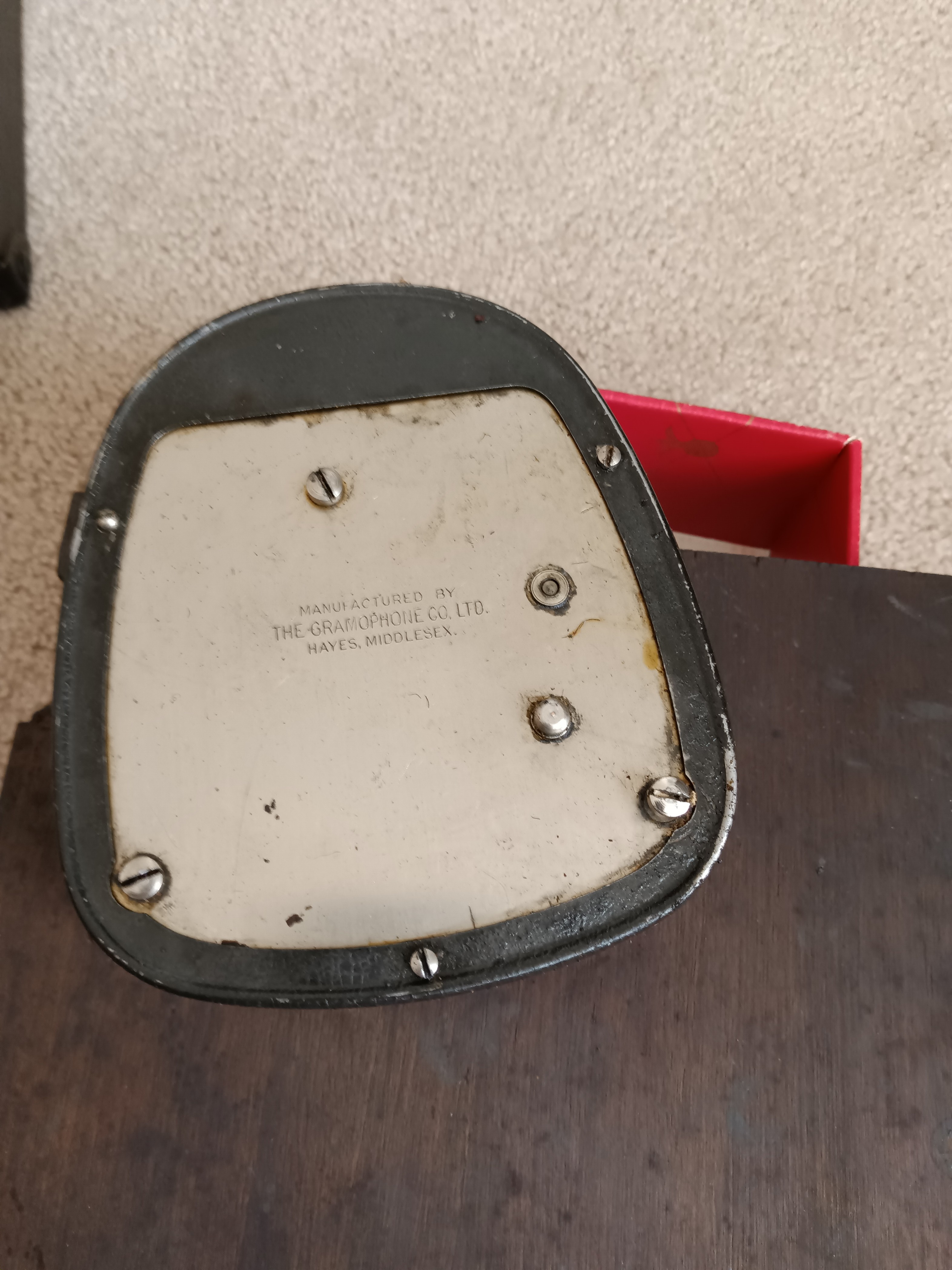

I still have no clue as to what that motor, itself, looks like, as you can see from the attached photo:
...But, I was able to clean out about half a dozen spent steel needles.
I'll open the motor's casing another day. In the meantime, I finally was able to re-adjust the speed lever by unscrewing the two retaining screws (shown in above photo) and--using a strobe disc--gradually sliding the plate and testing the speed until the turntable's 78 rpm speed matched the marking on the speed adjustment lever's plate. It's right on center now for 78 rpm.
Now to find someone local to me that will clean and re-grease the motor. After several coats of Goo-Gone around the edge of the sound box's diaphragm, the sound quality has been greatly enhanced with no hint of shrillness or "mica tone" and virtually no surface noise, even when using a loud tone needle. The treble and mid-range are strong and even some bass is apparent, so I'll save rebuilding the sound box for last.
