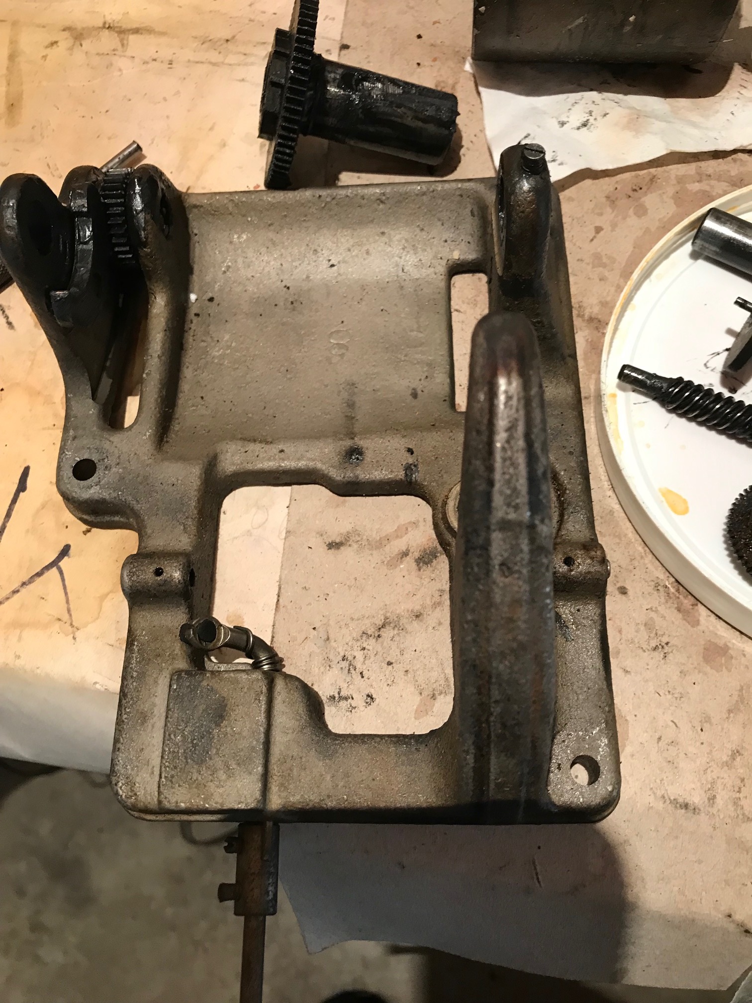

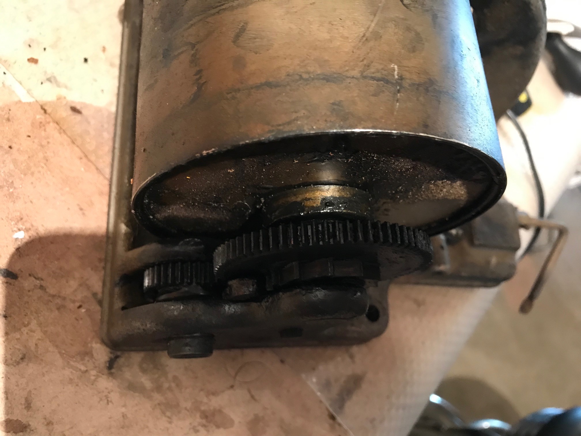

I've now included two pictures of the part I **might** soak.

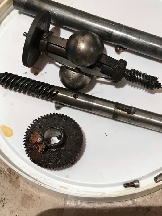

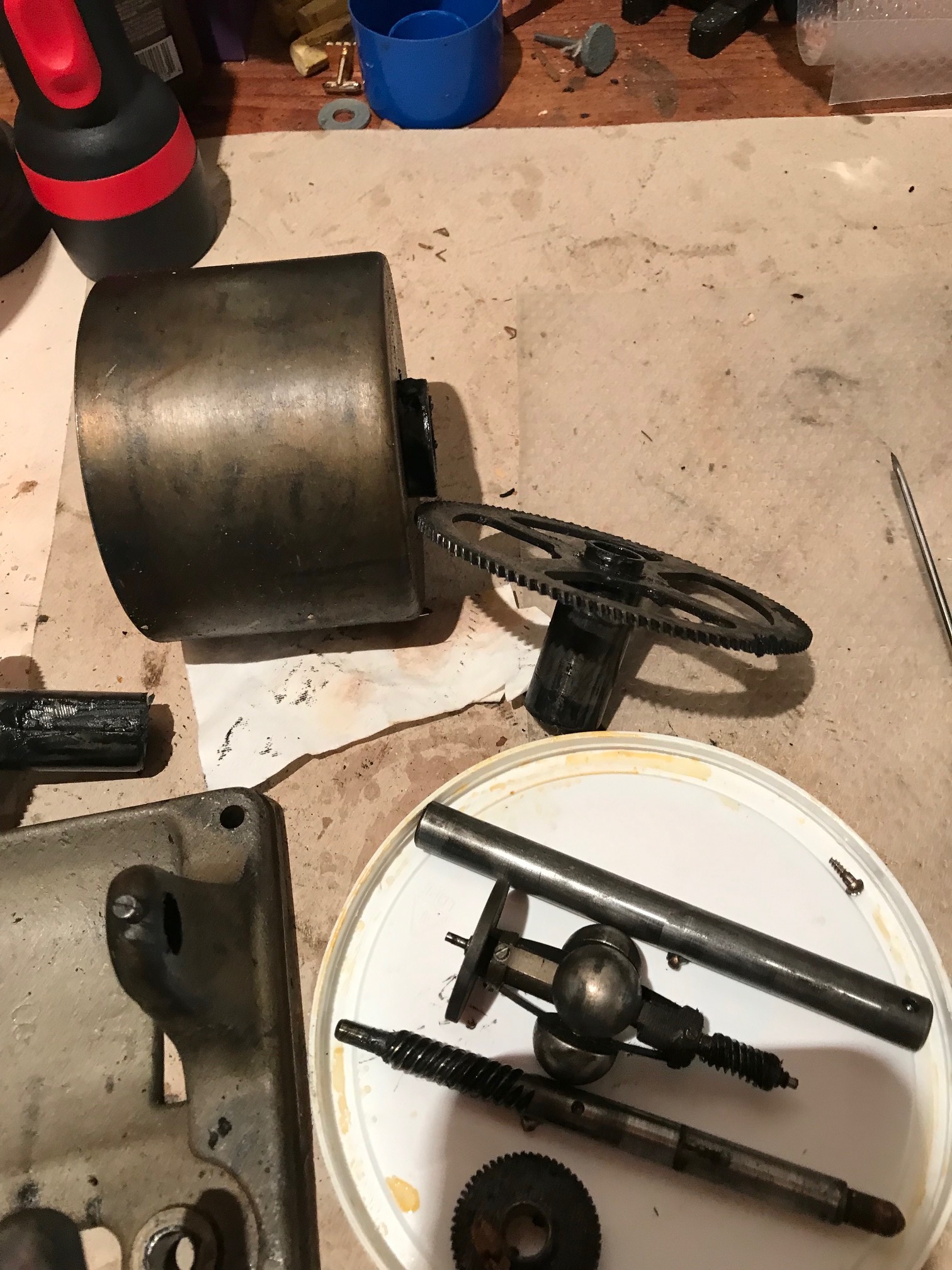

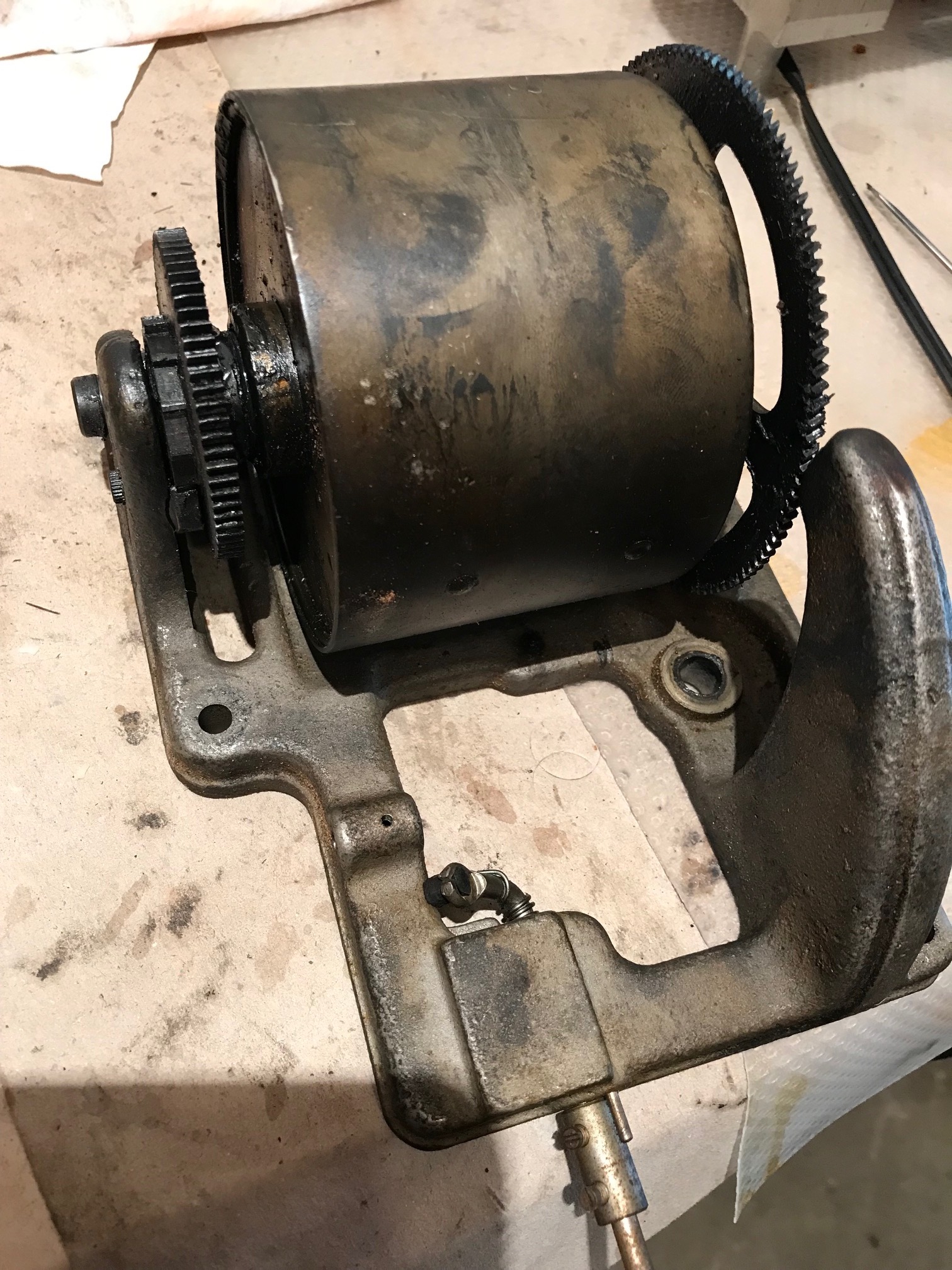

Well, the whole thing came apart a lot easier than I had anticipated. I drove out the barrel arbor after backing off on a screw, out dropped the barrel, etc. etc. etc. Note the dead bug. did it have a happy life? I have no idea, but it's days ended long ago.
So now I will soak the individual parts, as is the usual procedure.
