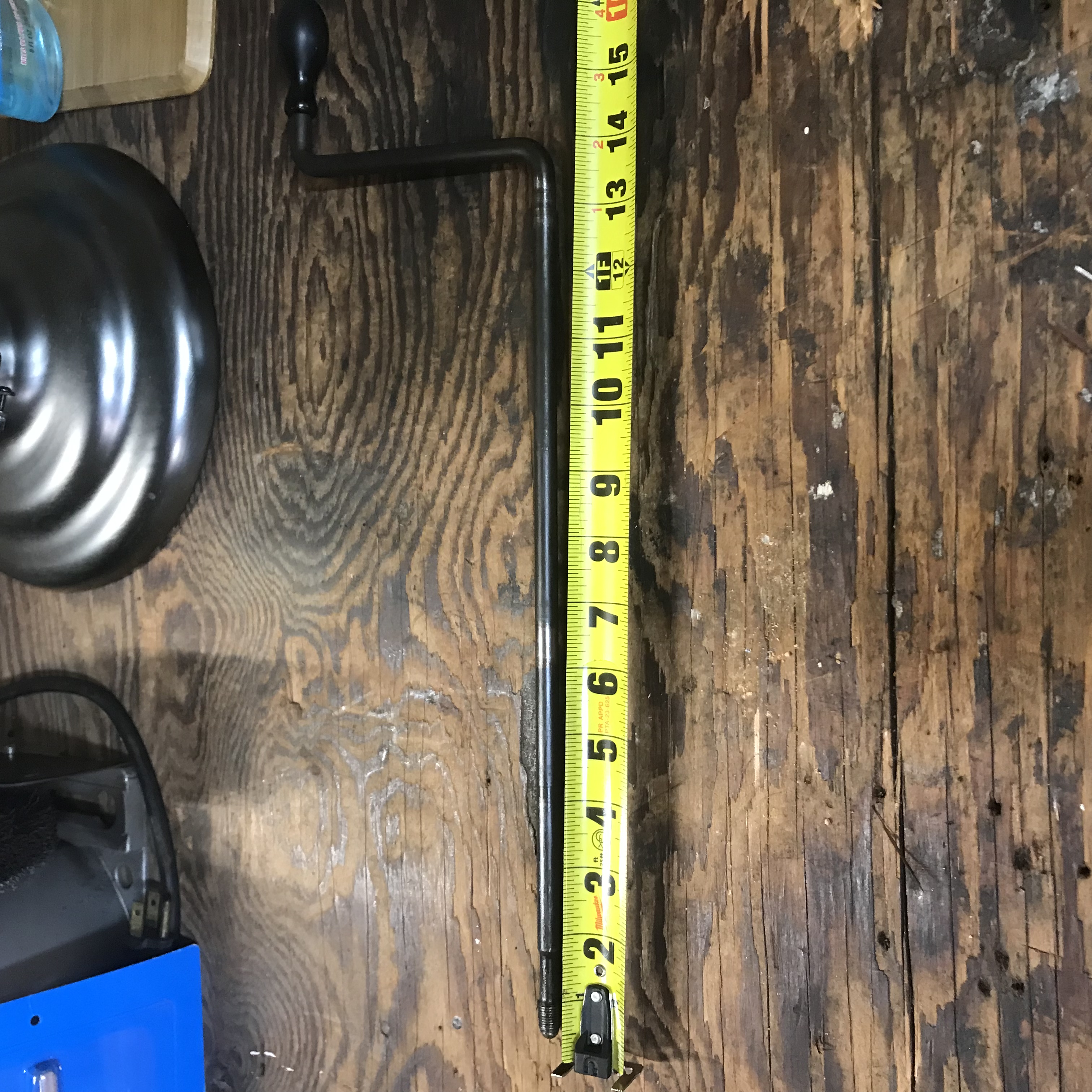

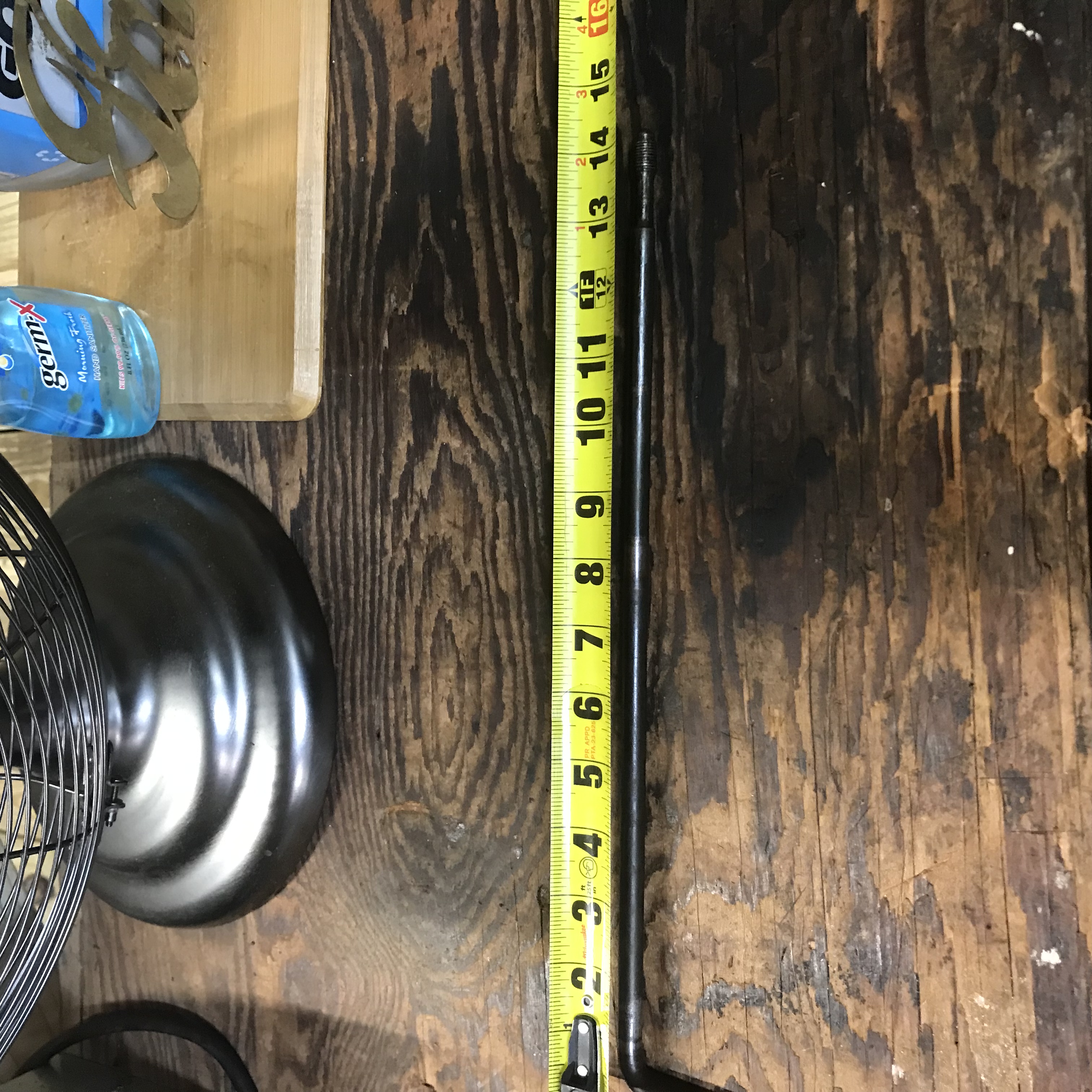

Can someone with an 8-35 tell me if I have the correct crank for my machine?
The one I have is approximately 14 inches long on the straight part.
Thanks,
Gene

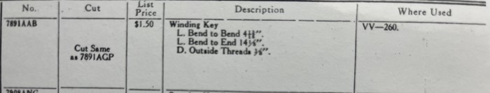

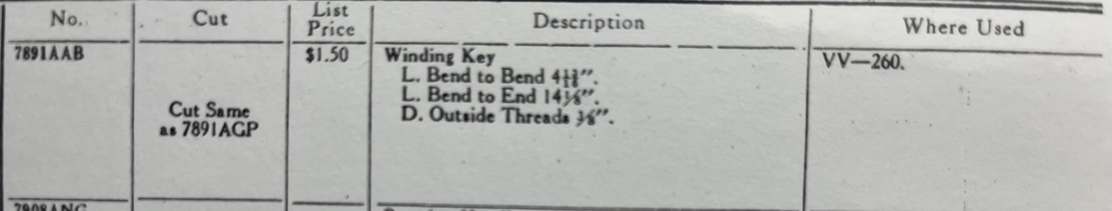

Re: Orthophonic 8-35 Crank Length
Hi Gene,
Your winding key (crank) looks correct. The Victor part number for the VV-8-35 is 7891AAB (AB means antique bronze finish).
The dimensions are listed below.
Mark
Hi Gene,
Always glad to help research Victor parts info, just send the Model and serial number.
Yours was easy since the VV-8-35 was short lived and had only one variant.
Looking forward to seeing you and other forum members in Wayne.
Mark
