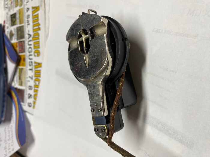

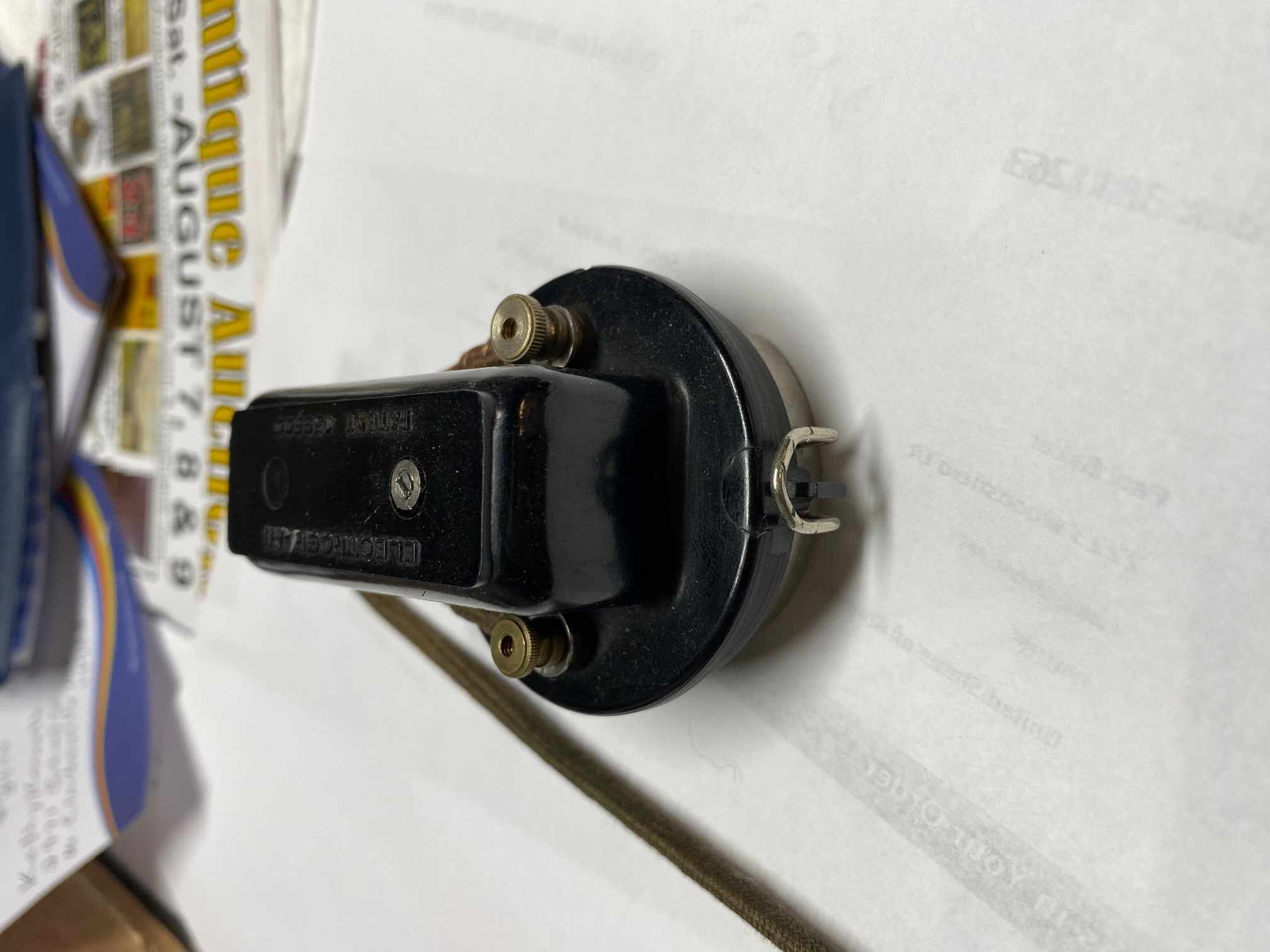

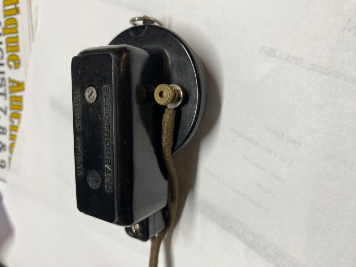

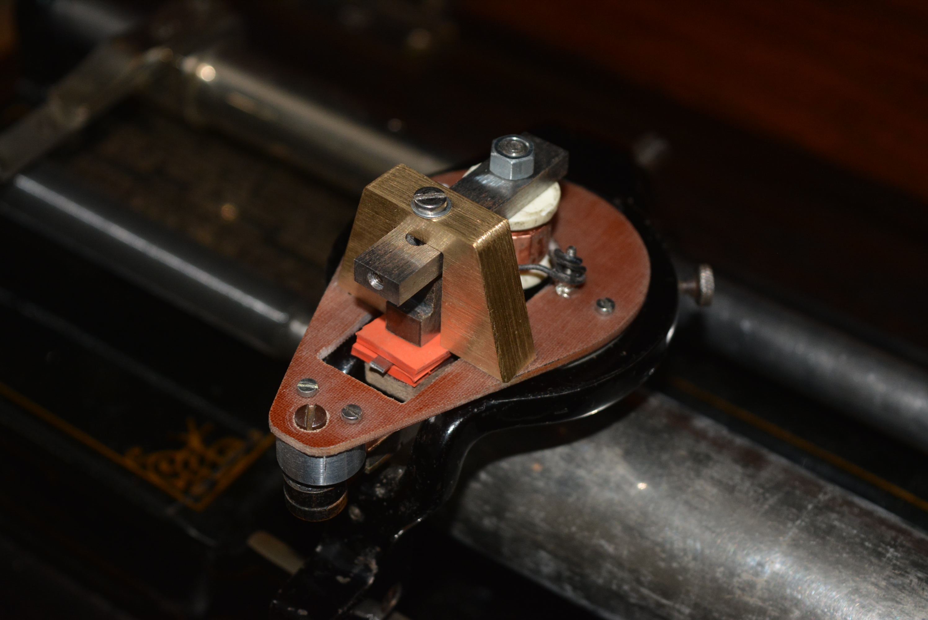

built this mechanism prototype in my workshop, just needs the stylus to test. like the original the coil pole piece is soft IRON not steel.

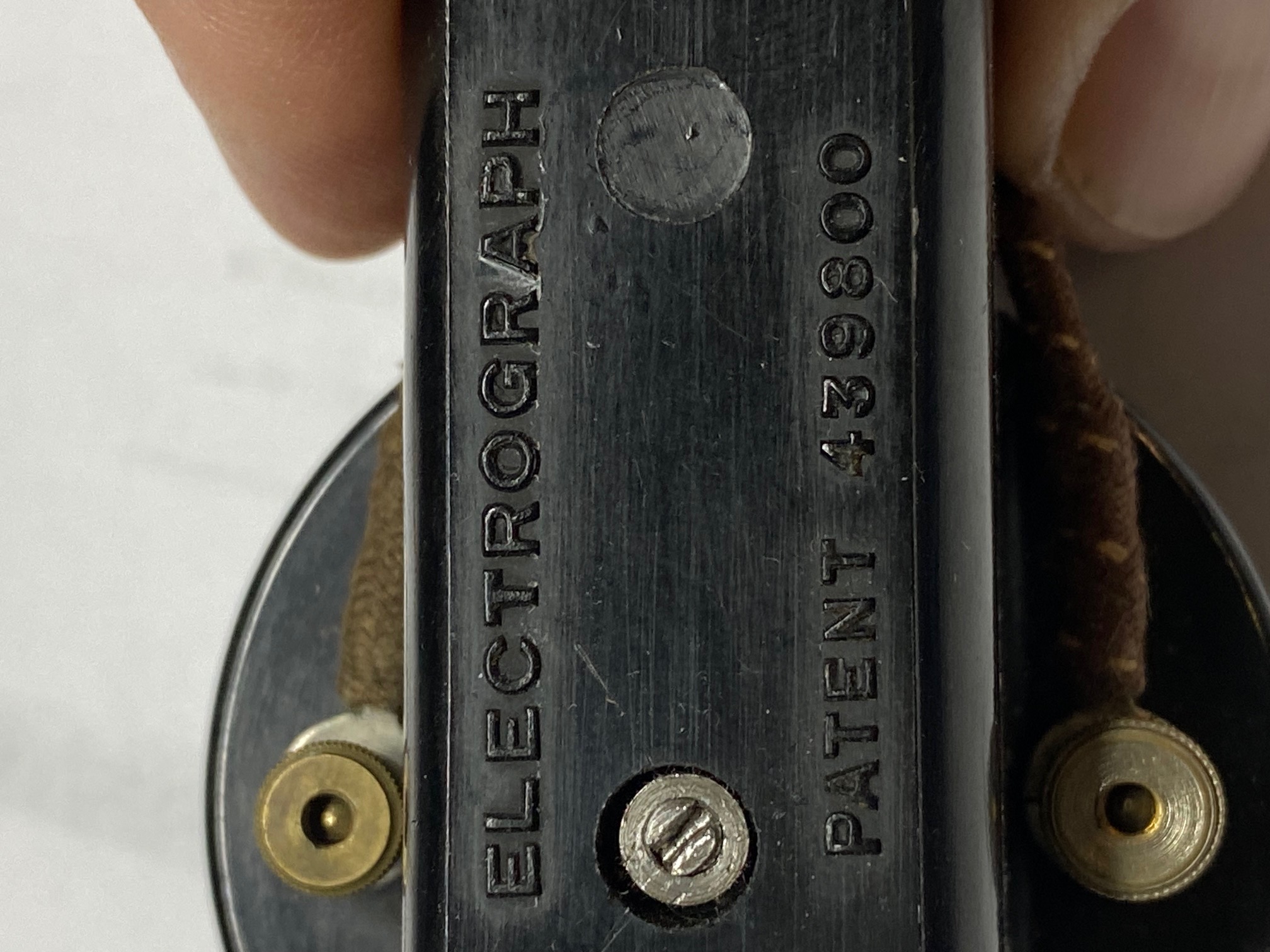

I found an original Electrograph recently, what an amazing reproduction it gives, video link here=https://www.youtube.com/watch?v=8AcabJRvKO4 Am planning to build a short batch of as close to the original as is possible in a similar housing.....as it's too good not to.
prototype copy of the Sykes Electrograph

The prototype is now working properly , Iv'e just recorded this Violin piece.
https://www.youtube.com/watch?v=mvkssuBsk70
I'm looking at the housing now & how to produce it,
Finding multiple lower weighted sections & good stylii is most likely going to complicate matters so I may offer the electro-magnetic top section only to use with an existing lower weight / stylus assembly.

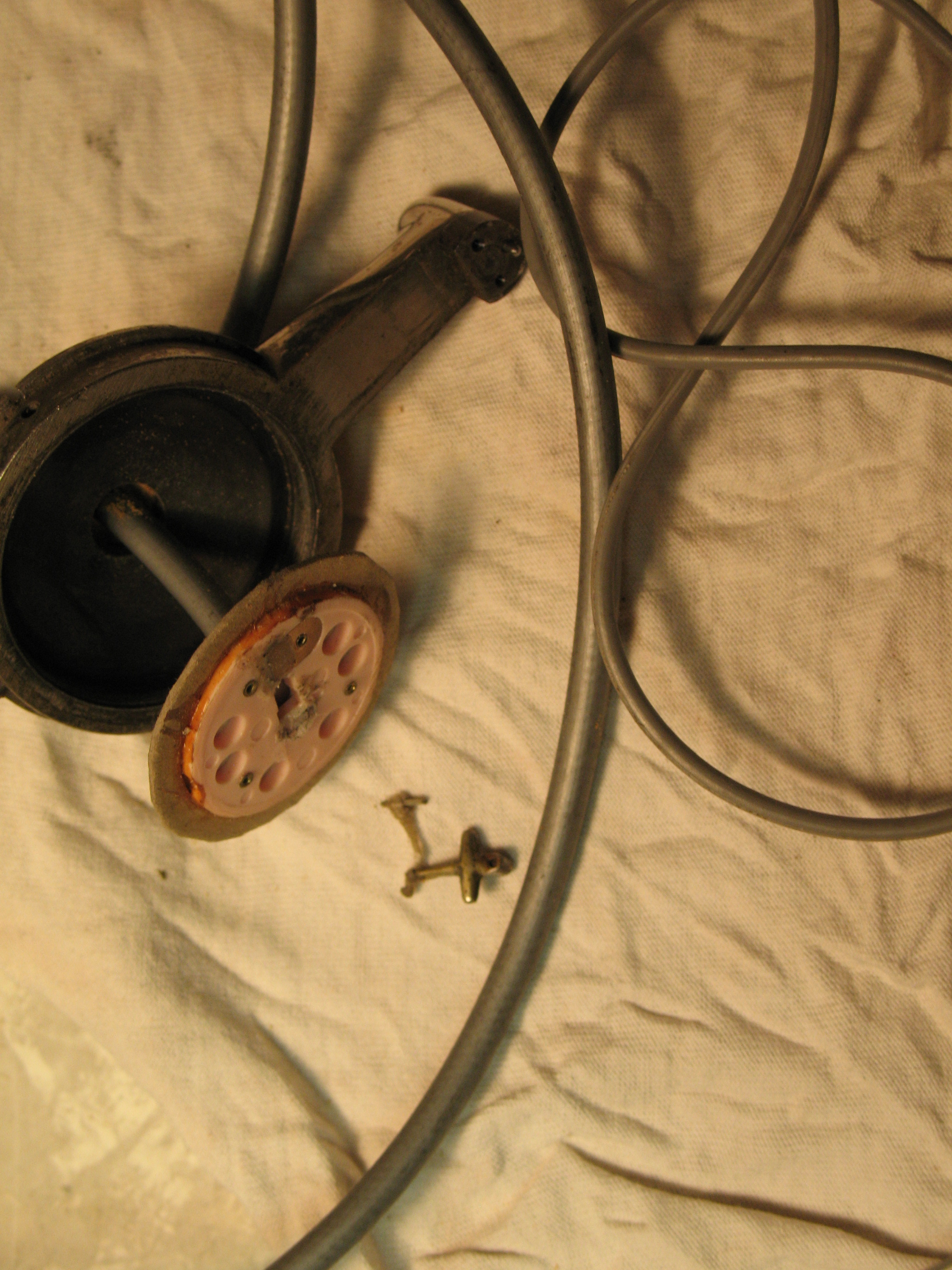

Many years ago (1960's), a phonograph friend of mt father built an electric pickup for 2- and 4-minute cylinder records. Both pickups replaced the Edison diaphragm with a crystal adapted from toy telephones to convert the motions of the Edison weight and stylus to electrical signals.
I used the two-minute version to record many cylinders, and the results are very good. The 4-minute version broke apart and a picture is attached.
The advantage of this type of pickup over the magnetic modern pickups for cylinder records, is that the mechanics of the Edison "system" are maintained, i.e. the modifications to the sound from the response of the weight lever system.
Marc
