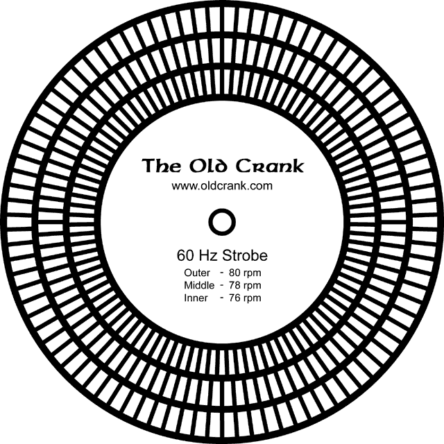

It looks like you've done a great job, but the turntable is spinning WAY too fast. It sounds like it's turning about 90 rpm, instead of 78 rpm.
The record should sound like this:
[youtube]http://www.youtube.com/watch?v=Ifb48PEVKOQ[/youtube]
If you don't have a strobe handy, you can clamp a bit of tissue paper under a record and count the number of times the paper it hits your finger as the turntable spins -- For 78 rpm, the paper should strike your finger 39 times in 30 seconds.
You can actually get a good disc strobe online--that you can print with a standard printer--that works with a light bulb shining on it, but I can't find the link for it right now.
You'll notice a considerable improvement in the sound quality once you get the turntable at the correct speed.

Here's a link to the vintage record changers site that allows you to print out a strobe card:
http://myvintagetv.com/strobe.htm

Hi Recordo:
Yes that's that link. Many thanks.
There are other, simpler strobes, available online.
I found the one I use, this morning, which I got from the Old Crank site --
http://www.oldcrank.com/articles/ (60 Hz for US/50 Hz for Europe, etc.)
It's very basic--just three speeds--but it works pretty well.

You know that is what I thought. I thought I could do it by ear but I guess my ear is off
. Thanks to the link to the strobe. I'll work calibrating the speed with that but the example of the recording playing at the correct speed is a big help. I make the new video and at 78 rpm without the Alvin & Chipmunk effect.

Thanks for pointing me to the strobe patterns. That was very helpful in correcting the speed. Here the playback of side A of the same Victor VE record (20819-A " What Do We Do On A Dew-Dew-Dewy Day"). I apologies for the poor condition of this recording. It was subjected to children (me and my bothers) that didn't know the proper way to the machine.
