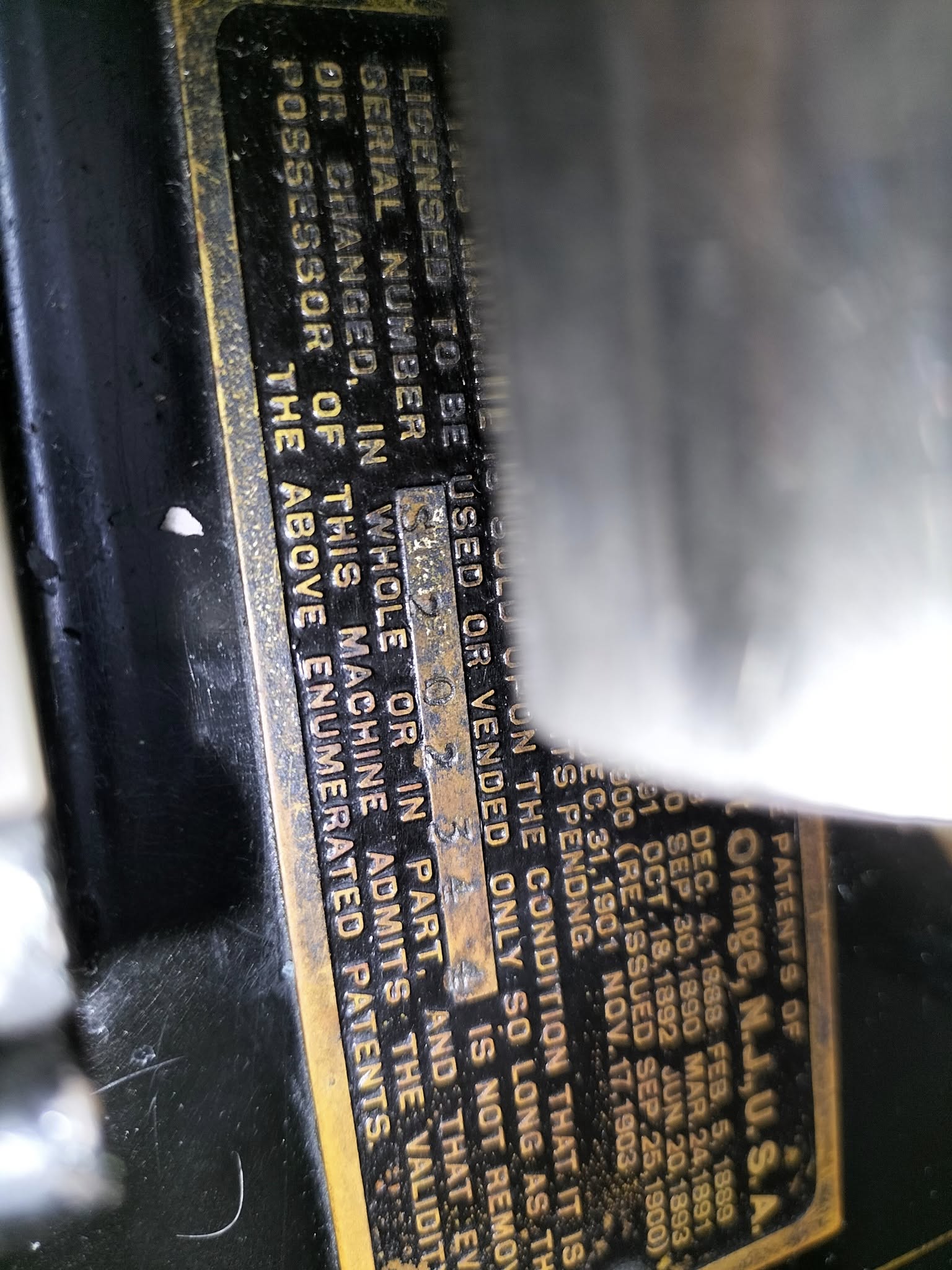

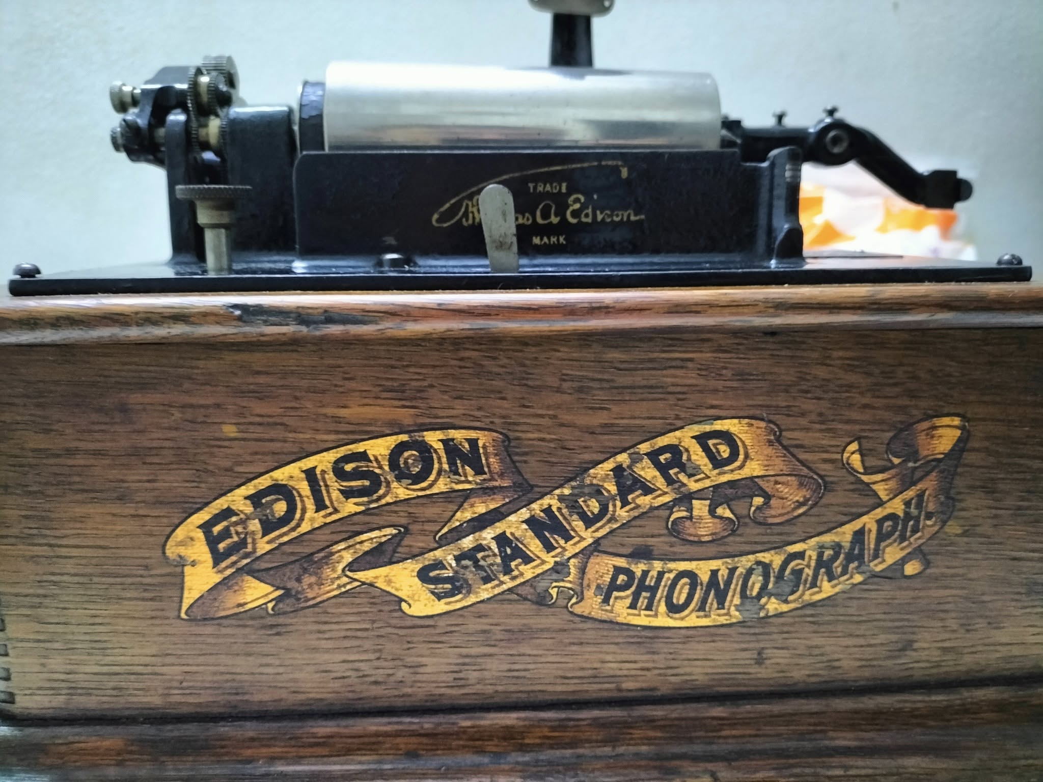

Hi all, I acquired an Edison Standard Phonograph Model A with a serial number S202344. The inside of the lid is greener, and I suspect that it's actually green oak. Would a guess of age of around 1903 reasonable? Have attached some photos for reference.

According to Edison sales records, Standard #202344 left the factory in March 1905. An article with dating chart on all models of the Edison Standard (A-G) appeared in the December 2023 issue of the Antique Phonograph Society quarterly magazine.
