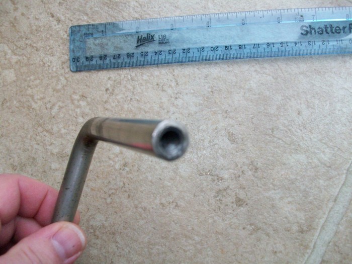

I own a 1916 Sonora elite. Here is the crank.need4art wrote: Fri Nov 07, 2025 4:39 pm Hi All,

Re: Sonora Elite Crank Dimensions
Hey audiophile 102 Thx for the help and picture!
Abe

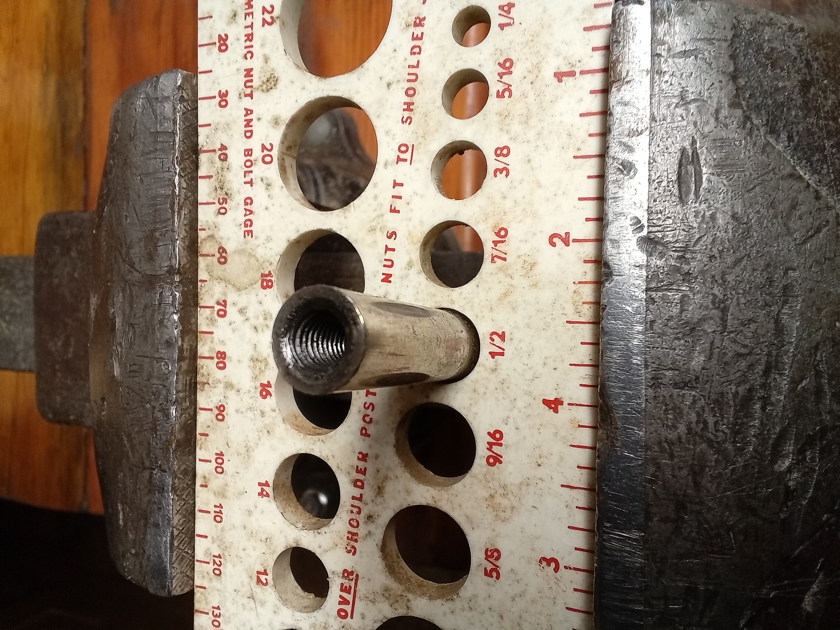

Hi Audiophile,
Well the member that is helping to find the crank (who has 150 of them) would like crank OD and stem thread (how the heck do you figure that out)

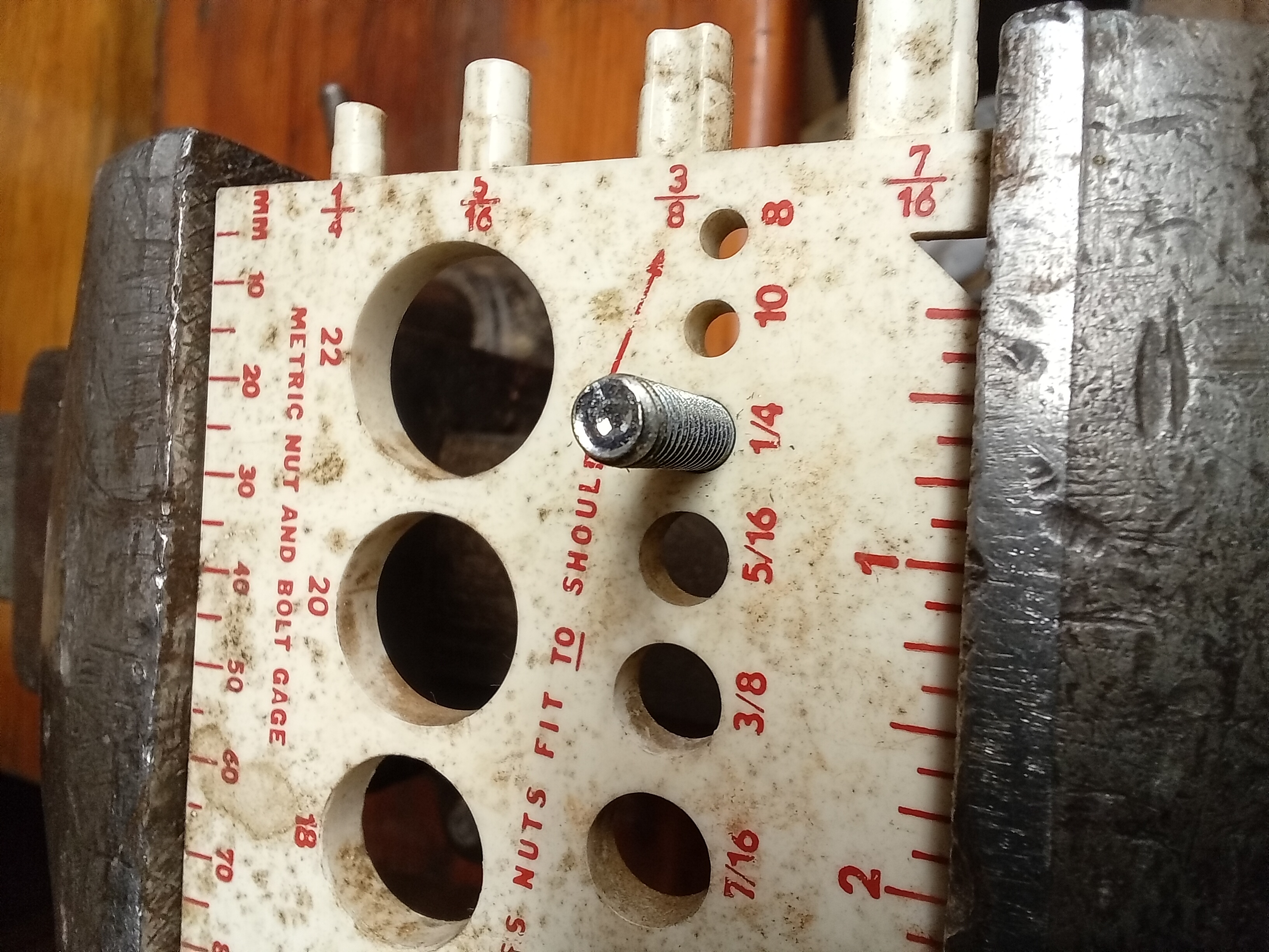

I used my gauge and here are the results. The bolt in the image doesn't have the right thread, but fits in the female crank end. Hope it helps.

It appears that the thread could be any one of the following: ¼-20, ¼-24, ¼-28. (And, just maybe, 14-24, which is not the same as ¼-24... but close)

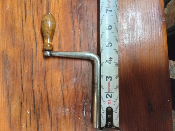

I have a spare crank that matches the given dimensions.
4" to the bend, ½" rod with ¼" female threads.
PM sent.
