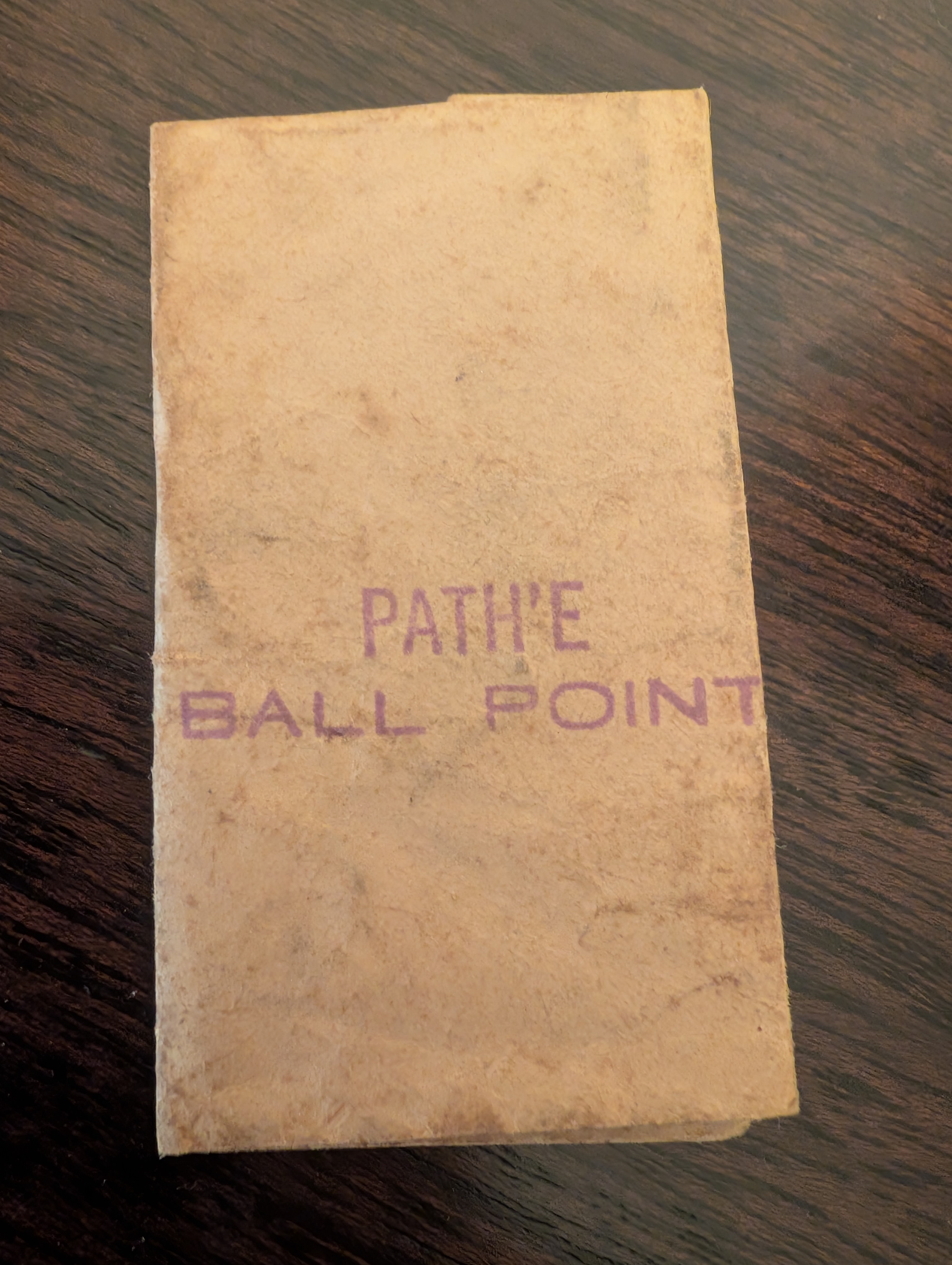

I recently found a NOS sapphire shank stylus in a little envelope at the bottom of a box of dusty lateral-cut 78s I pulled out of someone's basement. If the envelope hadn't been stamped, I certainly would have just thrown it away without looking inside. (As it happened, I almost did, anyway.) The stylus is good, and I've been using it to play the few dozen vertical-cut 78s I knowingly own. (It's entirely possible I own more, but the only ones I know of are Pathé; if there are other vertical-cut labels, I'd be grateful to learn what they are.) I'm interested in picking up more vertical-cut discs, if anyone has some they'd like to sell. I don't care what the content is (except, please, no classical music) or the label (though I have a strong preference for American records). If you have some you'd like to part with, please let me know. Thanks!
