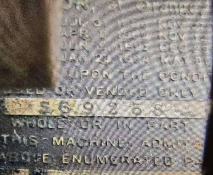

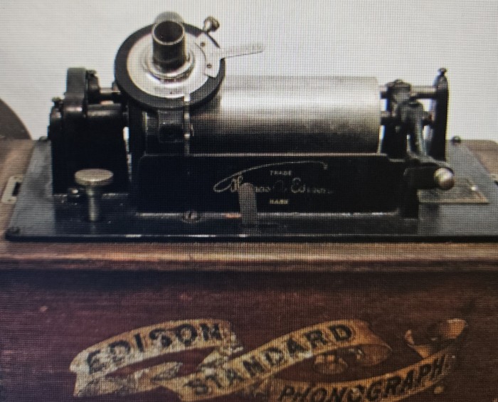

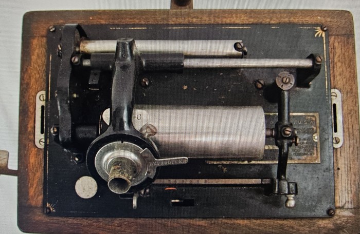

Note: I do not own the below pictured machine. Just trying to figure out what it is. The serial # seems way too early for the case. I'm going out on a limb, because I'm not positive. But the one in these photos appears to be a 4 clip A with a later carriage. Should it have originally been in a 4-clip case with an automatic reproducer? Are the bedplates the same size as with the later cases? Are the corners drilled out, if so? Nothing but questions lol. The serial #, shown clearly on the straight edge is S69258-so pretty early. Thoughts?

It sure looks like a regular oak case to me.
I guess in the universe of 800,000+ Standards made you could say it's early.

Standard #69258 left the factory in November 1902. The "New Style" cabinets were introduced in early 1901. The pictured Standard looks perfectly legit. The illustrated article on Edison Standards (with serial dating chart) appeared in the December 2023 issue.
