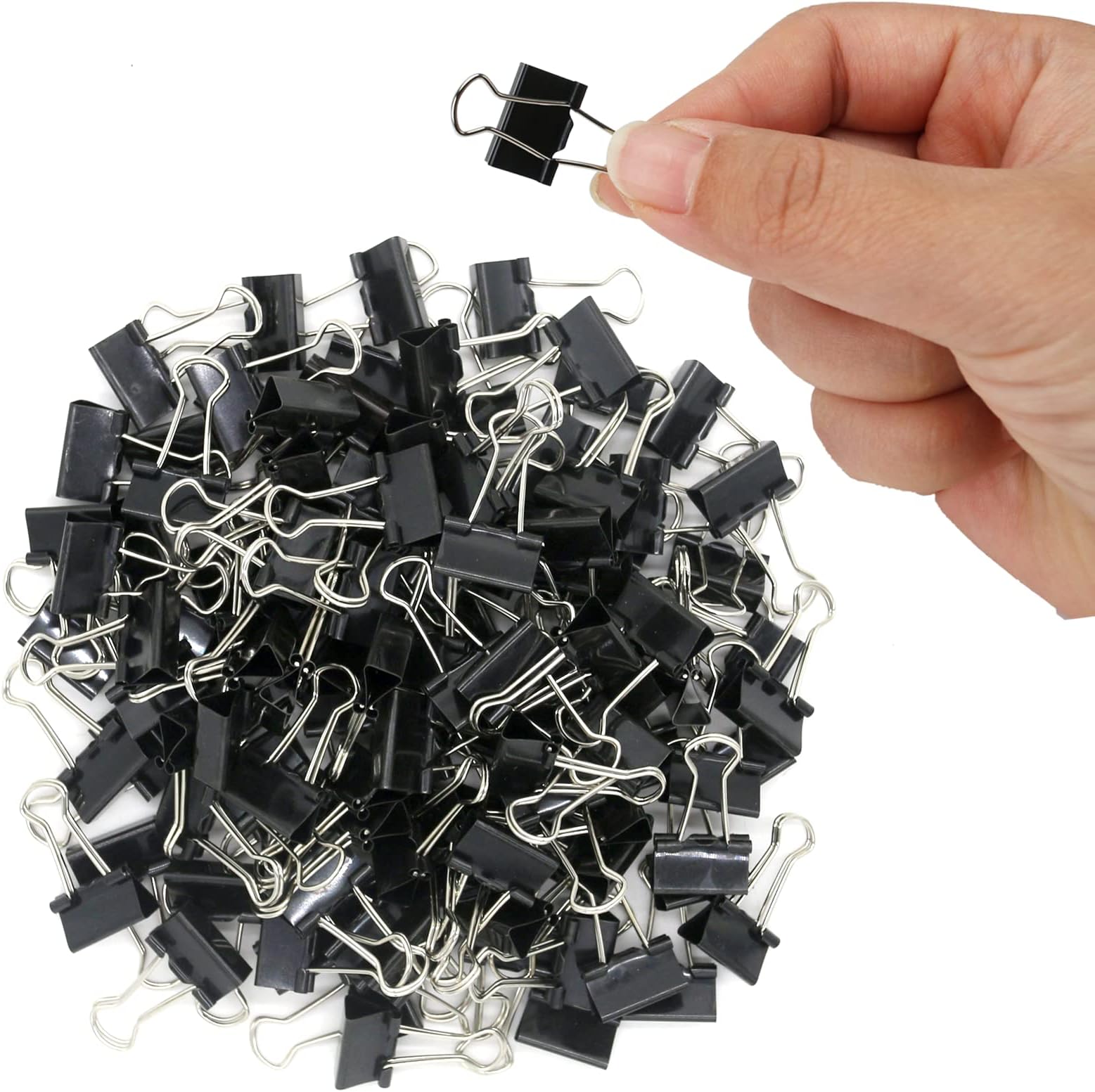

My standard method is to put a diamond disc on the platter, and then the HotW, then press the middle down and clamp the smallest size binder clip onto the spindle. The DD provides a good flat base surface and the clip takes out most of the bowing, while also helping to prevent rotational slippage.
