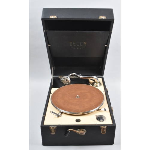

The Post-War Decca 50 is also of lighter construction than the HMV102, but similar in layout. It has a very good soundbox based on the Pre-War Meltrope III, for which Decca acquired the rights after WW2.
Decca 50.jpg (79.75 KiB) Viewed 4177 times

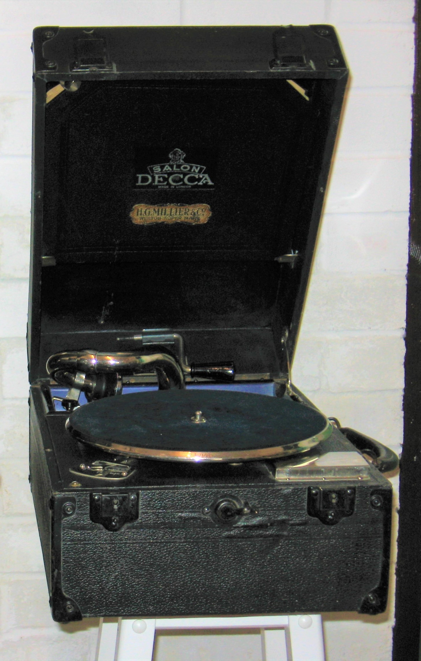

What was possibly the largest horn ever fitted to a portable was in the Decca 120 and 130 models. Here is my 120, purchased from the family of the original owners, whose Golden Wedding Anniversary gift it was in 1929.
I have every Decca portable model from this era and the earlier 1920s range. I would agree the horn of the 120 and 130 makes these machines quite special. To my ears they are superior to the contemporary HMVs, although the Columbia 202 miraculously gives them a run for their money. A lot of collectors only appear to be interested in HMV though so the Deccas and Columbias are also usually available for a fraction of the price.

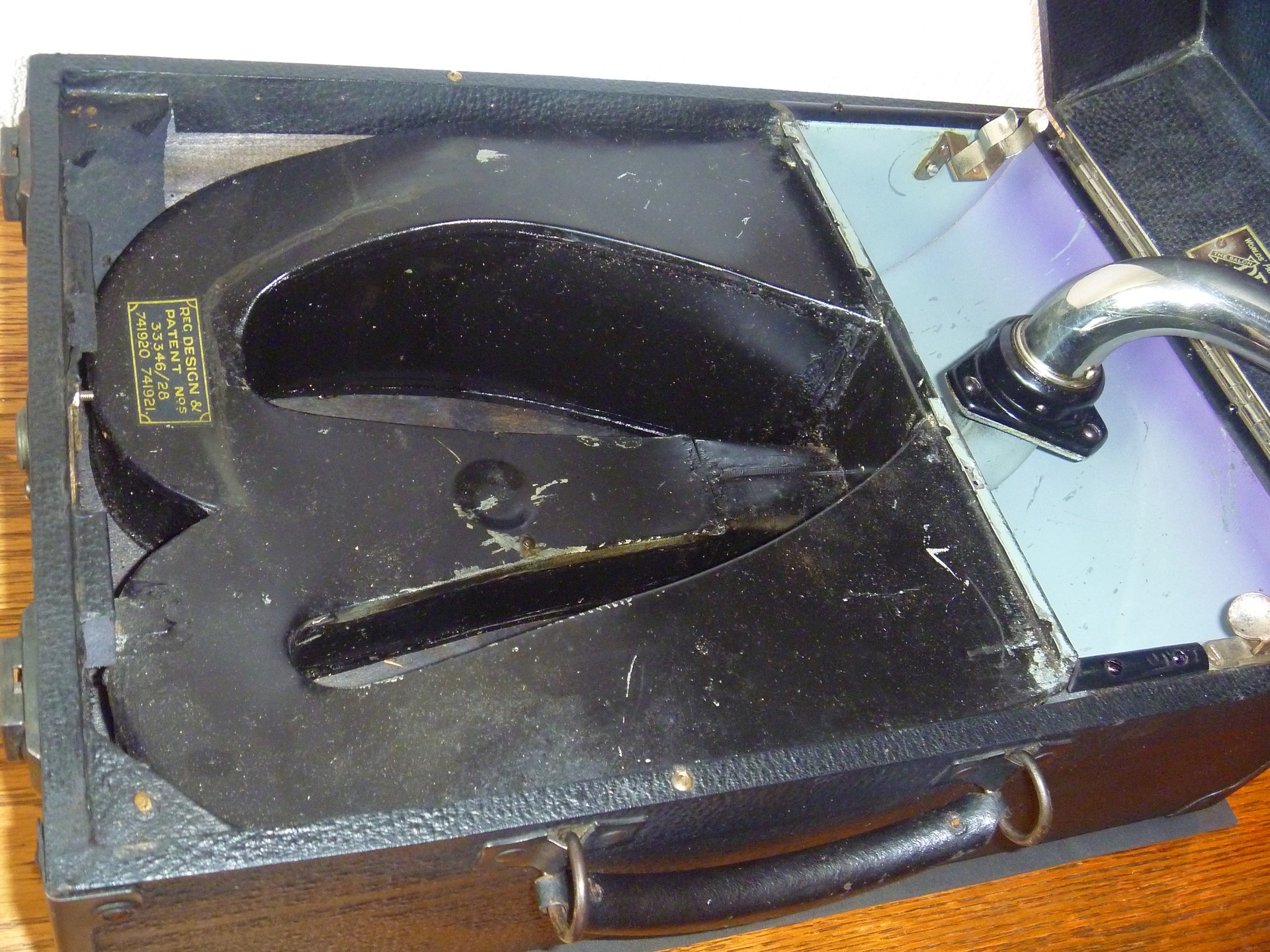

The horn of the Decca is not larger than that of the Columbia 113a or the HMVs and others; the perfection in sound (I guess) comes from the fact that it is a bifurcated horn, split in two symmetric halves reunited at the end flare, which cancels all phase differences etc. The horn of the 101 and 102 and the Columbia 113a are probably a bit longer than that of the Decca, but are asymmetric and so they have phase difference issues. Columbia 202 also has shorter horn, but also bifurcated, split in two halves that reunite in the final flare.

Inigo wrote: Sun Jan 04, 2026 9:58 am The horn of the Decca is not larger than that of the Columbia 113a or the HMVs and others;
[quote=Inigo
epigramophone writes :
Really? Have you measured the cubic capacities of each of these horns? If so, may we see your findings?
