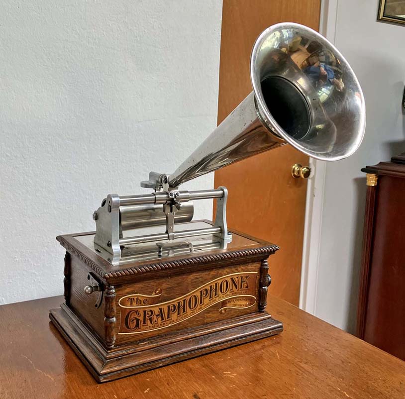

The diminutive Columbia Type AA Graphophone is a lovely and surprisingly scarce little machine, which had a very brief lifespan. It was only cataloged in 1901 and 1902, but they were clearly sold up to at least 1906 given that some have decals on the back of the case announcing awards in Paris in 1900, St. Louis in 1904, or Milan in 1906. Earlier ones have no award decals. There were also two different sizes of front decal used -- a large one covering the whole front of the cabinet for earlier ones, and a smaller, more dimensionally appropriate one for late machines.
There also seems to be a question about reproducers. In Howard Hazelcorn's book he states that these only came with the small 'Eagle' type reproducer, however some are known with the larger D reproducer. These could have been owner upgrades, but there is some evidence that seems to imply some machines were originally marketed with the D. That might apply to later machines, after 1902, but that remains to be determined with further research.
To that end, I have started keeping a census of surviving machines. For those who have an AA in their collection, could you please let me know the following information, either in a reply to this post or by email to [email protected]:
-- serial number (located at left front of the bedplate, all in the 700,000 range)
-- reproducer (D or Eagle)
-- decal size (large or small)
-- last date of award decal on back (if present)
-- type of horn
I will log all the information and see if there are any patterns to be uncovered. I will happily keep owner's information confidential if you want.
Thanks in advance!
