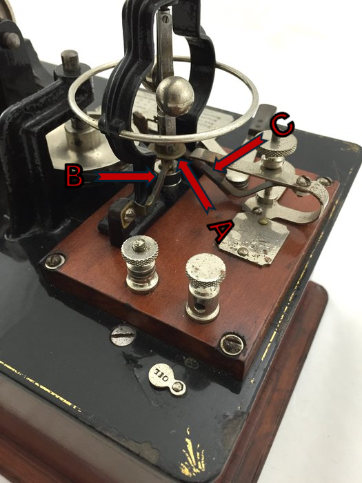

I am sure that you know this, but for the benefit of others, an understanding of how a Class M governor operates may help.
The Class M governor governs the speed of the motor by constantly making, then breaking electrical contact.
As the governor spins, the weights on the governor springs splay out, pulling up the bottom plate (A in the picture). At some point, the governor spins fast enough to separate the bottom plate from an electrical contact (C in the picture). This breaks the current previously flowing through the two electrical contacts (B and C in the picture) through the bottom plate (A in the picture). Without current, the motor, and governor slow down. Slowing down the governor brings the bottom plate back down to the electrical contact (C in the picture) reenergizing the motor. The cycle of making then breaking contact happens very fast. However, if everything (Mostly the governor, but also motor, mandrel, pulleys, etc.) isn't cleaned and well lubricated, and the electrical contact brushes don't have every strand of copper aligned together and flat for a crisp contact, it can lengthen the delay between cycles (breaking and then making contact) to the point where it becomes noticeable.
Hope that helps.
Your video is private, so not available for people on the forum to see.
Hope that helps.
