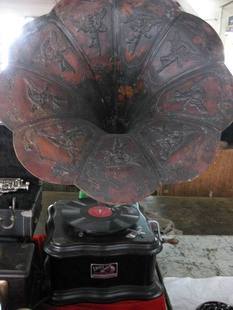

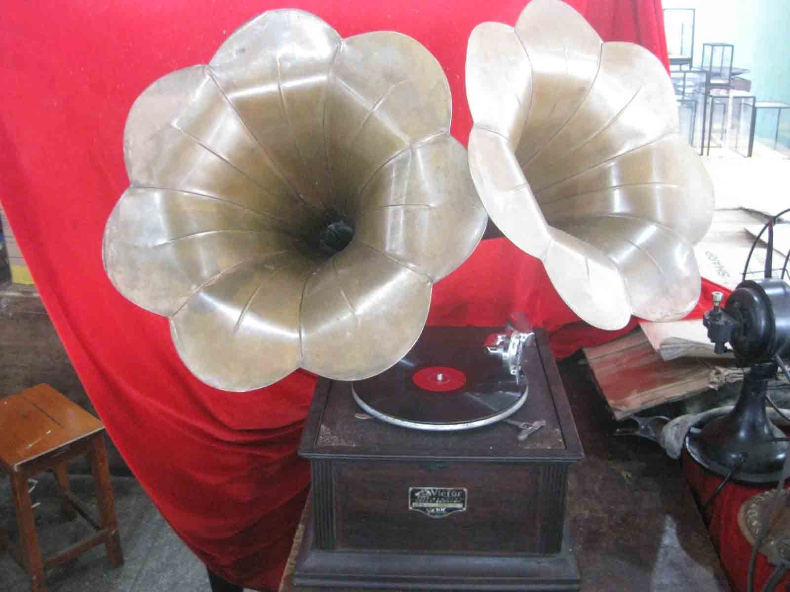

I am going to buy a victor gramophone,
but I am a new player for gramophone...
So,can anyone help me to identify these gramophones
which is fake ,which is real?
1.
http://img02.taobaocdn.com/bao/uploaded ... 100125.jpg
2.
http://img04.taobaocdn.com/bao/uploaded ... 045833.jpg
3.
http://img02.taobaocdn.com/bao/uploaded ... 065937.jpg
The photos is just copied from the auction site... :P
Regards!
Martin
Starkton
Posts: 1135
Re: Is these fake victor?
Post by Starkton »
All fakes, probably Indian.

I agree, they are fakes. You may want to contact someone using the "links" section of the forum for more guidance.

All fake- stay far away from them

Hi Martin:
As noted, they are all fake Victor machines. Some were made out of parts taken from real gramophones--but none of them were made by Victor.

Yes, they're all fakes. They'll play records, but nicer machines can be obtained easily.
