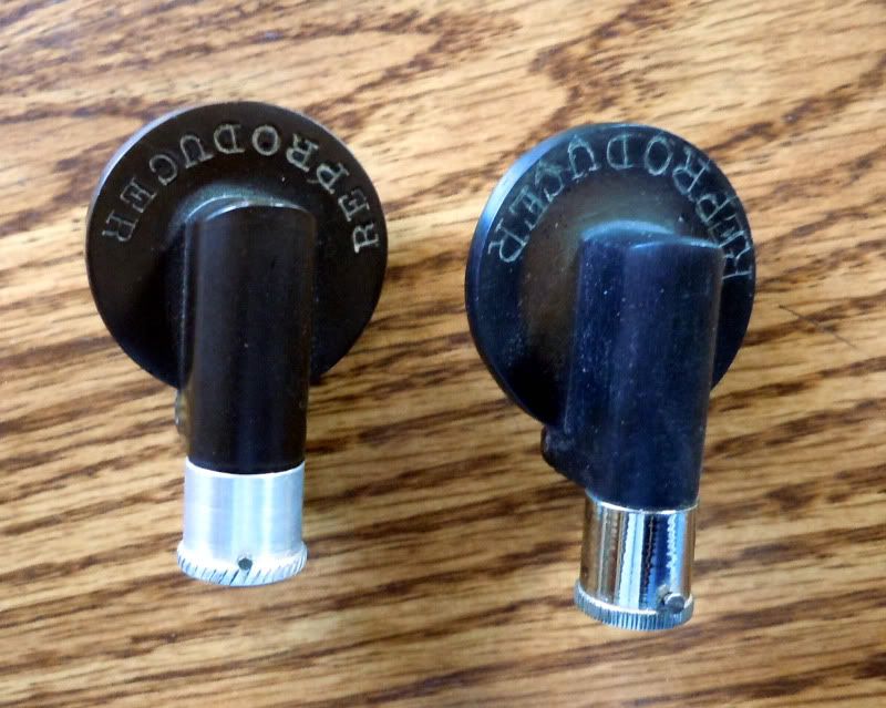

As for the reproducer, the ones being reproduced either have no "REPRODUCER" lettering or the lettering is crudely executed, or it's upside-down. An original gutta-percha reproducer's lettering should be configured so that it's readable hanging downwards, rather than in the later, more typical position. You can also tell by the stylus bar and other metal parts.

- TinfoilPhono
- Posts: 2026
Re: Graphophone Type "A" Washington DC
While most replica gutta percha reproducers have the word facing the wrong direction, some are correctly oriented. Here's an original (on the left) with a replica (on the right). Note that the REPRODUCER is in larger letters on the replica. The material is also so thin that it's very nearly translucent when there's light behind it. From the back side you can see the original has a retaining ring for the diaphragm with two indentations to allow it to unscrew to replace gaskets. On this replica the diaphragm ring is sealed.
