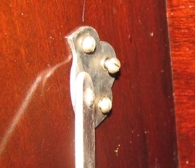

The other lid issue . . . does anyone have a photo or description of what is used to attach the prop bar to the lid? I have it jury rigged right now, and would love to get a permanent fix in place. I have the prop bar, I have the bit of hardware that's attached to the lid--I'm missing what hitches them together.

Usually what attaches the lit prop to the plate on the lid is a rivet, made loose enough that the piece cab move. Until you can get it fixed try using a very short nut and bolt.

I have it attached with exactly that right now--a short bolt and nut, with a plastic washer between the prop bar and the lid hardware. Not suite sure how to manage a rivet on this thing, or what would make a good stand-in for such that wouldn't work itself loose. The hinge situation is now being worked out, though, thanks to a family member who is handy with such things.

Yep, It's a rivet.

Here's a shot of the bucktail.
