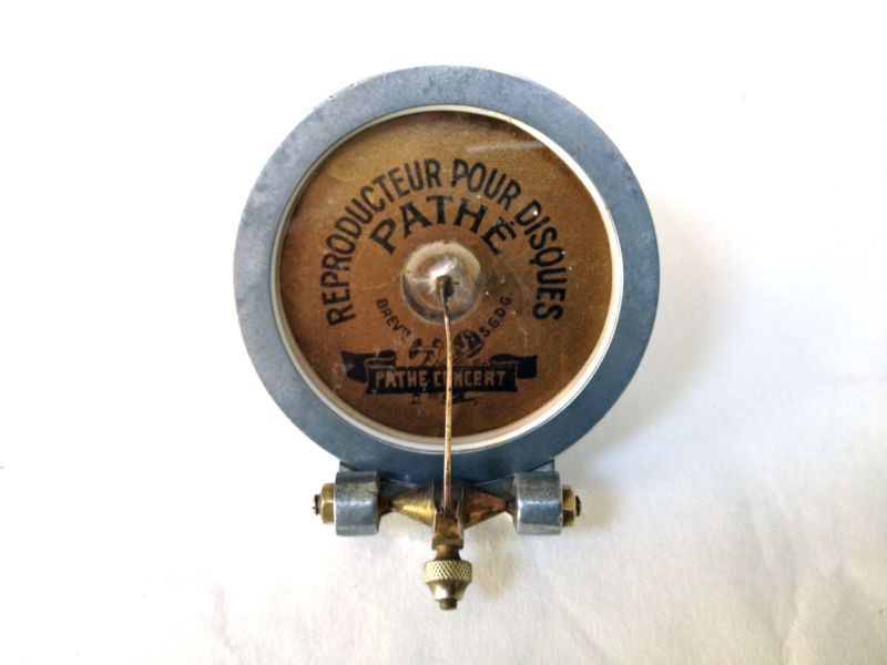

That is a fairly scarce early American Pathé, with a mechanism built by Columbia, as the patent situation was still dicey for independent firms. These machines came fitted with a large aluminum French Pathé reproducer,and a lateral attachment which consisted of a Columbia No. 6 reproducer with an aluminum diaphragm, which effectively covered up the Columbia logo. The same reproducer was used on some Royal, Standard, United, American Women's League and Consolodated machines of 1914-1915 vintage.

if that machine is complete, and especially if it's running (but even if it has a broken spring), you should buy it at that price. that's an early, uncommon model, and it's oak. but I wouldn't expect it to include the saphire stylus or a lateral adapter (the former is an easy find, the latter not as easy but by no means a challenge) - if it did, that price would be even more of a steal.

That Pathé looks great on the outside. It if looks as clean on the inside and is reasonably complete with motor and reproducer, then a baseline cost of $130 is a steal. Even if you have to replace a mainspring, reproducer or stylus ($40-$70 on eBay), you are still doing okay.
