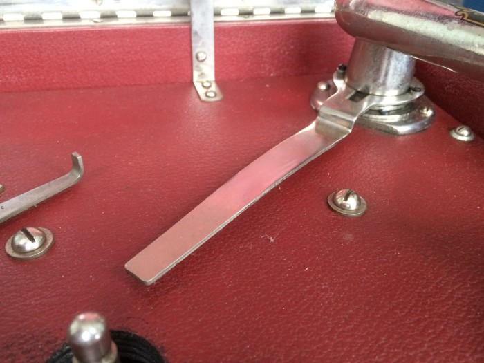

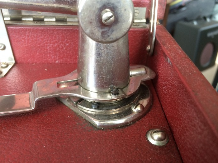

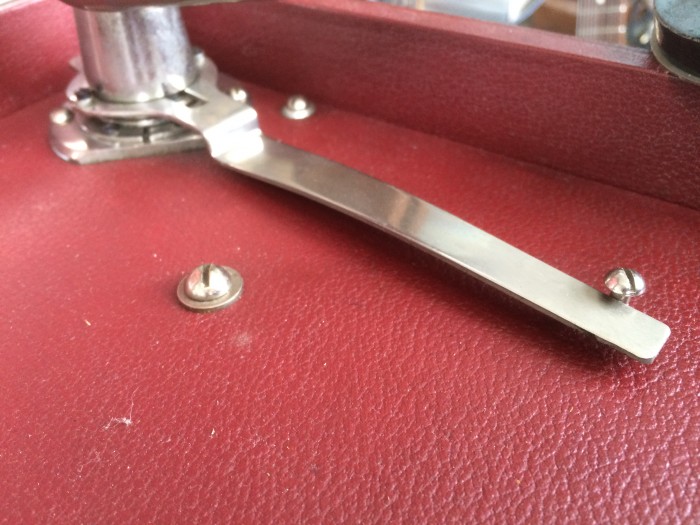

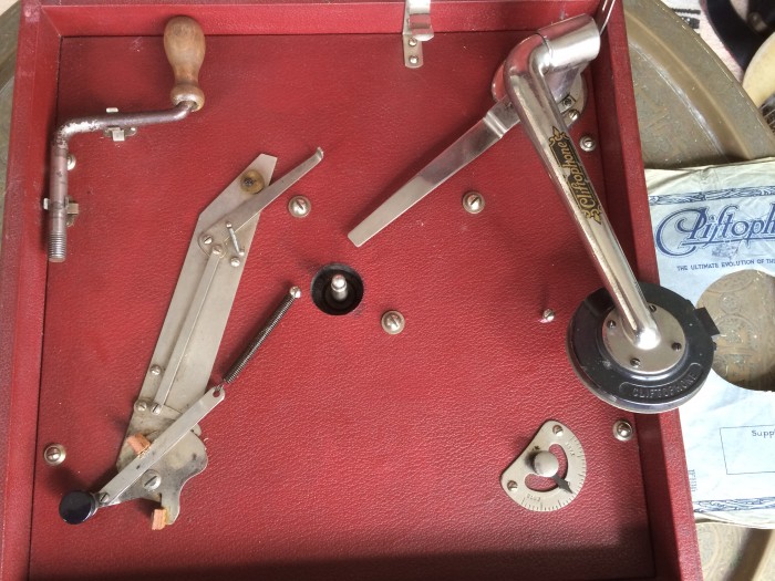

Coincidentally a friend bought one of these just days ago and asked me the same question! Hers is missing the lever and friction assembly attached to the tonearm base, hence more photos of that. Let me know if you need any more Steve.

Thanks, Andy, that's much appreciated! Okay, so it appears nothing is missing but simply a bit "adrift". I was also thrown by that solitary screw in the motoboard which didn't appear to do much. Now I know it's the limit of travel for that lever.
