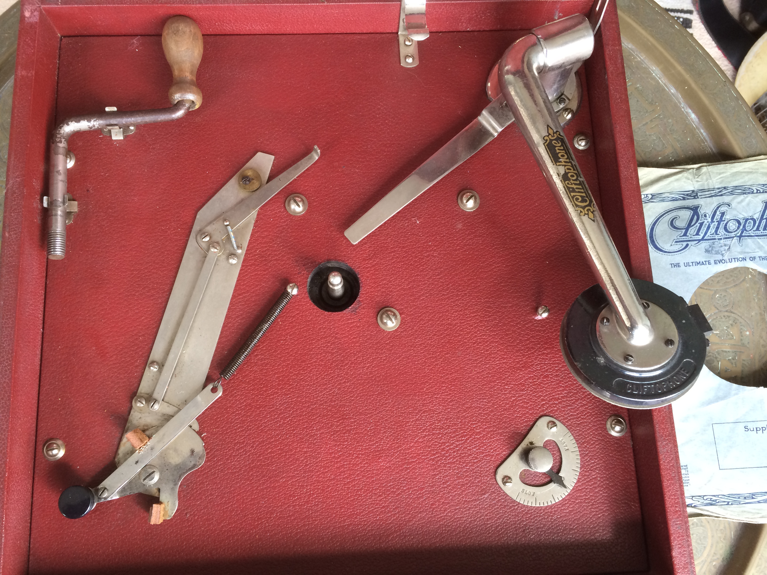

Could someone with a Cliftophone portable with autobrake please show me a photo of the motorboard layout with turntable removed?
I have recently acquired one of these machines but I think a part might be missing and I would like to identify it if possible.
Many thanks!

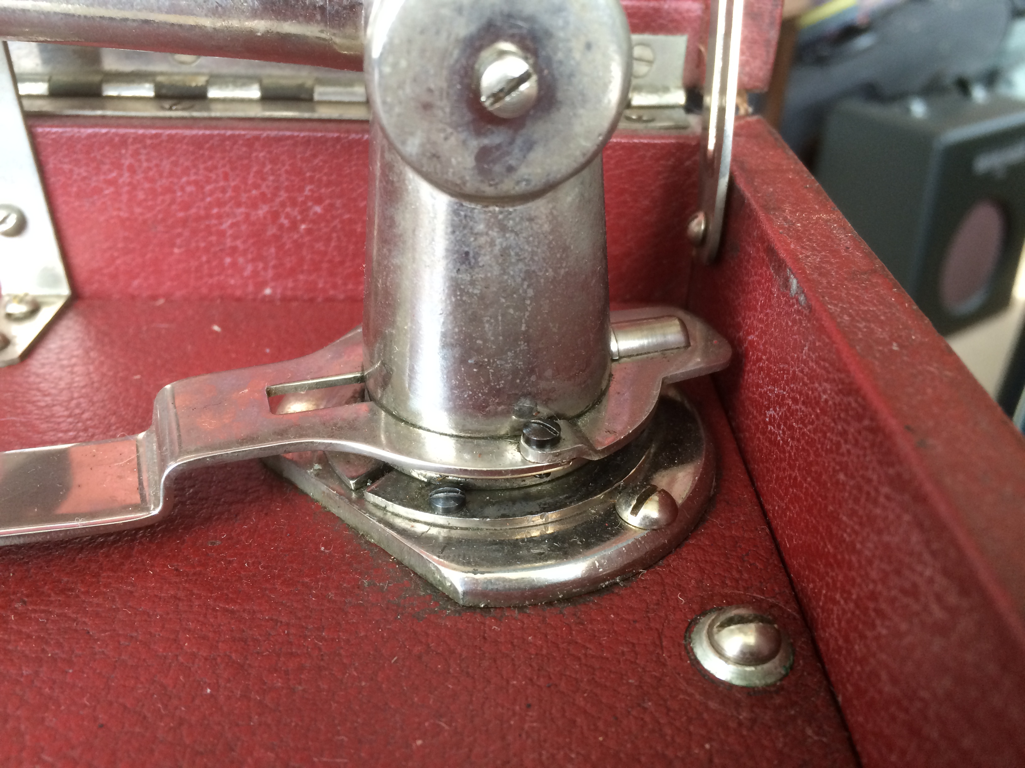

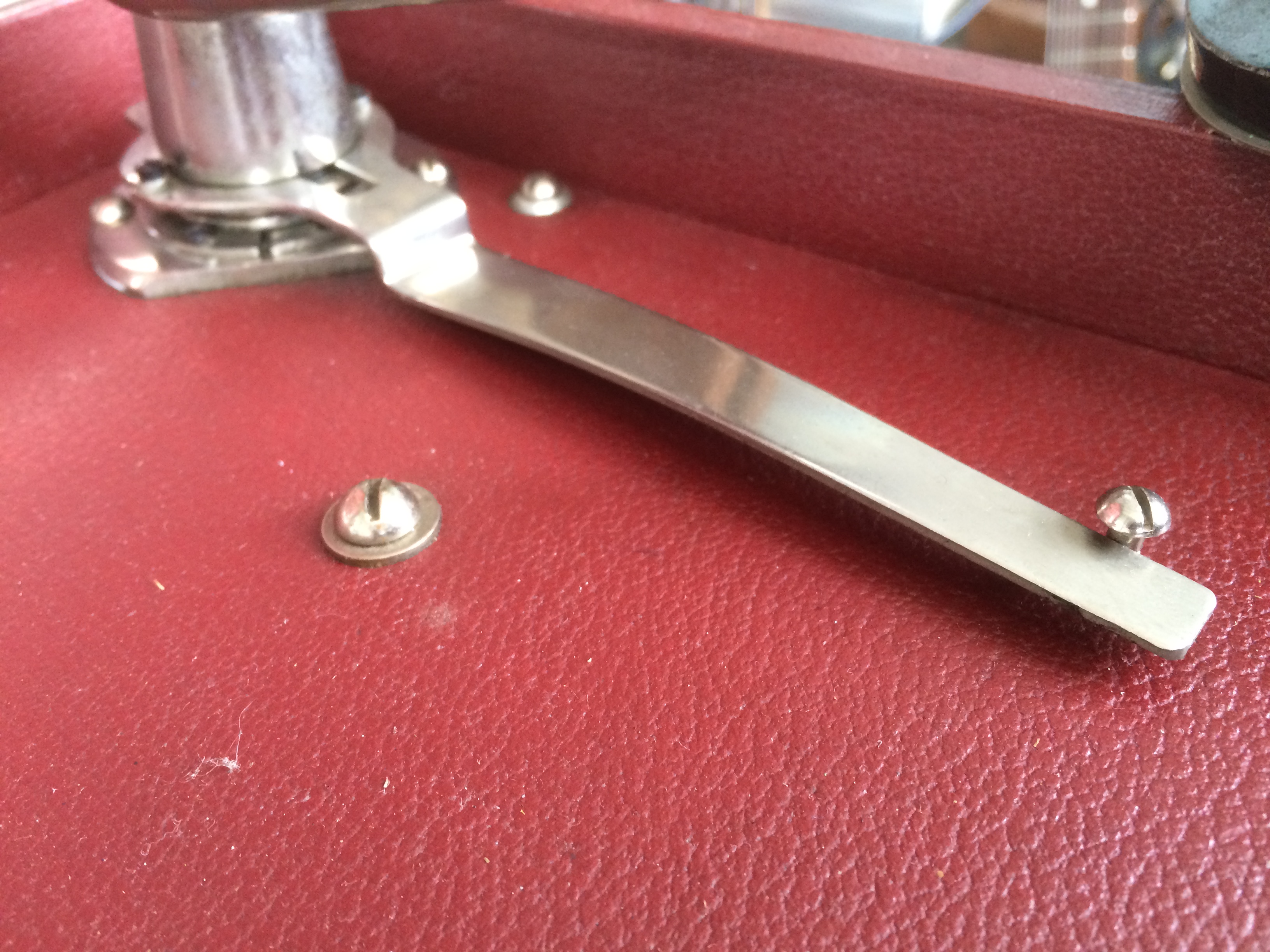

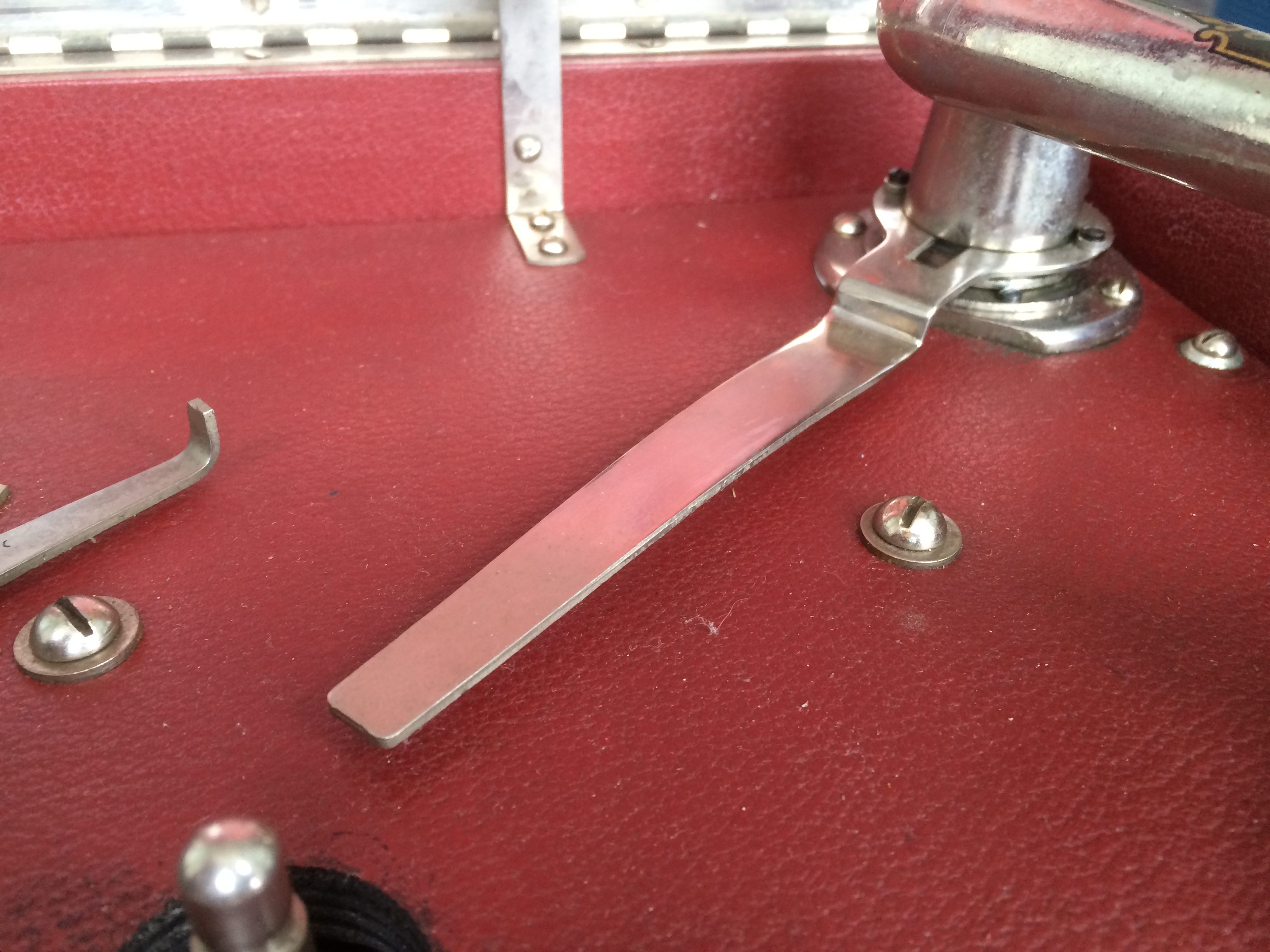

Coincidentally a friend bought one of these just days ago and asked me the same question! Hers is missing the lever and friction assembly attached to the tonearm base, hence more photos of that. Let me know if you need any more Steve.
Posts: 3788
Re: Cliftophone portable autobrake
Post by Steve »
Thanks, Andy, that's much appreciated! Okay, so it appears nothing is missing but simply a bit "adrift". I was also thrown by that solitary screw in the motoboard which didn't appear to do much. Now I know it's the limit of travel for that lever.
Thank you for your help!
