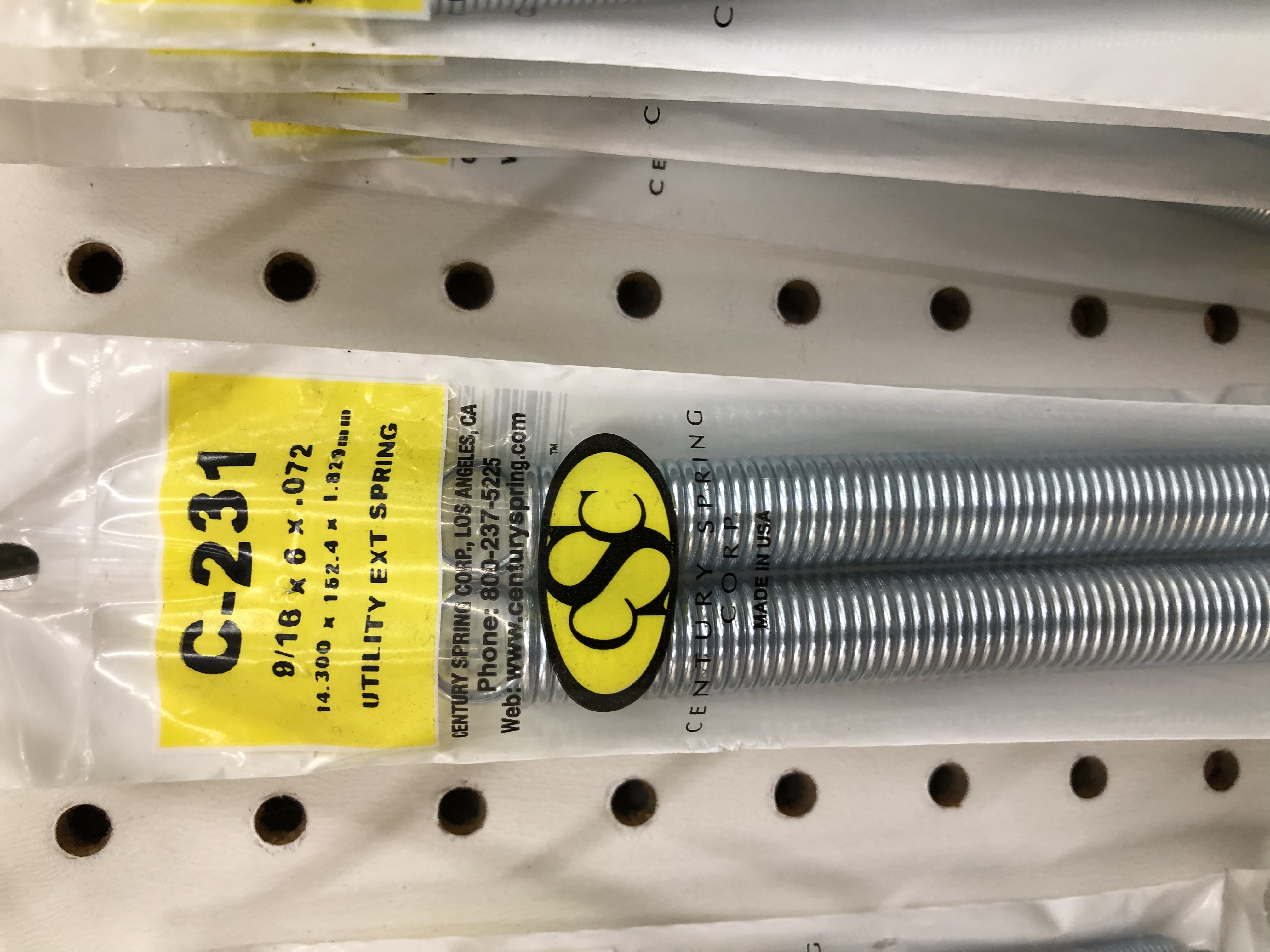

Edisonic lid tension spring- is replacing possible

I don’t know if I could swap this for what’s in there and have it be successful

how do you go about adusting the tension? what exactly do you turn? thanks
Posts: 6823
Re: Edisonic lid tension spring- is replacing possible
Loosen the top nut and tighten the lower nut. This will cause the eye hook to pull harder on the spring.
Your earlier photo showed the eye hook adjusted to give more tension.
