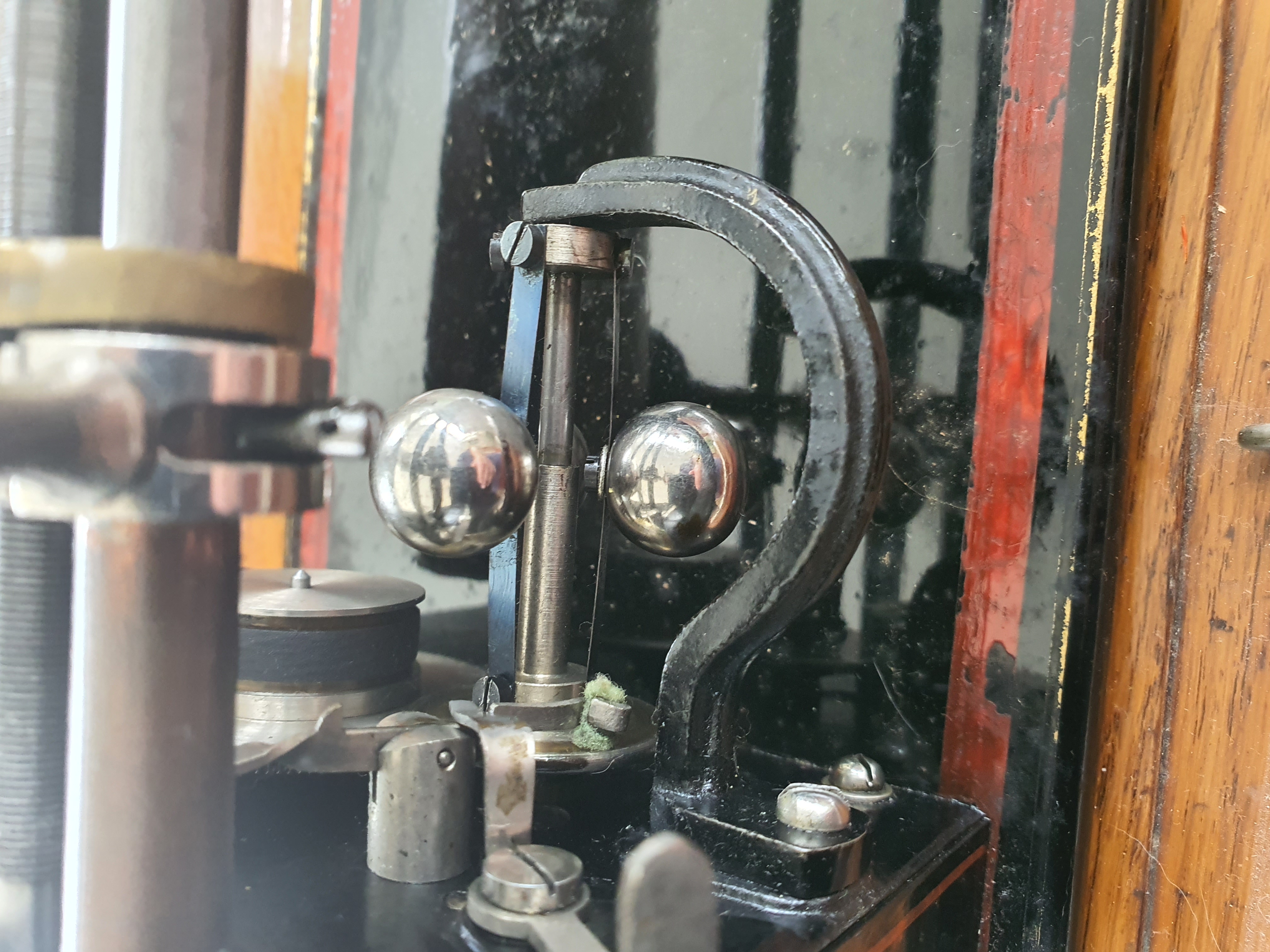

I just got this little project and unfortunately, the governor weights and springs are missing. I tried a Columbia Q governor spring and it is a bit too short, although I may try it anyway when I get a few more minutes. I'd like to know the diameter of the governor weight if someone has one to measure.
I'd also appreciate a photo of the underside of the reproducer. I'll need to make a stylus holder and would like it to look as close to original as possible.

I have one of the same brand, not sure if the same model as yours - the decoration on the metal top is different, but otherwise looks the same. The governor weight diameter is 1.62 cm, see photos below. I also took a photo of the reproducer and the horn. Mine is an original horn, not aluminum, but painted tin. Aluminum horns are more utilized in the French Pathé machines, most German machines had tin horns. Hope it helps.

Carlos! Thanks so much for the great photos! It looks like your weights are nickel plated. I was going to use weights and governor springs from a Columbia Q, but they are smaller than yours. I can order some brass balls almost exactly the same size as your machine has and then drill and tap them. I found that the 3/16" Victor governor spring is a nice match for this both in width and thickness. I'll nickel plate my new weights and they will look like yours.
Thanks again for your help!

You're welcome , Dave! Yes, the weights are plated (they are the original ones), and your plan to get brass balls and plate them sounds very promising. Good luck with your undertaking and don't forget to post the results!Dave D wrote: Thu Jul 01, 2021 11:09 am Carlos! Thanks so much for the great photos! It looks like your weights are nickel plated. I was going to use weights and governor springs from a Columbia Q, but they are smaller than yours. I can order some brass balls almost exactly the same size as your machine has and then drill and tap them. I found that the 3/16" Victor governor spring is a nice match for this both in width and thickness. I'll nickel plate my new weights and they will look like yours.
Dave D
