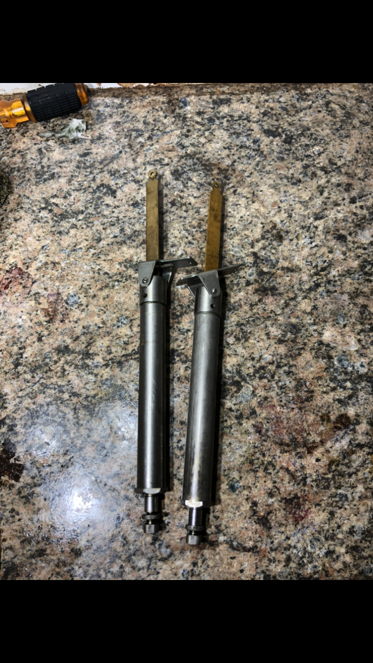

I got the lid hinges working… it wasn’t hard to get them apart, cleaned, and put back together.
The motor however is being difficult with me
Also here’s some pics of the machine after I cleaned it up.
Cheers
David
