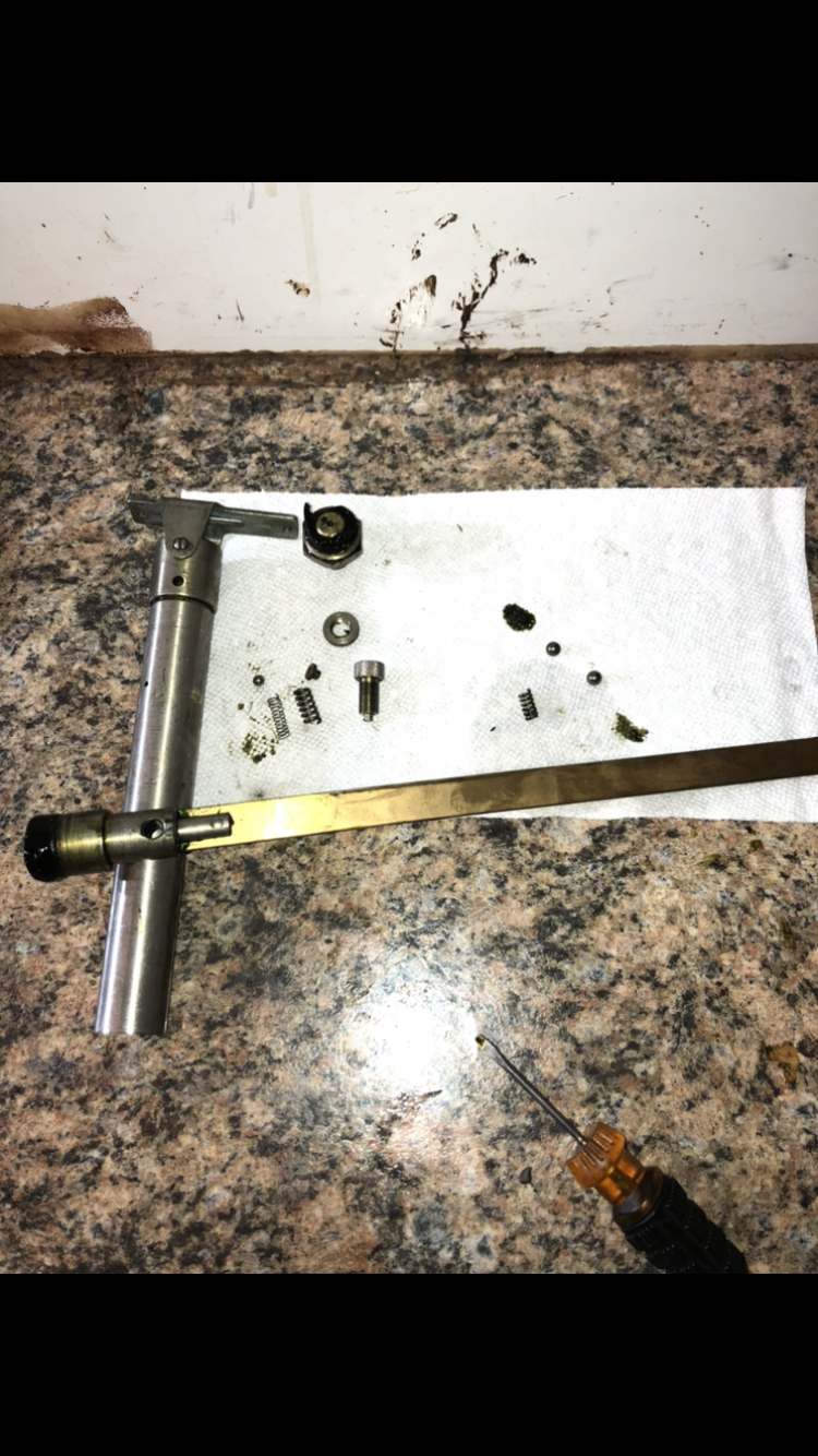

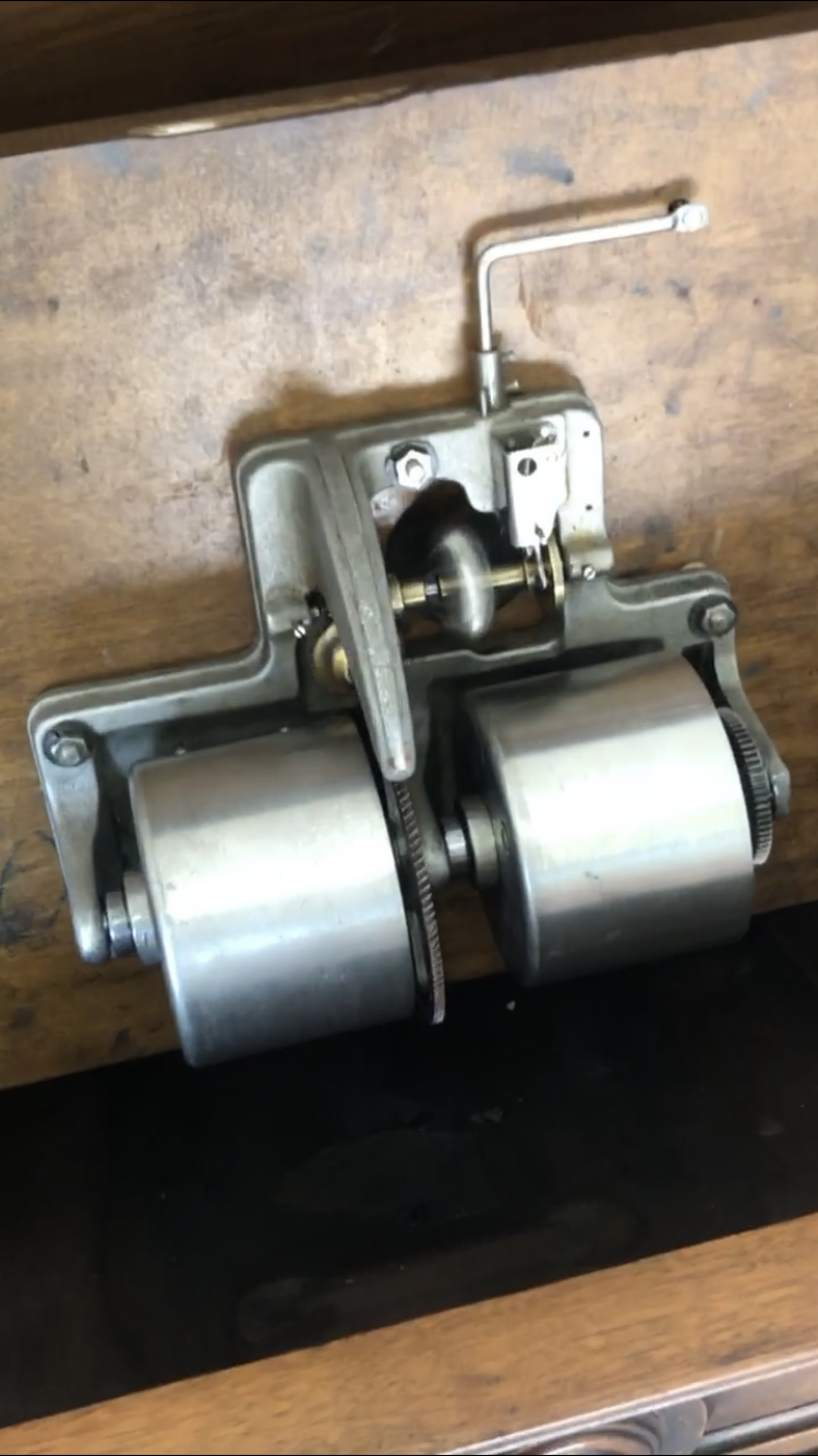

Update:
I got the lid hinges working… it wasn’t hard to get them apart, cleaned, and put back together.
The motor however is being difficult with me :? I think I may have lost a ball bearing. Does the govenor shaft ride on a ball bearing in each bearing? If so then I need to get a new set. In the past, the Victrola motors I’ve done have started spinning within 3 cranks when I put it together; this one didn’t. Last night it would be randomly slowing down and speeding up while I was playing a record… tonight it’s not doing it :roll: The thing that’s been that most bothersome is that it doesn’t start spinning when the turntable brake is taken off. The platter just remained stationary. If anyone has any advice on how to make it work as it should I would really appreciate it.
Also here’s some pics of the machine after I cleaned it up.
Cheers
David

Inside each brass bearing of the governor there must be a tiny steel ball bearing,at the bottom.

David,
You do need a ball bearing, at least in the governor bearing that bears the thrust. However, I believe both end bearings will have a ball in them. Not saying it's impossible, but I've never had one fall out. Your problem seems more like issues I've had in the past with a worn-out spindle shaft worm and a worn out drive gear, (the big one on the spring barrel). Look very closely at the spindle worm gear area, especially where it meshes with the drive gear. Look for surface roughness and worn contours, especially when compared to the unworn areas above and below the part of the worm that gets the most use.

David,
Alrighty I will take a look at it. The motor ran quite nicely before I took it apart.. it was just REALLY thumpy. When I took it apart the second time and checked the govenor bearings, the right bearing did not have a ball bearing inside. I had a smaller ball bearing on hand that seemed to help...
I can take a look at it a little later this week and I will report back ;)
David
Posts: 4572
Re: My new addition: the credenza
It could be the adjustment. At least one of the bearings (I believe the thrust one) has a groove on it for the set screw to go in a fixed position. The opposite one may have no groove, so you may adjust it to have a tiny gap, just moving the axis back and forth and feel there is a small play and no more. This one is the one that may not need a ball bearing. If you installed one, and there was no ball before, just remove it, extract the ball (aha... this is the difficult part) and reinstall as it was before, with that little end play.

Watch the gears and meshing, as jerryvan says. That could be the problem. Or that you reinstalled the governor slightly different as it was before and when running well...
Nevertheless, as time goes by I'm more on the opinion that if it works, don't touch it. I've disassembled and cleaned thoroughly all my motors except one. Invariably, after cleaning and regreasing and all that, all then became noisier than before. The one I never touched, except adding some oil, still works silently... Lesson learned. :?
Seriously, I've come to believe that the old dry grease on the gears helps filling gaps and worn things. When you remove that old grease, the gears become nude, showing all their war wounds, and become noisier. Just as happens with old cars transmission gears. Slick car sellers used to add some sawdust to the greasing to hide those noises of worn out gearing...
