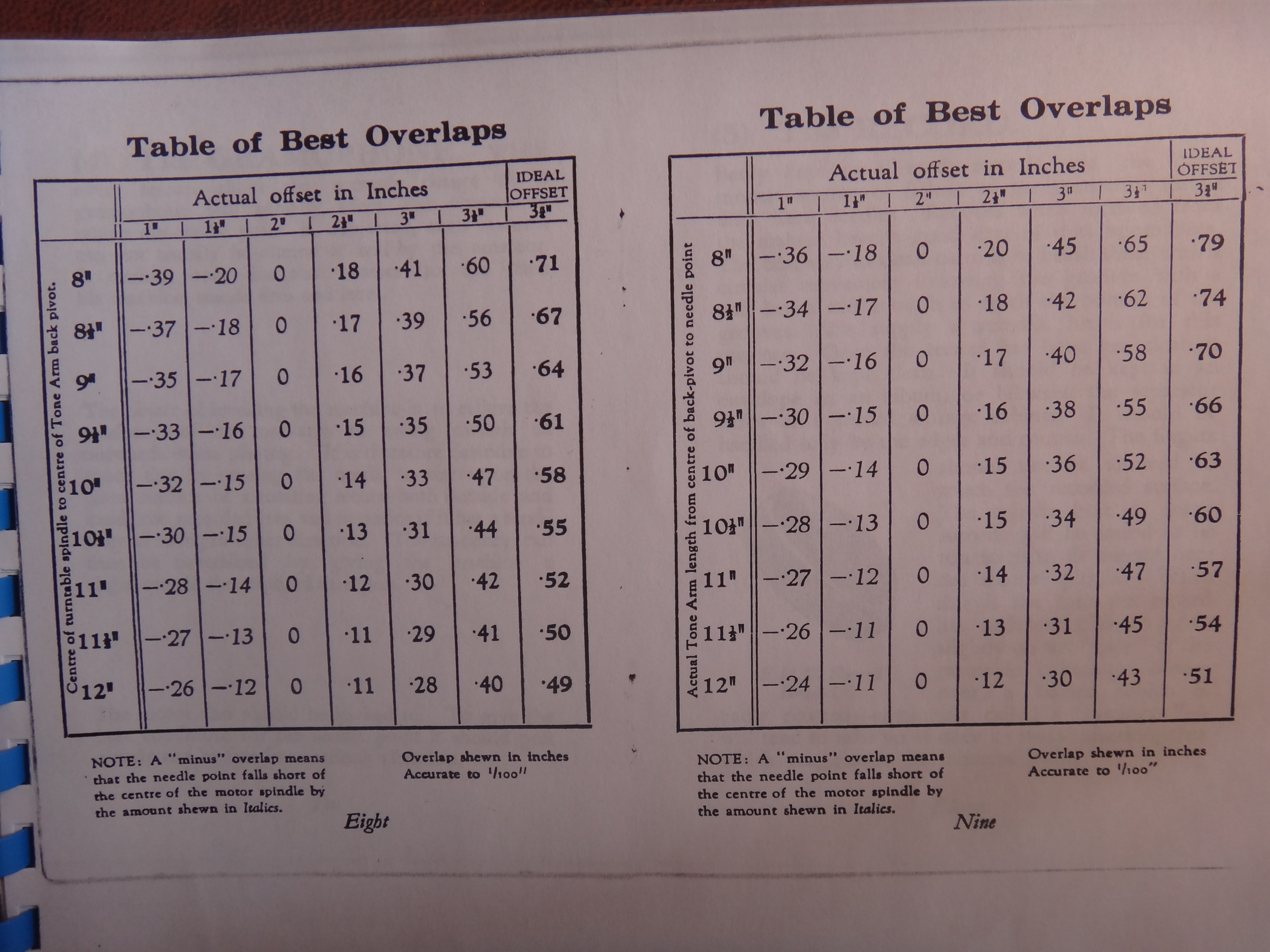

I do not have an HMV 130 but do possess a Model 150 which may be similar for the purposes of this discussion ? There seems to be little difference between the 5A and 5B soundboxes, both of which produce a positive overlap just shy of ¼" with ½" needle projection. This overlap is reduced to practically zero with a needle projection of ⅜". The distance between tonearm bearing centre and motor spindle centre is about 9" and offset is approximately 1.0". Reference to the attached tables will show that the recommended overlap should, in fact, be negative in this instance at minus 0.35" ie an "underlap" or, put another way, the needle point should fall short of the spindle centre by about a third of an inch. Hopefully you will be able to assess your geometry by reference to the tables in the same way. The needle point should lie on the disc for these purposes to obtain accurate values.
Extract from EMG instruction booklet.

Thank you, Oedipus and emgcr!
It did strike me that my needles were projecting unusually far from the holder on the sound-box. It may be that something – perhaps the stump of a broken wood or fibre needle – is wedged in the bottom of the triangular-section tube. I have got another good 5B somewhere; if I can find this I shall use it to check the exposed length of needle, and if there is indeed an obstruction in the present box and I cannot clear this, I can fit the other one instead. Meanwhile I shall study the brake mechanism further. It certainly does not look as if anything is corroded or seized. I did have a vague sense that there was something odd about the lid-stay.
