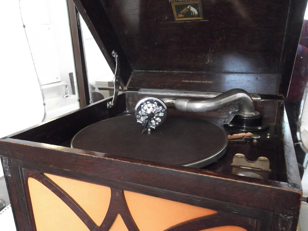

The main problem is with the automatic brake. One point is that the pad, when applied, only just brushes against the turntable; I presume this is simply because it is too worn to make proper contact. The other is that, while the mechanism springs into the 'on' position when the tone-arm is swung inboard, it does not disengage when the movement is reversed. I have not yet found an answer to this, and so as a short-term solution I have disconnected the brake assembly from the tone-arm and am relying on a wooden wedge (half a clothes-peg, to be exact) to stop the revolutions.

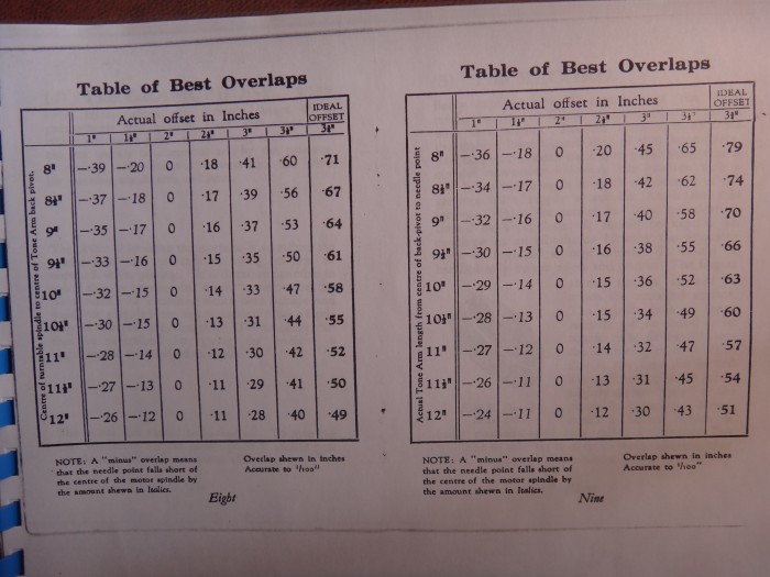

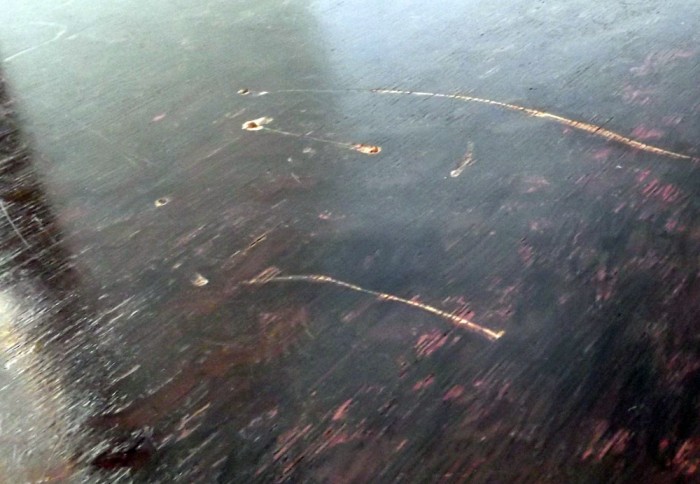

One thing that surprises me is that the tracking position overshoots the radius-line of the turntable by about a centimetre, as shown in the third image. Is this as it should be? Could the change from the original 5A box have led to this anomaly? The angle of the sound-box seems to be correct. (I am not interested in reverting to a 5A box as I understand that this unit tends to have a rather fierce and 'bright' tone, and that is something I do not care for at all.) As I say the gramophone plays very well, but I am concerned that if this arrangement is not correct it may throw an excessive strain on the outer wall of the record grooves.

I wouldn't worry about the tracking; this does vary on the 5A soundbox models, and this is an early 130 (shown by the large base flange of the tone-arm). The 5B sound box will have made no difference.
I can't quite follow what you say about the brake (except that yes, wear on the pad will affect it, but can often be cured by simply working the pad further forward in the tab which holds it.) In operation, swinging the tone-arm outboard (i.e to the start of the record) will release the brake, and it is applied at the end of the record by the reverse action of an eccentric run-out groove, found on HMV records from about 1925 onwards (but not on your 1921 Columbia!). If this is not happening, the trigger attached to the operating arm is presumably not responding, either because some well-meaning idiot has put oil on the brake mechanism in the past, or because the friction joint on which the operating arm pivots is not tight enough. That can be adjusted by slightly bending down the three 'legs' on 'Isle-o'-Man' washer at the top of the joint. (To apply the brake on a record without an eccentric runout, simply lift the tone-arm and swing it slightly to the right.)
One other, small point; the lid stay has been installed upside down; the convex side of the arms should be facing forwards.

I do not have an HMV 130 but do possess a Model 150 which may be similar for the purposes of this discussion ? There seems to be little difference between the 5A and 5B soundboxes, both of which produce a positive overlap just shy of ¼" with ½" needle projection. This overlap is reduced to practically zero with a needle projection of ⅜". The distance between tonearm bearing centre and motor spindle centre is about 9" and offset is approximately 1.0". Reference to the attached tables will show that the recommended overlap should, in fact, be negative in this instance at minus 0.35" ie an "underlap" or, put another way, the needle point should fall short of the spindle centre by about a third of an inch. Hopefully you will be able to assess your geometry by reference to the tables in the same way. The needle point should lie on the disc for these purposes to obtain accurate values.

It did strike me that my needles were projecting unusually far from the holder on the sound-box. It may be that something – perhaps the stump of a broken wood or fibre needle – is wedged in the bottom of the triangular-section tube. I have got another good 5B somewhere; if I can find this I shall use it to check the exposed length of needle, and if there is indeed an obstruction in the present box and I cannot clear this, I can fit the other one instead. Meanwhile I shall study the brake mechanism further. It certainly does not look as if anything is corroded or seized. I did have a vague sense that there was something odd about the lid-stay.

The brake mechanism seems to have rectified itself. I cannot claim any credit for this, but I have managed to reposition the brake-pad so that this also functions, if rather weakly.
There is in fact no obstruction in the needle-tube of the sound-box, since my second 5B shows exactly the same length of needle. I could perhaps use a Meltrope III instead, this being smaller in diameter and having a deeper needle-tube; however I am in two minds about this, since the Meltrope works particularly well on another machine of mine.
