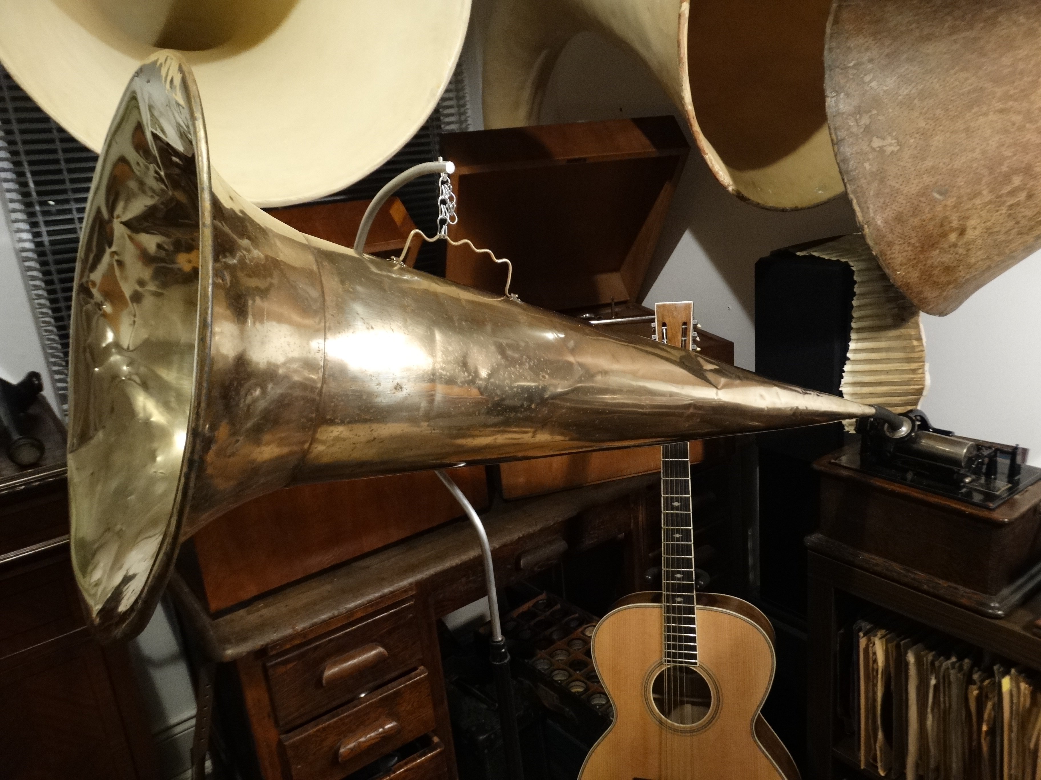

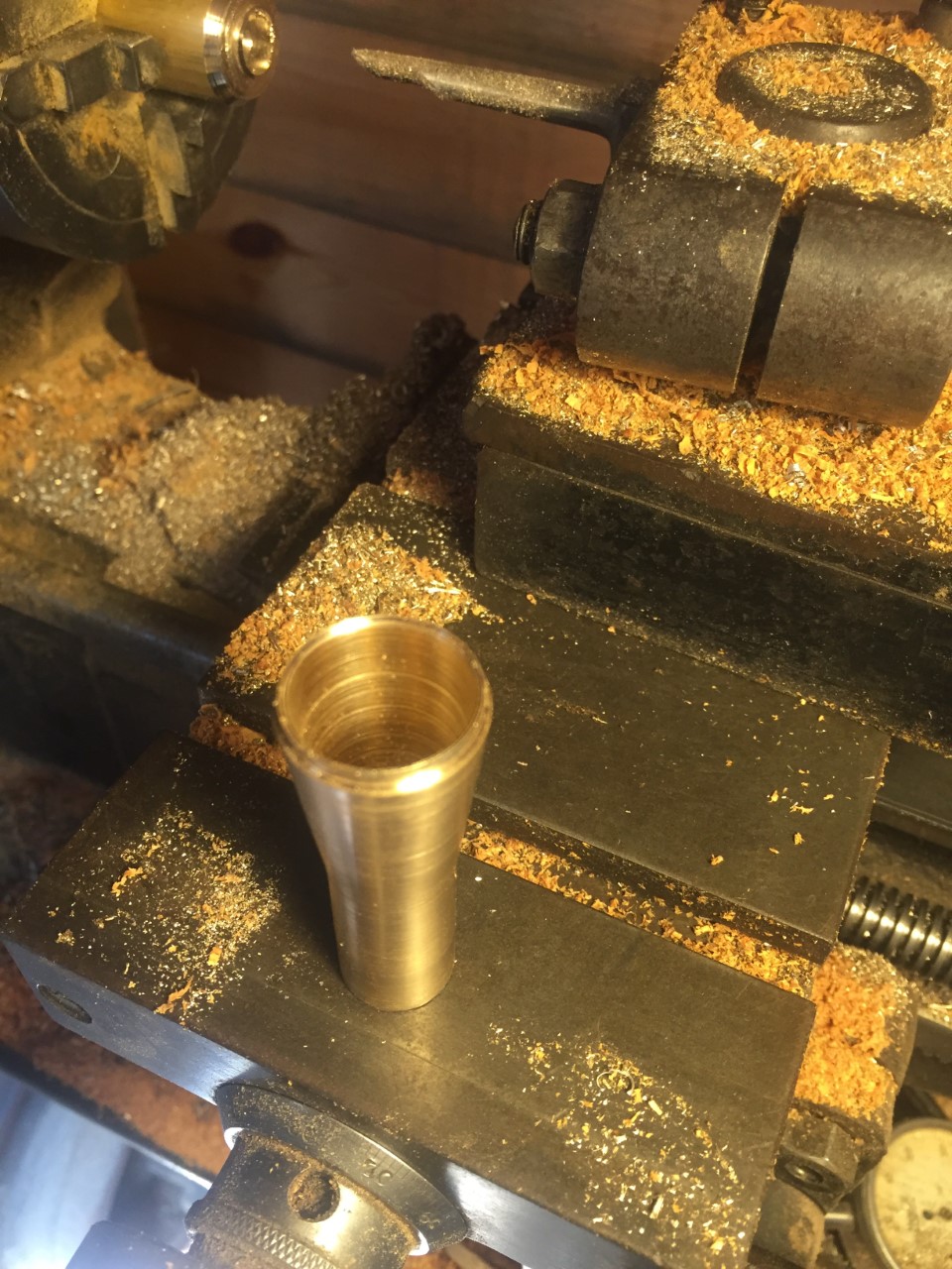

Well today I got the horn done for now, I had to buff out some deep green corrosion in the horn, so to avoid the horn looking patchy, I decided to buff out the whole horn, but I have left it as bare brass, so I'm going to let it dull down again before adding a clear coat.
I made a new tapered end and soldered it in place, and a new hanger, i'm pretty happy with it, it looks a little strange being polished but retaining all the dents, but that will sort itself out.
Here's a little video I did of the first test, some flutter to sort out, likely an issue with the old belt and it seems a little stiff in places, but not bad for a first test I think.
