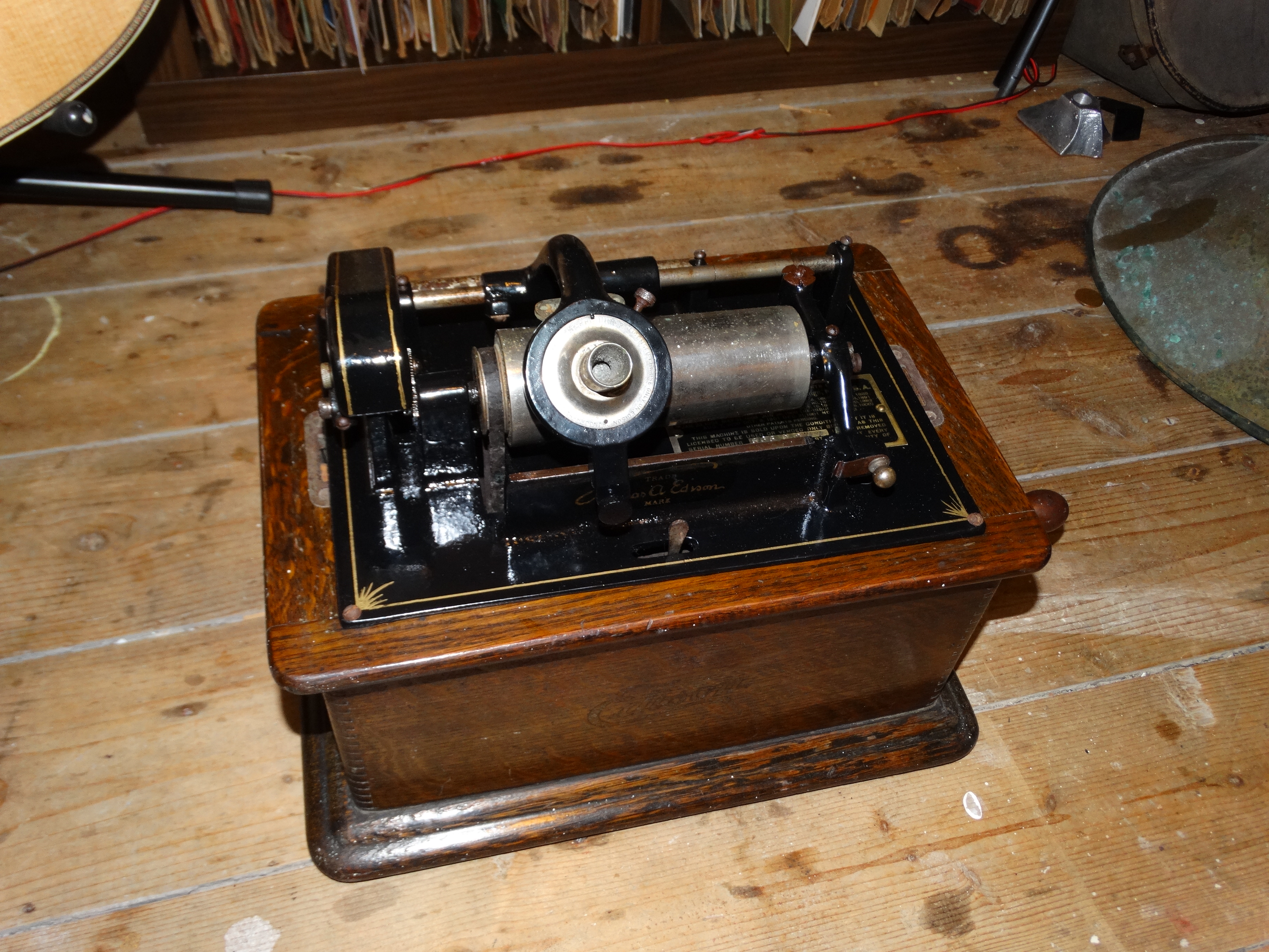

Last night I got the machine itself done (beside the broken stylus which is still needed), its all running smoothly too, the brass stock to fix the horn is on its way.

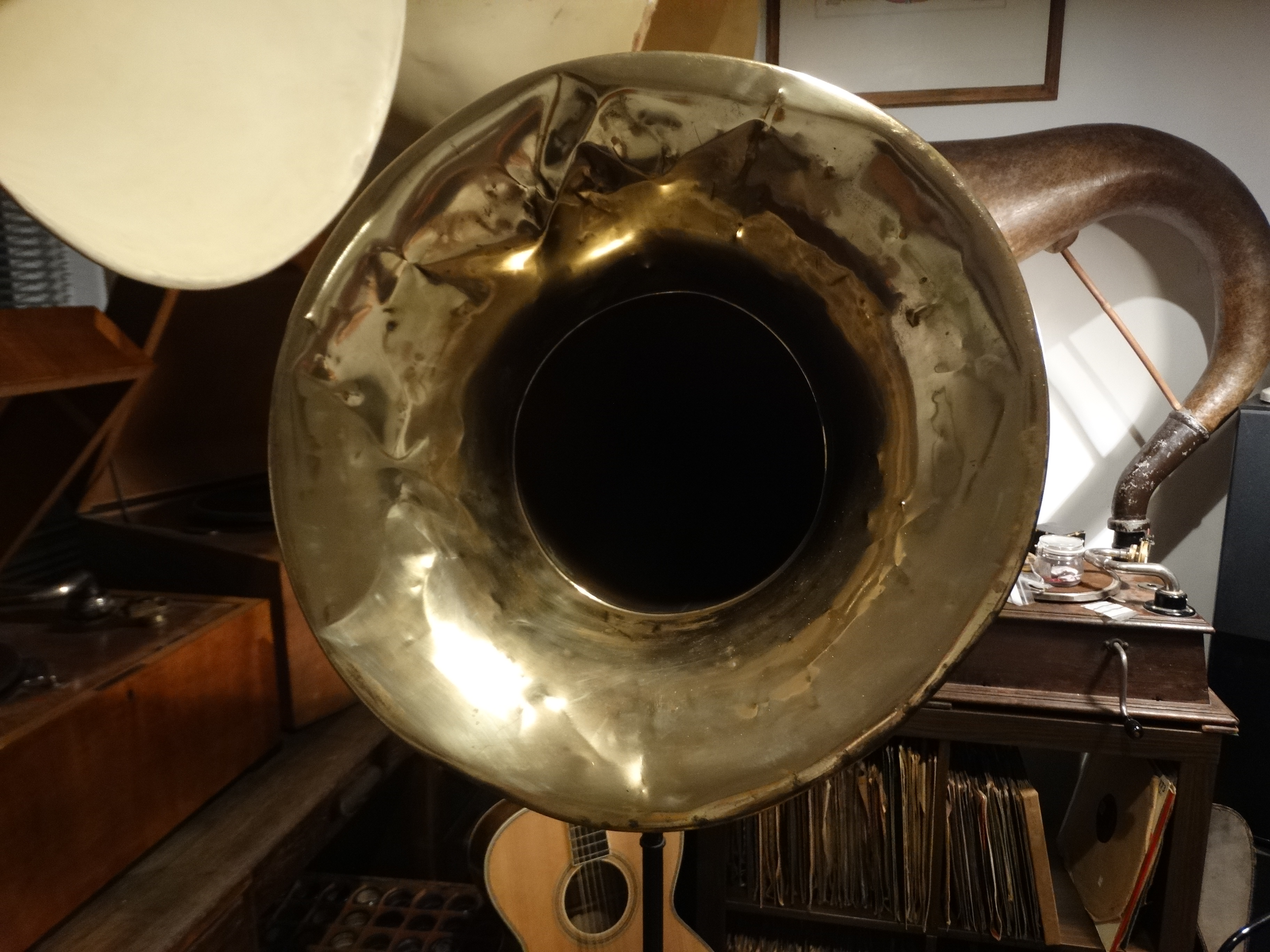

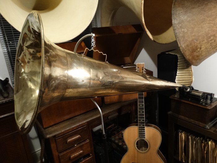

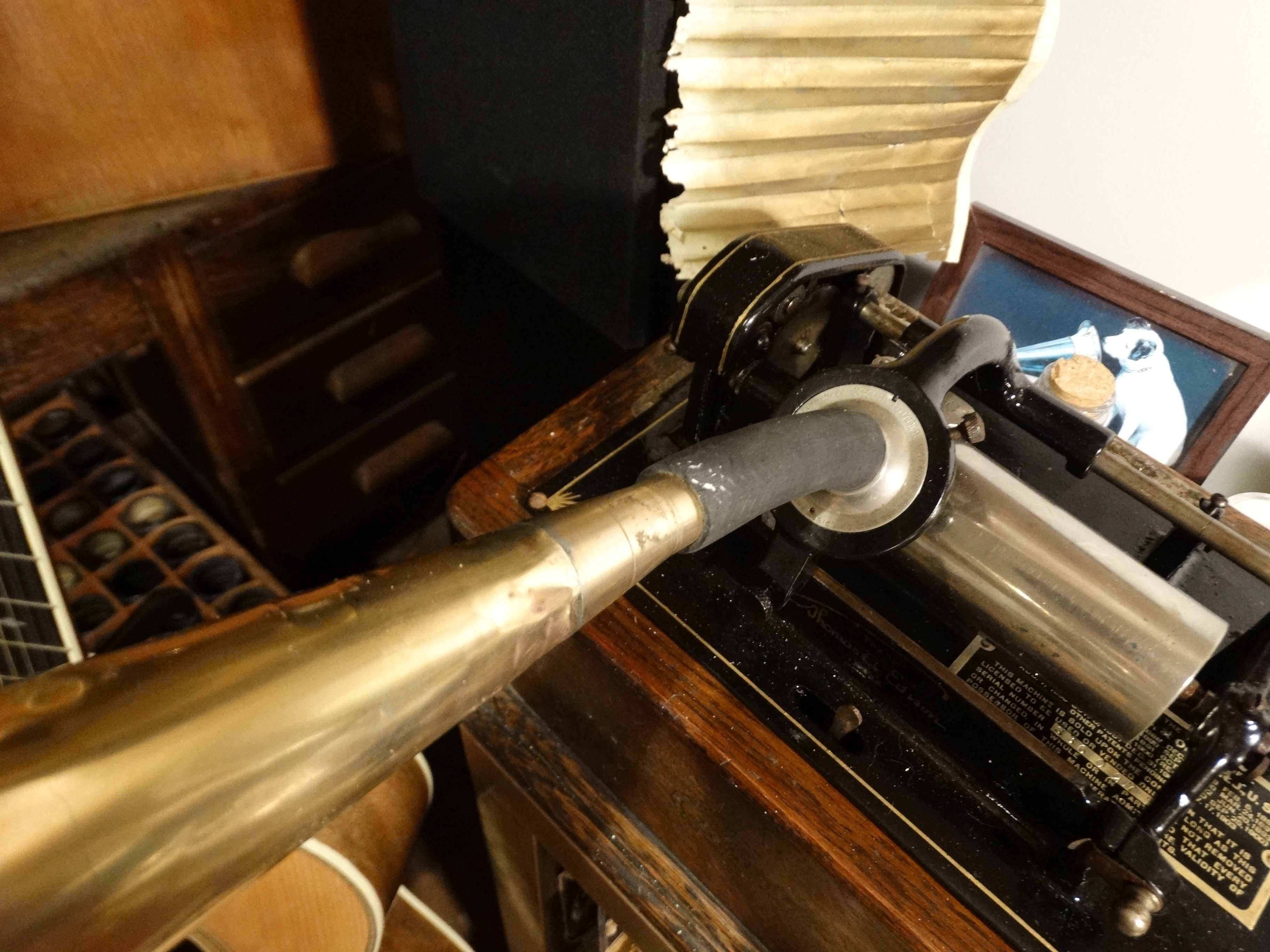

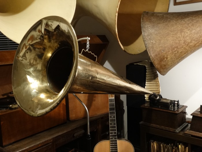

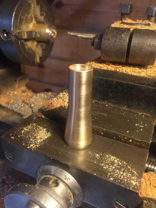

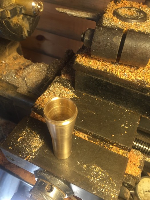

Well today I got the horn done for now, I had to buff out some deep green corrosion in the horn, so to avoid the horn looking patchy, I decided to buff out the whole horn, but I have left it as bare brass, so I'm going to let it dull down again before adding a clear coat.
I made a new tapered end and soldered it in place, and a new hanger, i'm pretty happy with it, it looks a little strange being polished but retaining all the dents, but that will sort itself out.
Here's a little video I did of the first test, some flutter to sort out, likely an issue with the old belt and it seems a little stiff in places, but not bad for a first test I think.

No it's a brand new stylus from Wyatt Markus so the sapphire should be fine, I think that issue was the limit pin running right at the end of its reach and the groove getting away, I have since switched the reproducers up a bit, the one I was using there was a bit put together and was causing excessive wear with swarf on the records (somewhat worrying when seen on that fab sterling), I've taken the best parts from that one and this standards original reproducer and put together a reproducer which seems much better
