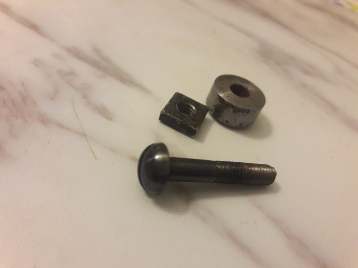

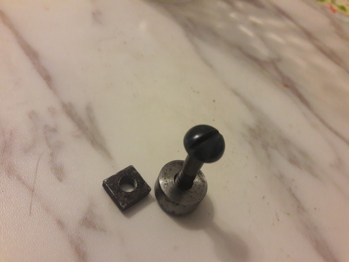

I have an old lathe I picked up years ago for next for nothing and make my own screws. I bought 3 x ¼ inch bolts from Lowes, turned them down on the lathe and then cut the threads with a die.
Here are the ones I made for my Amberola 50 bed plate. The bluing was done with a propane torch. Cannot tell the difference from an original screw.
