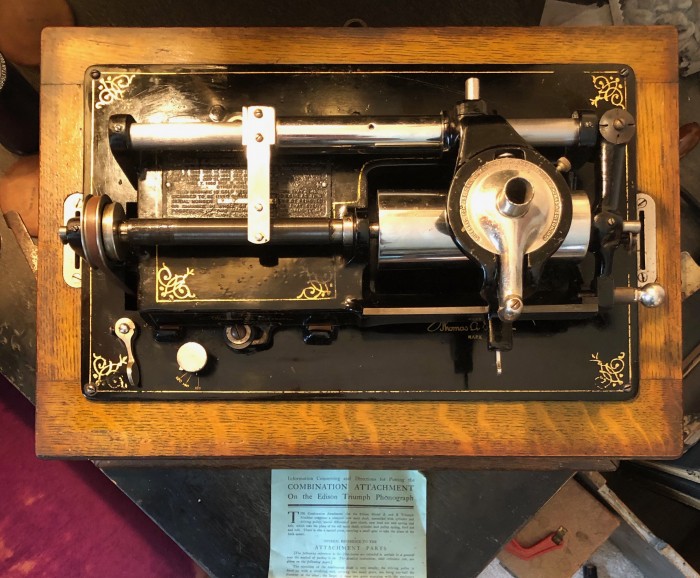

Yes. My Triumph A was converted to 2/4, and a horizontal carriage was added to hold a Diamond B reproducer. I use a reducer ring when I use a Model C or a Model H reproducer, so I can play just about any cylinder with this machine. I think that the conversion was done a long time ago. The instructions for the conversion kit where still inside the machine.

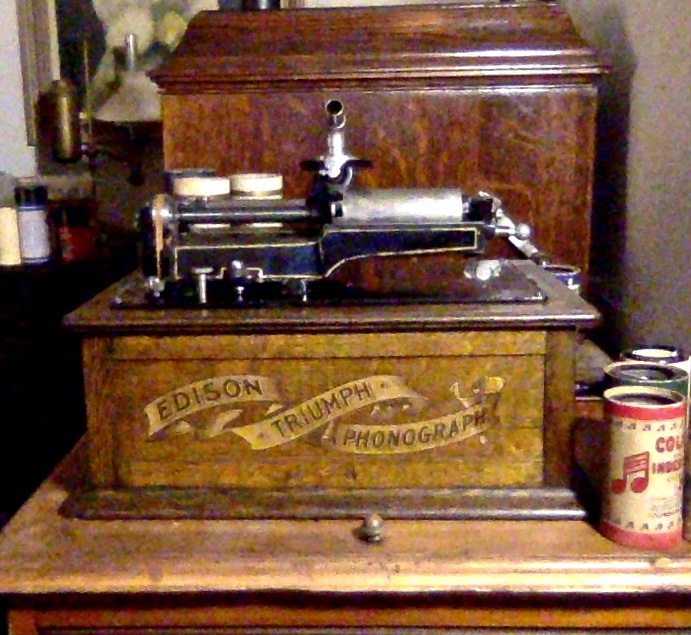

I also have a Triumph A with combination gearing and horizontal carriage. Got O and Diamond B reproducers for it as well.

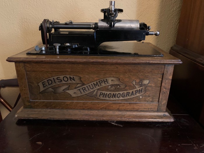

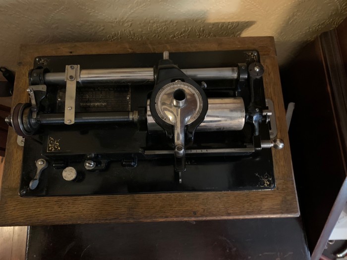

My very early Model A (30360) was fully updated with 2/4 minute gearing, horizontal carriage, 11 panel Cygnet and Diamond B.
It also had the locking end gate fitted to machines supplied for the British market.
As I only collect Blue Amberols I sold it when I bought an Opera. The new owner has acquired a Model O reproducer for it.

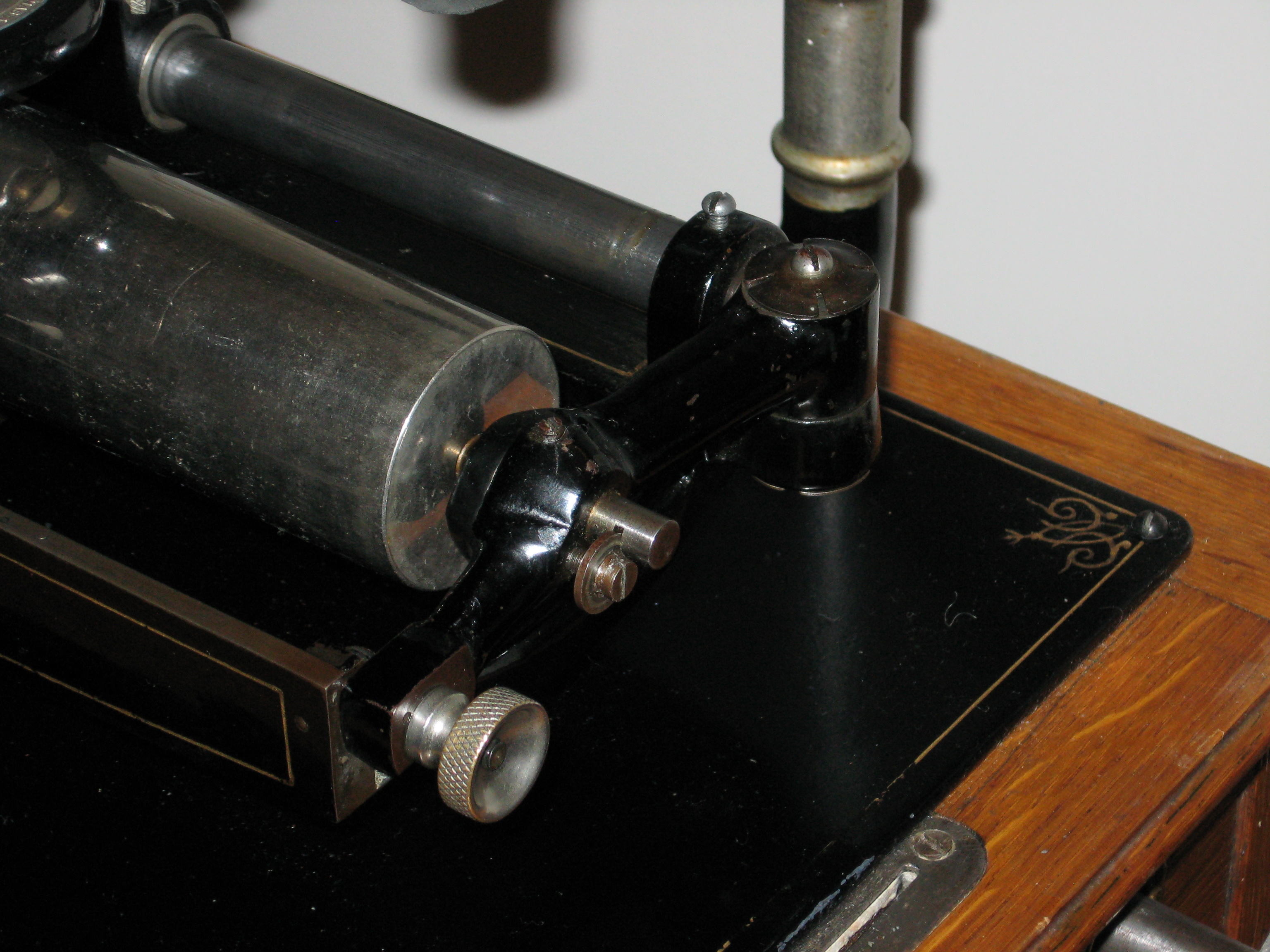

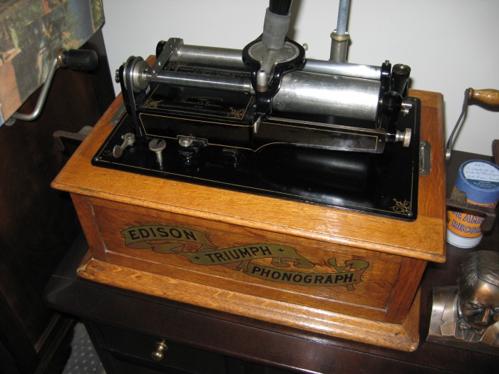

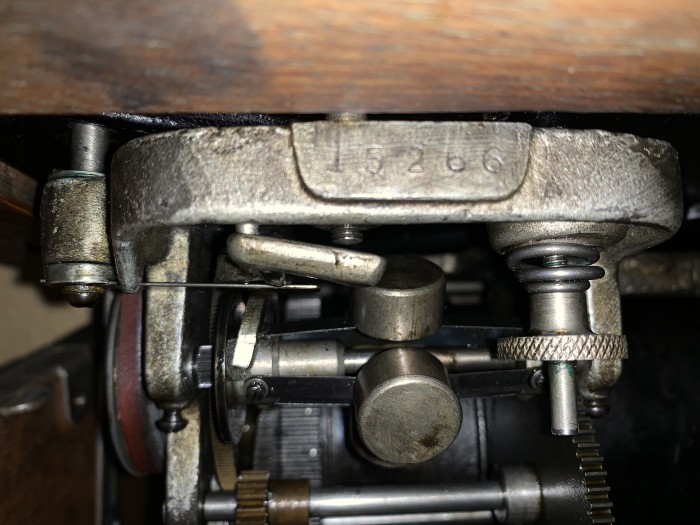

I have Triumph Model A, serial number 30136. A while back, when George Paul was collecting information on Triumphs, we discovered that mine was the earliest known Triumph Model A. I don't know if an older one has been found since then. I traded a banjo neck for this Triumph back in the 70's. It was converted to play 2/4 minute records when I got it and had a Model O reproducer.
What was more interesting was that it had also had a motor upgrade. If you look back through the Edison Phonograph Monthly issues, you will find an announcement about upgrading the early Triumphs to include a 4-ball governor. The Triumphs did not come with a 4-ball governor until Model D. This particular phonograph has that upgrade. It wasn't as simple as replacing the 3-ball governor with a 4-ball one. It also required replacing the the motor frame. Obviously, this was a pretty serious upgrade. One wonders how many were actually done. Below are some pictures.
