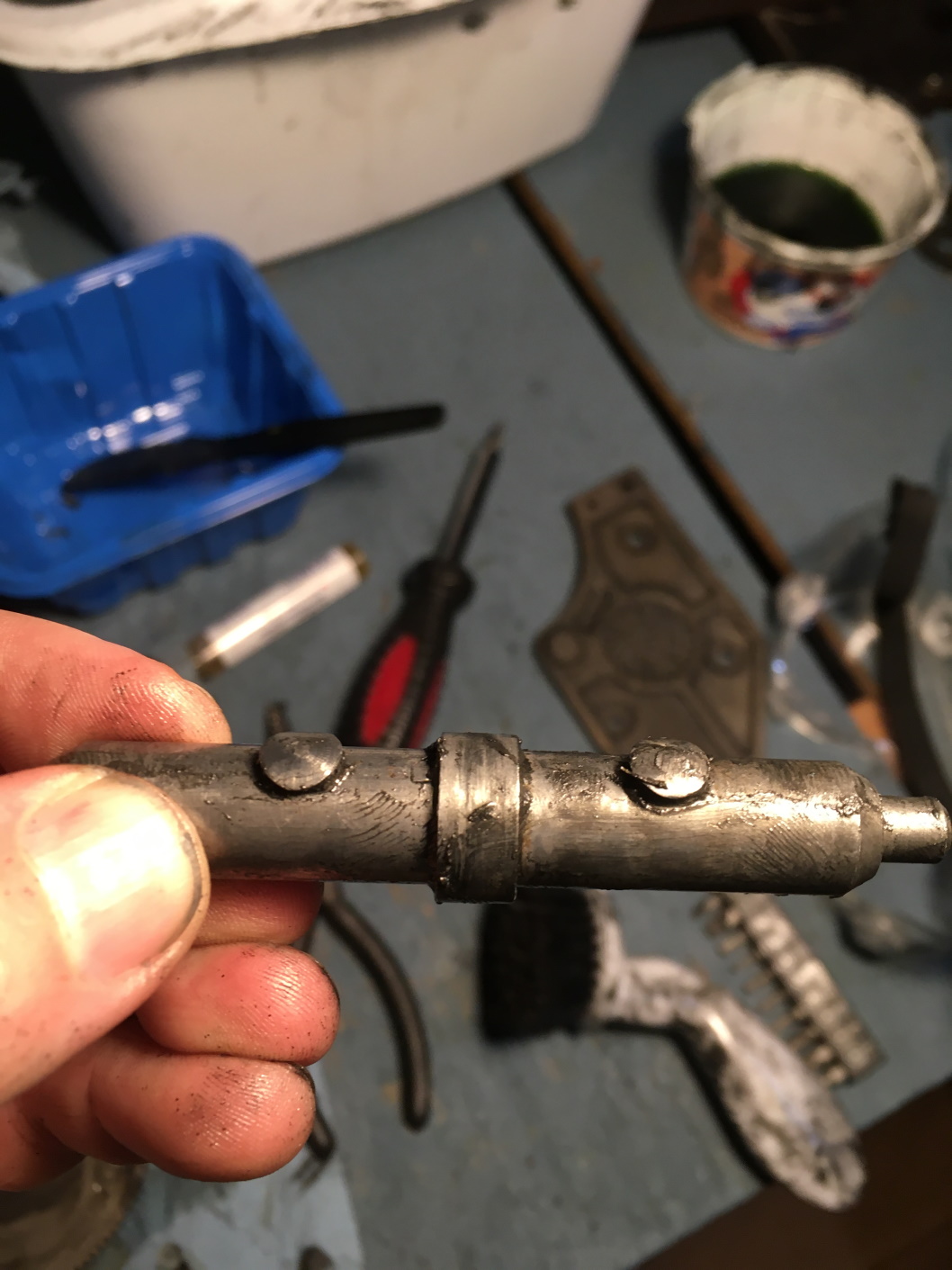

I got the springs cleaned and back in their barrels, although I think I scratched the inside of the barrels trying to get the springs on the outer clips. At first I tried putting the springs back in with grease on them, but that didn't work as I couldn't get a good grip. So I greased them after I got them back in. Hope the grease will work its way down inside each coil.
I'm trying now to re-attach the arbor shaft. I managed to get it in the clip of one of the springs, but the other one is eluding me. Not sure if I'm missing a trick?
I'm contemplating placing two felt washers between the barrels (i.e. at the place where the arbor shaft goes through), so that there is no metal on metal contact and so that the grease doesn't come out. When I pulled the motor, one barrel had tons of grease around it. Not sure if someone put it there or if it came out through that hole where the arbor shaft sits. One guy of facebook said it was probably due to heat, forcing the grease out.
Thanks for all your comments. They really help. The 1st picture is how it looked when I pulled it from the cabinet.
