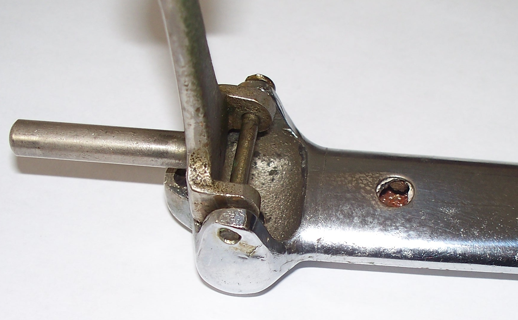

vic-b wrote: Sat Jan 01, 2022 4:54 pm I also have an early A. My brass horn and elbow is of the slip on type, no knurled thumb screw. I also have the more centered placement of the travel arm support. What I DO NOT have, and have never actually seen in person is the travel arm that is elliptical and solid, and not pressed metal with the hollow underside.
I am told that technically that is what my machine should have?
Best,
Jeff
Wisconsin
The elliptical arm you mention is actually hollow and is two piece bi-metal (steel tubing and cast brass head for the yolk) constructed. It is believed to be the first type of production arm. Again, possibly as a cost saving measure, an arm like yours was introduced within a short time.
Your Type A appears to have a serial number in the 4000+ range. So, the elliptical arm may have been replaced with the simpler style arm by this period ?....hard to say without more machines examined. My Type C has no serial number to use as a reference.
