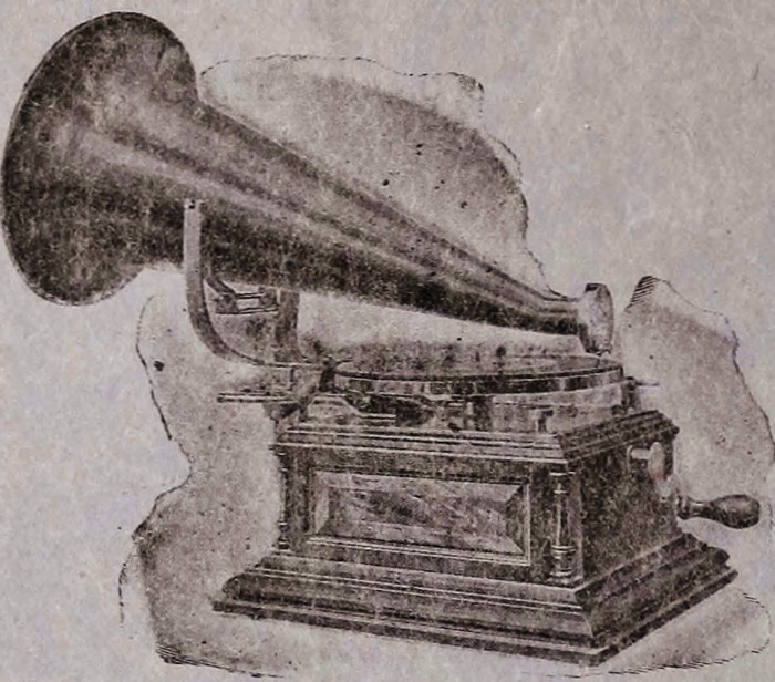

I can share that pin The Phonoscope, Zonophone dealers were being sought in April of 1899, and the first appearance of a Zonophone machine ad was in November of 1899. The Machine was an A, but had a mechanical feed screw horn arrangement.
!!!! Do any of these mechanical feed screw Zonophones exist today? Did they even really exist in 1899, or was this some preliminary artistry for the sake of getting out an advertisement? (Much of that sort of thing is prevalent in early automobile ads.) Or, an early design that never made it into production?

Around 20 years ago an unrestored Zonophone-like disc machine with a mechanical feed surfaced on eBay. It may have been a Zonophone or it may have been a George Cheney prototype. Unfortunately, any images I saved were lost. I bid on it but it went for strong money. I've always wondered what happened to that machine.

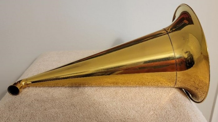

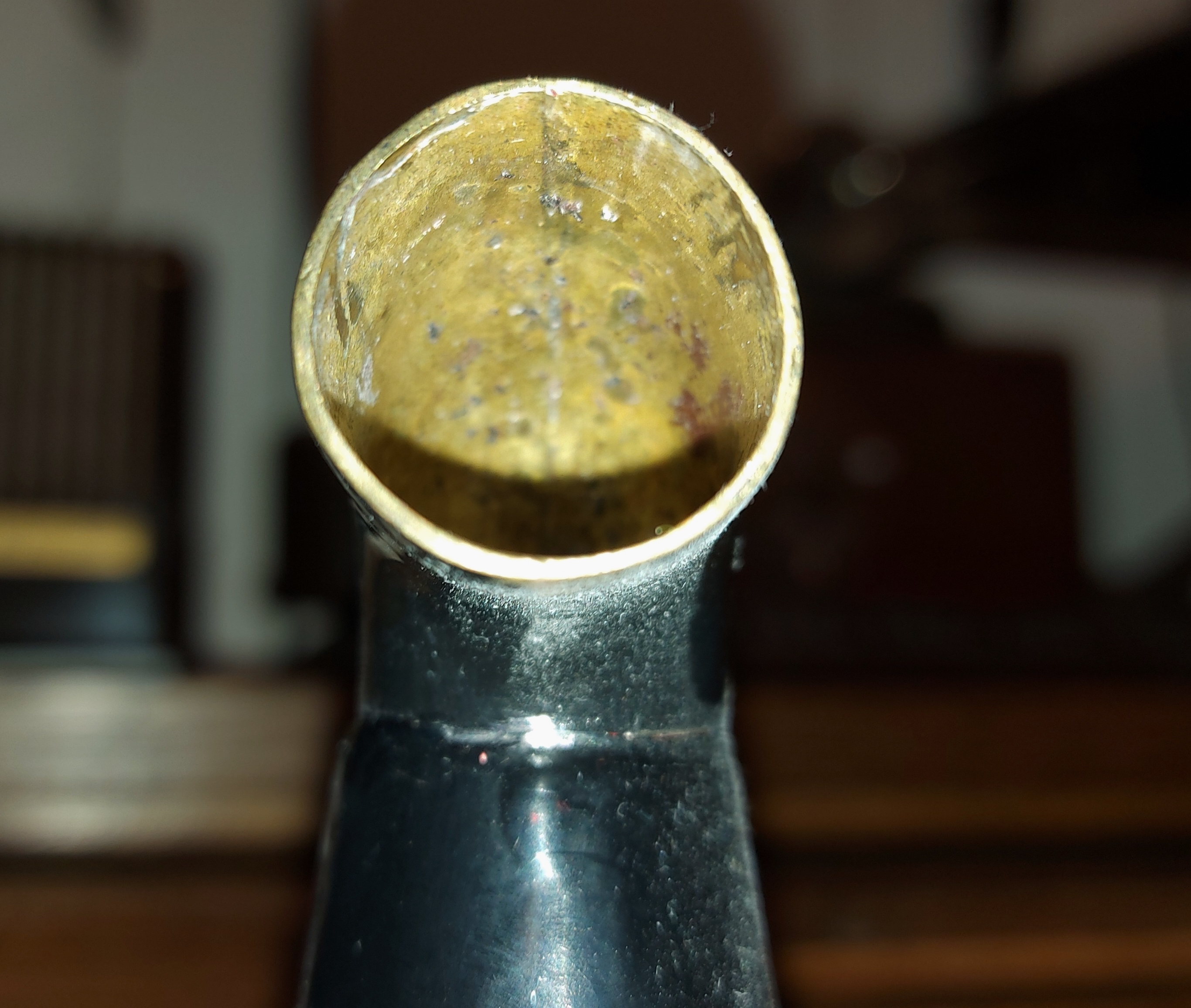

gramophone78
Posts: 3946
Location: Western Canada
Re: When was the first Zonophone actually made?
Post by gramophone78 »
+1 on George's advice.

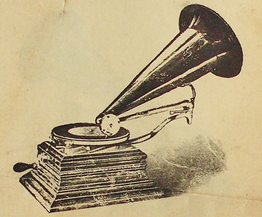

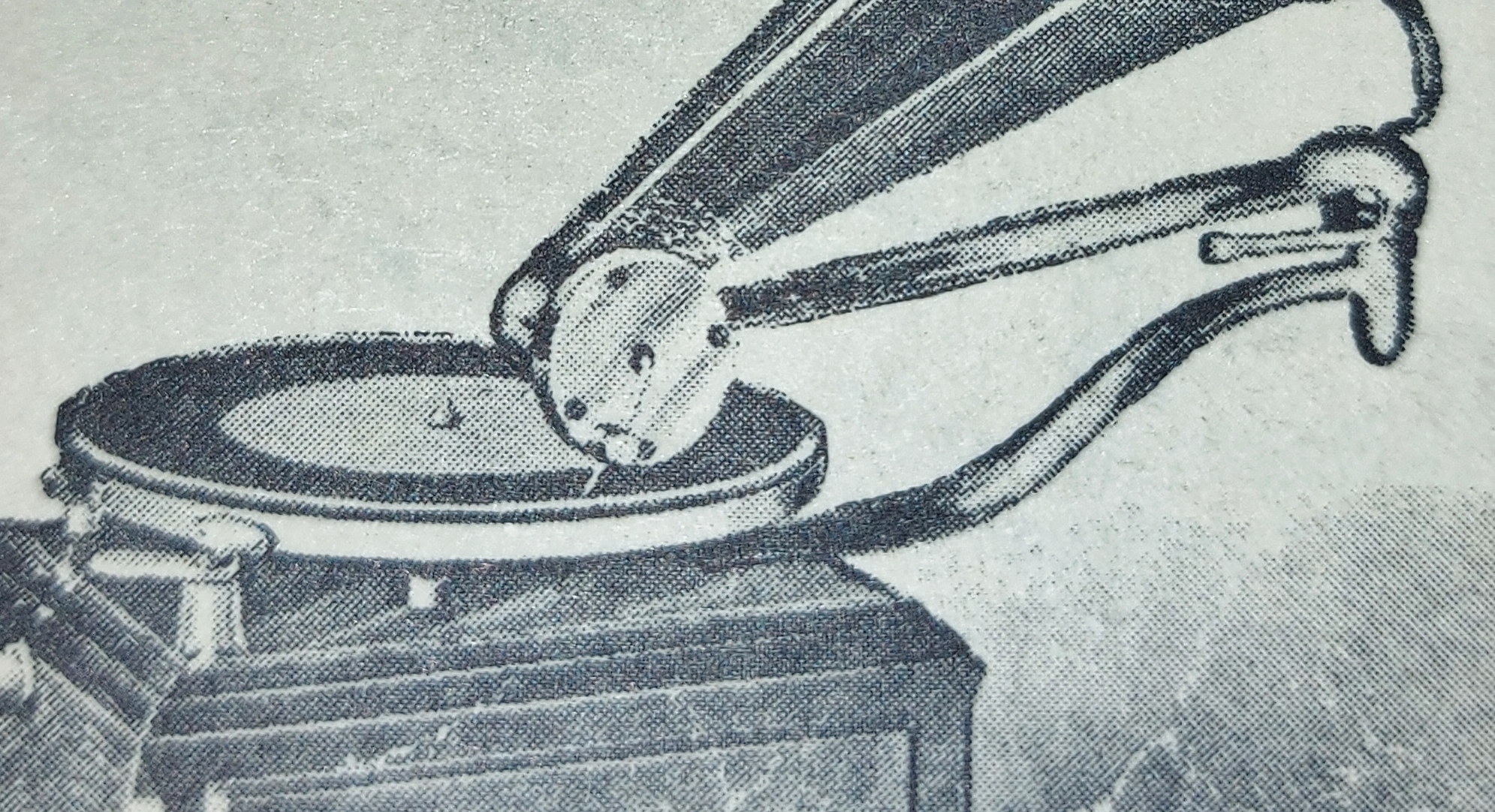

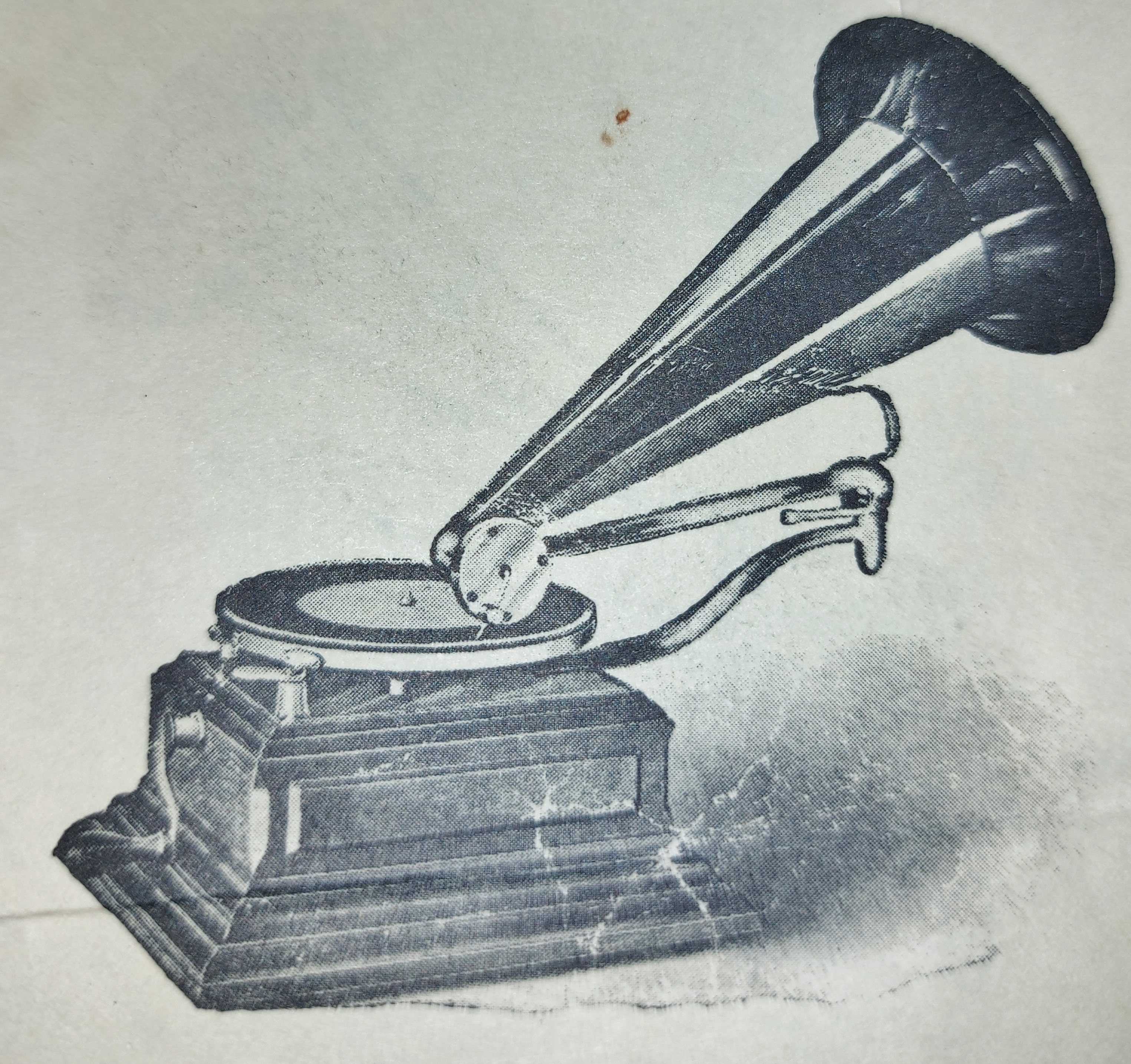

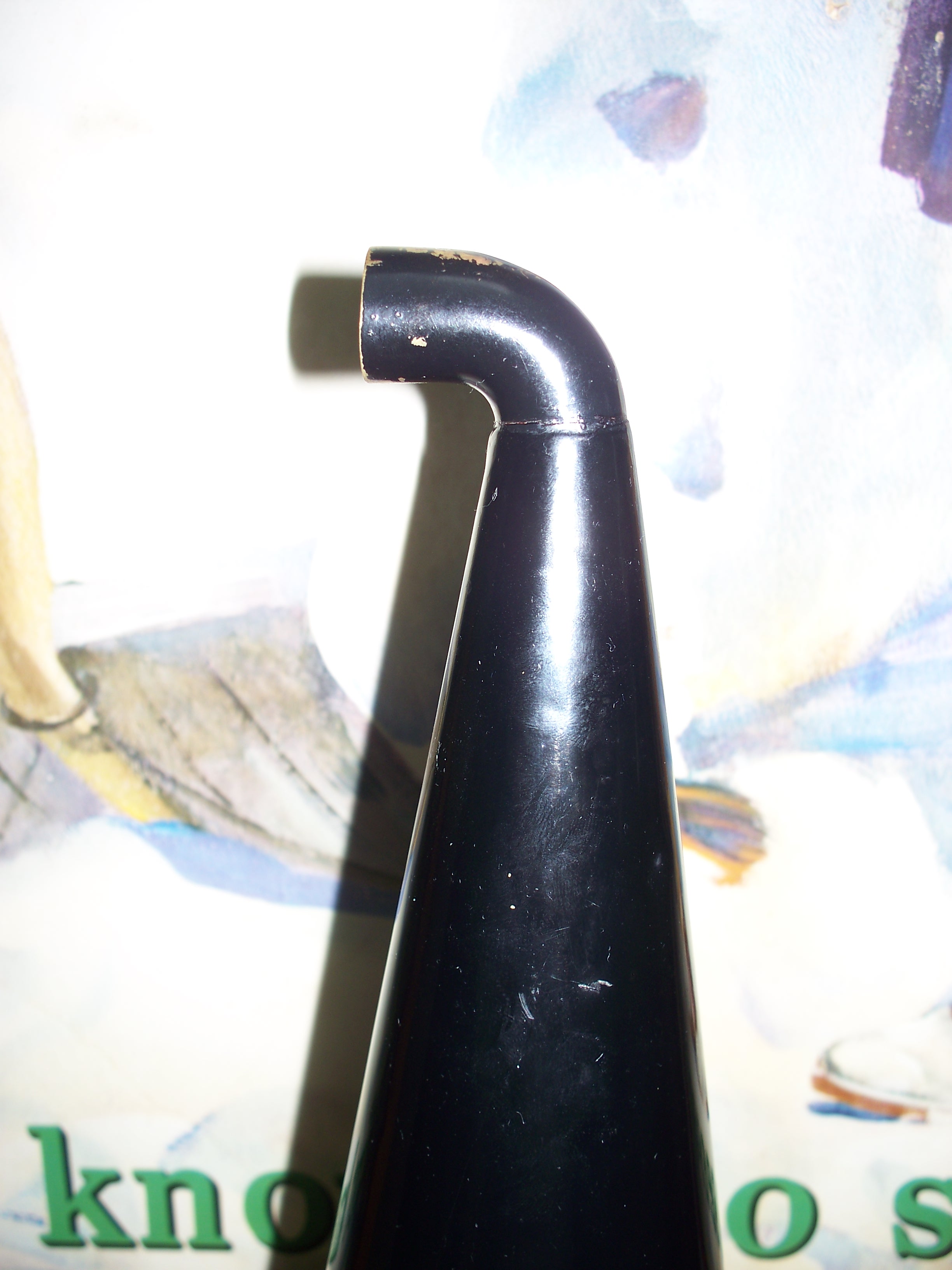

If you look at the first Zonophone ads, you may notice something.....well, missing. There is no leather elbow used.
I believe the first production run of machine's had a metal elbow that is made in two halves and fits perfectly onto the sound box (as shown on my early Zono).
The Zonophone was being marketed like no other machine before and nothing like the Gramophone in performance and quality and had to be shown as something "new" to attract buyers.
Even the mechanical feed model appears to have had a metal type elbow.
However, perhaps as a cost saving measure, the use of a Berliner type leather elbow soon replaced this well made elbow.

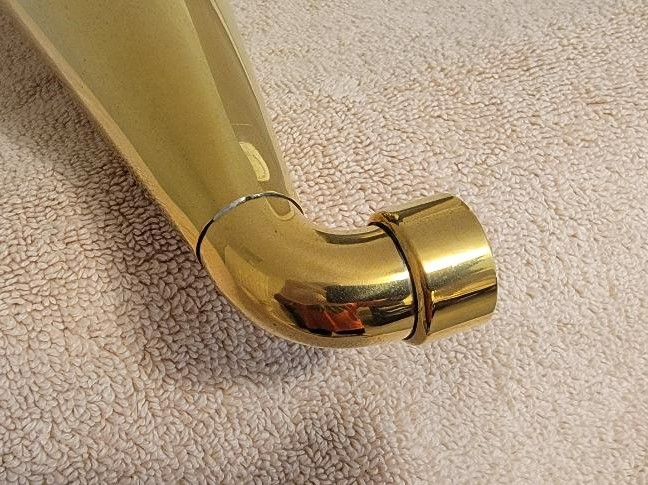

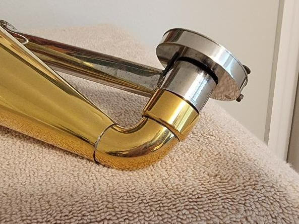

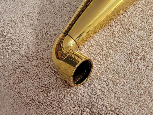

Zwebie
Posts: 1471
Location: FLORIDA
Post by Zwebie »

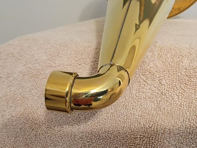

Another version of the early elbow, which has a widened end and is lined with celluloid?, for a snug fit on the reproducer.
I have seen very few of these, maybe it was an evolution of the first type elbow, but too costly to make?
Cheers, Bob S.

Although Frank Seaman played fast and loose with the name of Zonophone (since early 1898, but first simply as an alternate term for Berliner's Gramophone), frequently confusing even other advertisers in the Phonoscope, there were no actual Zonophone machines as we know them, in 1899 (in the marketplace).
The complex feedscrew model shown in the large Phonoscope Ad ("Nov 1899") was no figment however - it was actually patented, and appeared (for $30) in a (now) lost catalog in early 1900, as 'No. 55.' It was based on Cheney's US Pats 640,367 & 641,578. They would have been rather difficult to manufacture to say the least. I have never seen it in the wild but a prototype was surely built.

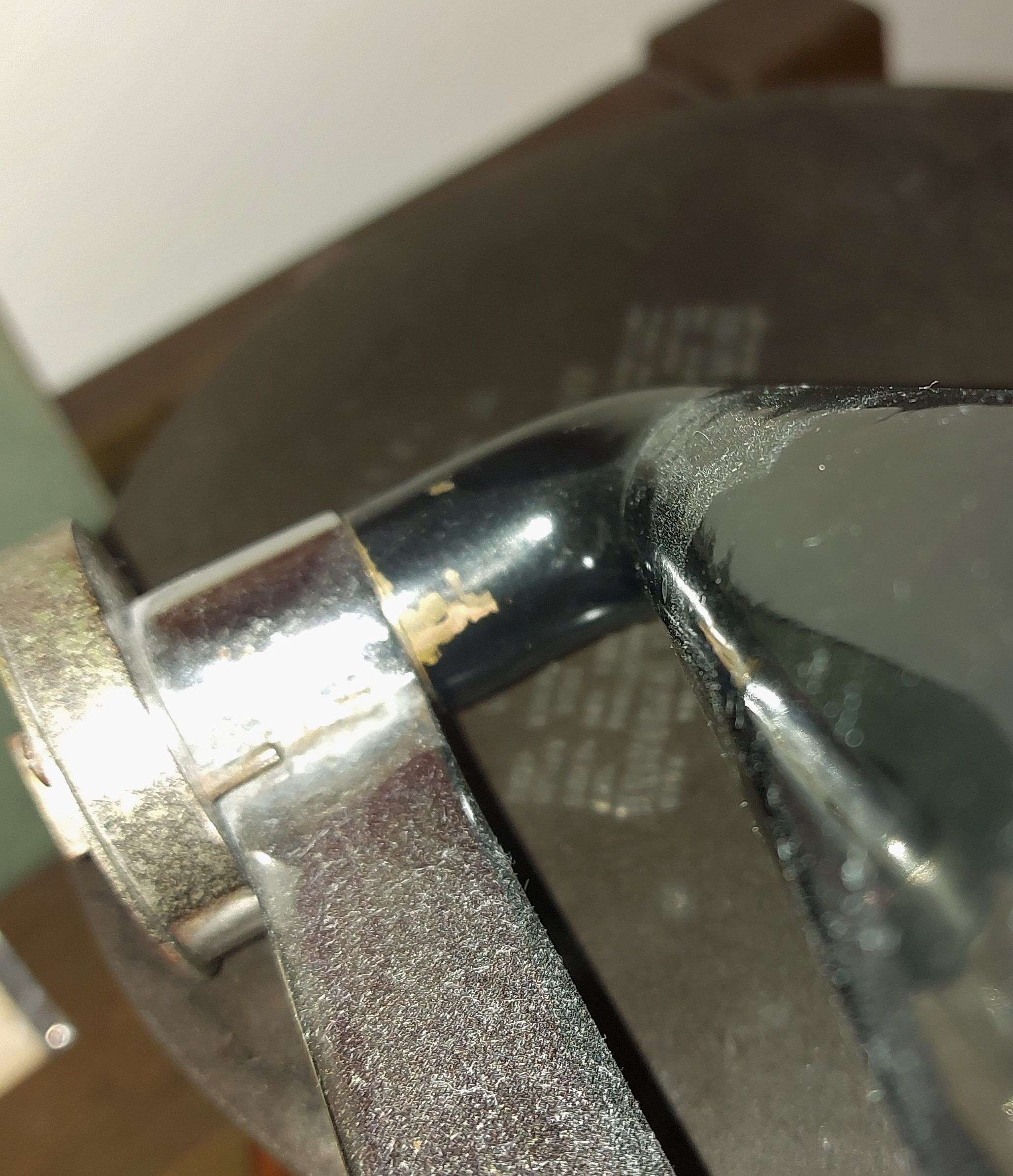

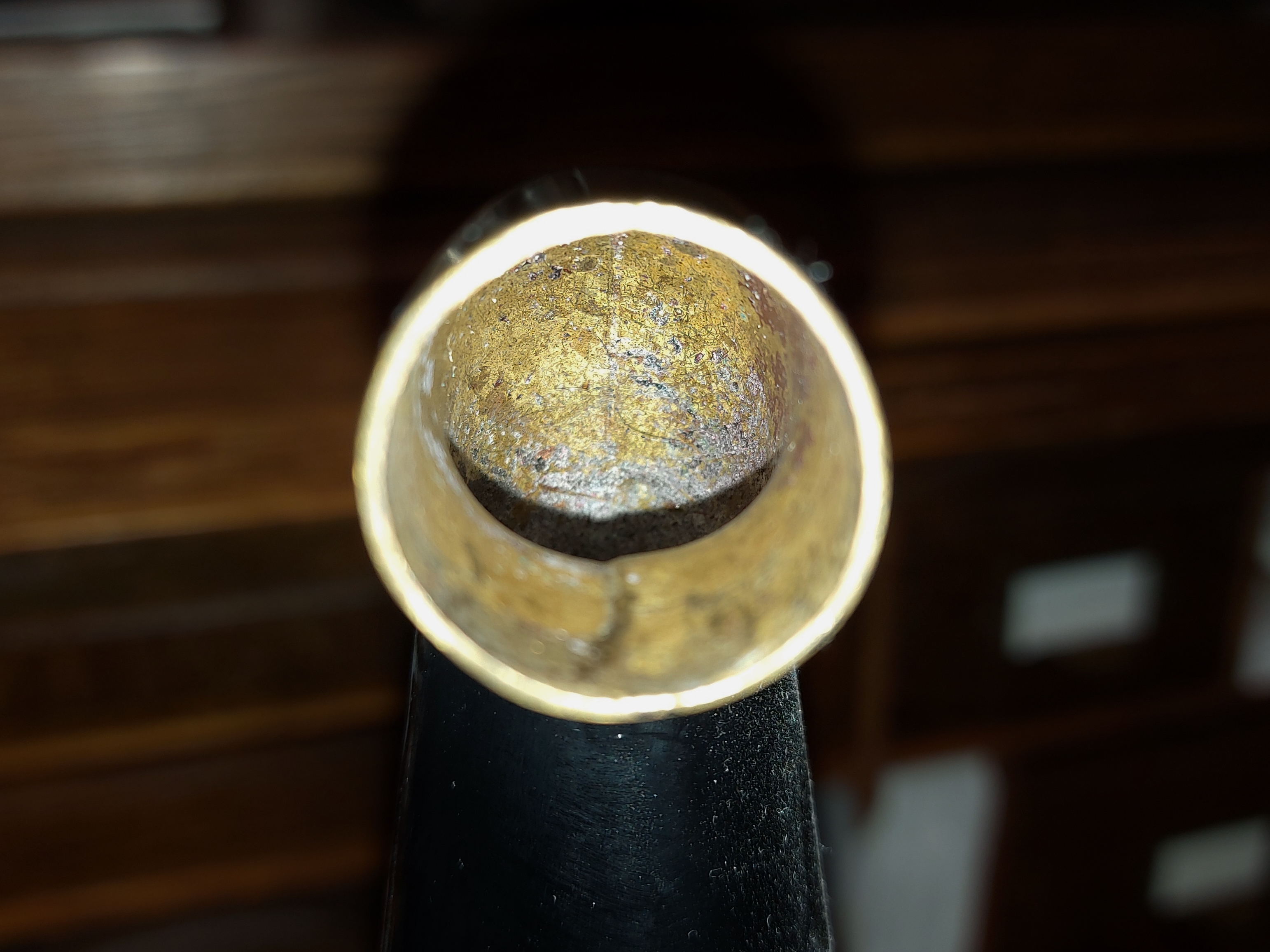

gramophone78
Posts: 3946
Bob, Thank you for posting the pics of your brass elbow. Mine is also brass (painted black) and quite well made. To solder the two halves and then solder onto the horn would have not only been time consuming, but more expensive than to just switch over to a cheaper and already readily available leather elbow. This would have also cut down on horn material being used too.
As a fledging company starting out, you would want to put your best design forward and be "different" in anyway possible to the competition. Then try to increase your profit and decrease your production time and costs.
I am amazed at how perfect and tight the fit is with the elbow to the sound box throat.
Ironically, within a short time, the use of a metal elbow on Zonophone's came back, only with a built in clamp device.
