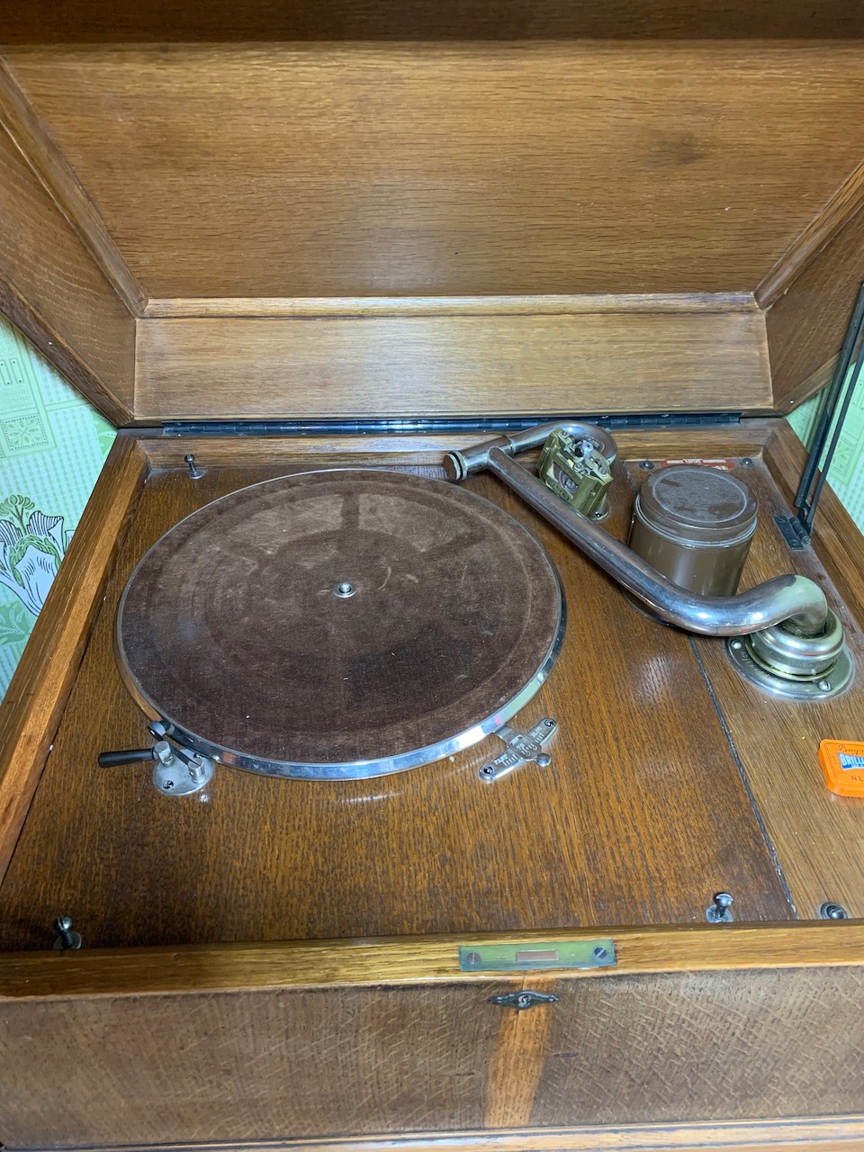

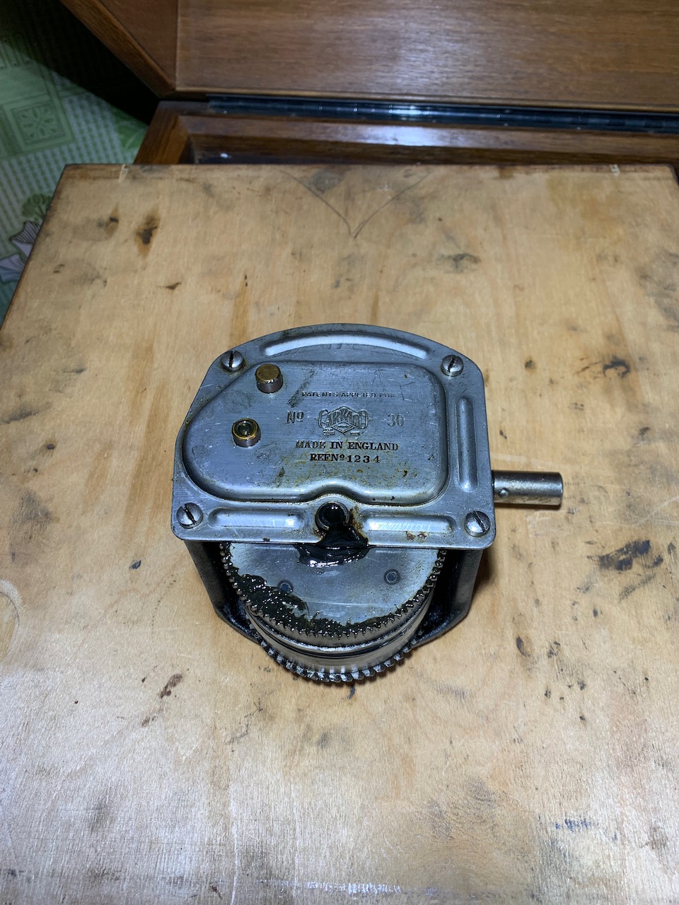

I am attaching some photos to show the existing Garrard 30 motor in situ. In my opinion (and I have collected many phonographs), the motor is lightweight for the task at hand, requiring many many cranks with relatively little resistance to get it fully wound. I had read of EMG/Expert's upgrade paths back in the day to a good electric motor such as my 201v, so I would like to perform that upgrade with a new motor board, thus preserving the existing board and motor without damage. The issue though is that the motor arrived non-functioning. I hope my electric-motor-repairing-cousin can deal with that although he would no doubt be most grateful if a service manual were to surface.
Here are the photos for your observations and comments. I have owned this machine for about 40 years at this point and it appears to be untouched, although the finish on the motor board does not quite match the finish of the board the tone arm is mounted to.

Many thanks for the photos and I quite agree with your comments that the motor is rather lightweight for an Expert Junior. I think the Model 30 might well be a replacement. My own had a Collaro D30 originally but now has an electric substitute. As you say, the main deck-board seems to be a slightly different colour to the adjacent tonearm board but well-matched from the point of view of the veneer. I do not think Mr Ginn would have permitted use of a cheaper motor and I cannot imagine a customer specifying such ! The hole through which the motor spindle appears is a little poorly made, again indicating that Expert may not have been involved.
All of this means that your decision to upgrade to a 201 and a new deck-board would seem to be an excellent idea. It is an induction motor so, in theory, there is not a lot to go wrong. Sometimes the laminations get into trouble if the motor has been left in damp conditions but otherwise the mechanical side of things is pretty similar to any other motor---governor etc. I think it unlikely that a service manual exists but hopefully your cousin will be able to do the necessary.

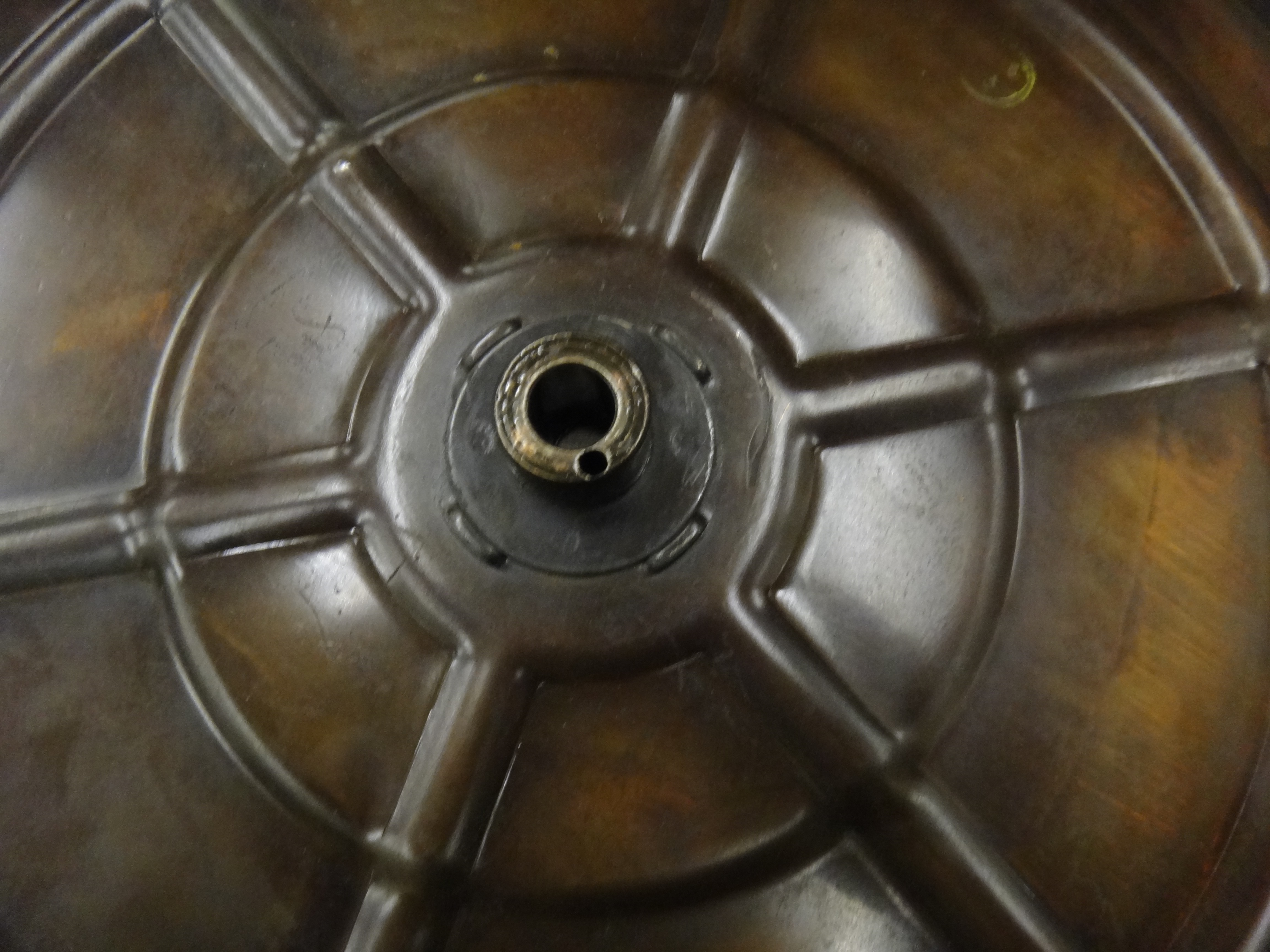

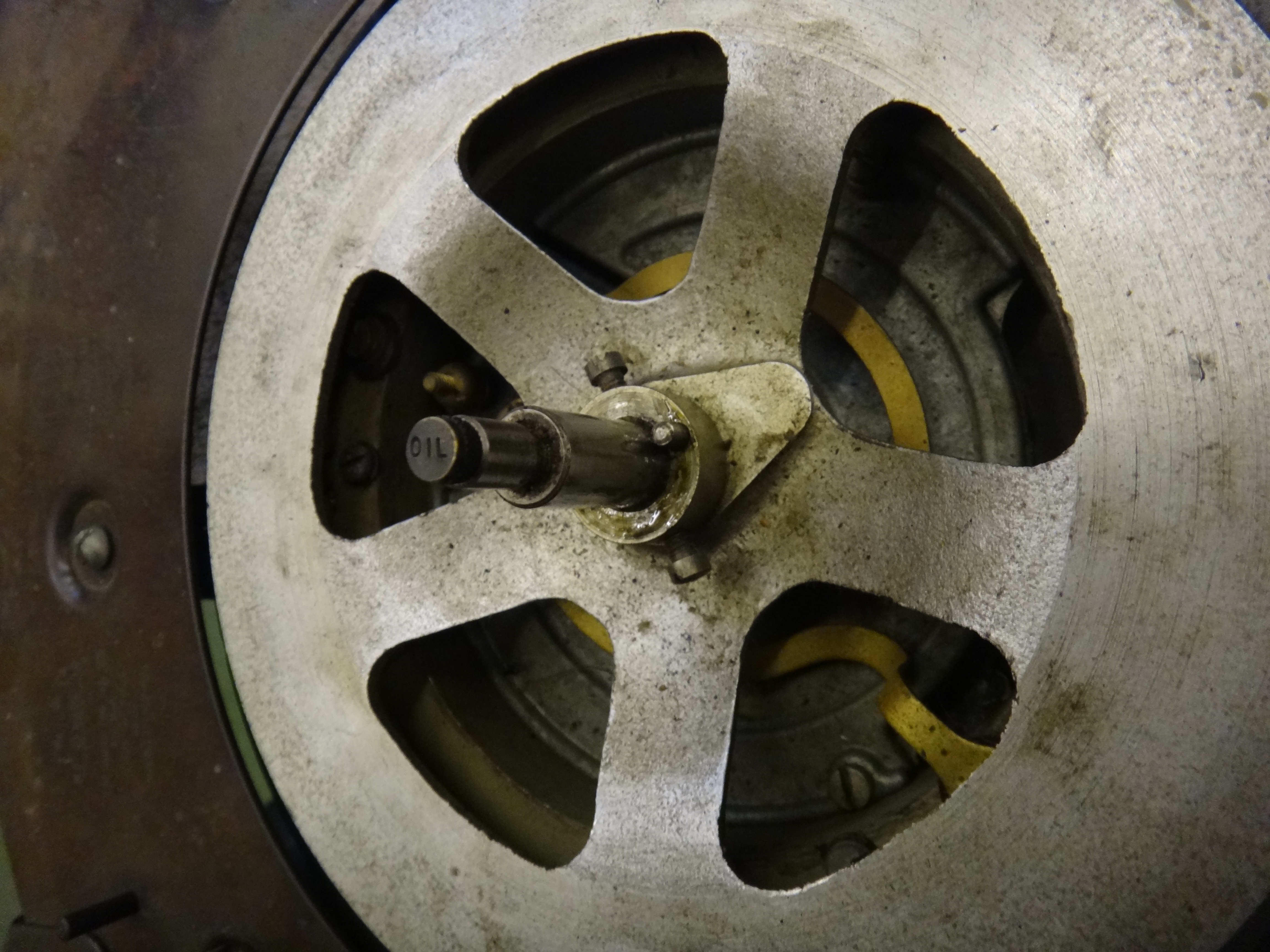

Don, I only have limited experience with these motors but have seen perhaps ten examples. In every case the spindle/turntable joint has had a parallel shaft fixing with a small cylindrical post underneath to take the "peg" drive---sometimes two. Having said that, I have a photo on my computer files of another example in excellent condition which I have never seen "in the flesh" but which appears to have a taper---but I cannot be 100% certain. There were so many models and that particular one does not appear to have a peg (I have more photos of the same item showing other views around the spindle).
Based on the above, the probability is that you have a parallel joint and that studious use of a penetrating oil over an extended period might elicit releasing success. In order not to allow the penetating oil into the "works" you might need to invert the motor throughout this process and introduce the fluid with a long-nosed syringe. If that is not successful, gentle use of heat (hair-dryer ?) at the centre of the turntable might produce the desired result ? It would seem that your motor may have been stored in damp conditions and that there is some oxidization present.
The fillister head screws you refer to secure the "peg-drive" to the shaft but I think it unlikely that releasing these screws would assist in this instance---but you could try. The seizure is more likely to be between the turntable boss and the shaft. I have never seen the odd set-screw arrangement shown in your boss which appears to be an ill-thought-out and badly-made, non-factory, later addition ? There does not appear to be a screw present at all---just the mangled threaded hole ? If that is the case, the opening might just be helpful for introducing yet more penetrating oil ?!
Sorry not to be more definite but I hope this is helpful and good luck. Please let us know how you and your cousin get on.
