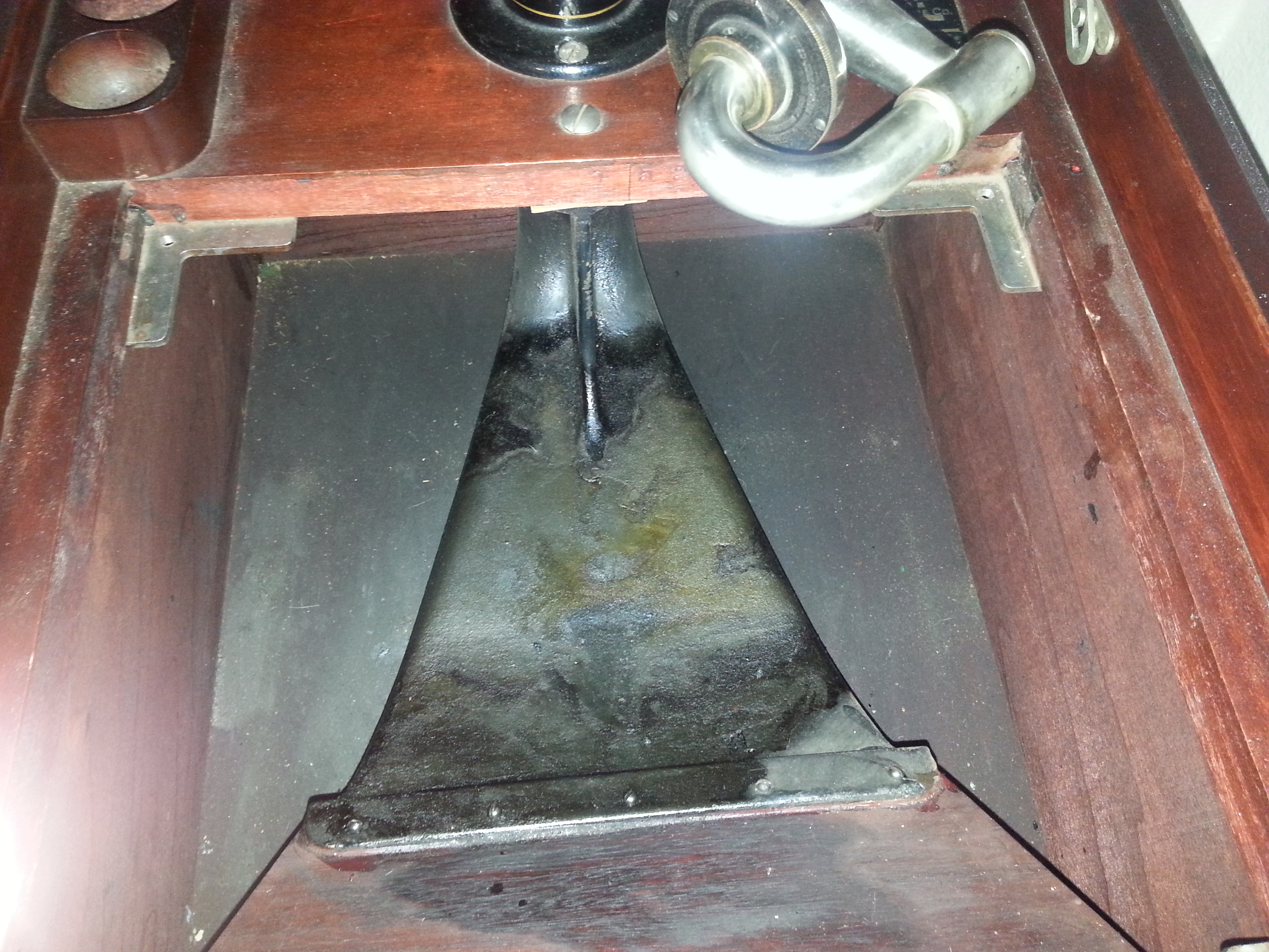

zipcord
Posts: 259
Location: Albany, CA
Re: Horn of the VV-X "spider"/Queen Anne legs model
Post by zipcord »
here's some photos of my Spider Leg VV-X
Posts: 4671
The zipcord example is what is called the floating horn? It's a complete horn. The motor goes outside, on top of it.
Posts: 6823
Inigo wrote: Thu Feb 17, 2022 1:45 pm The zipcord example is what is called the floating horn? It's a complete horn. The motor goes outside, on top of it.
Wondering that myself. In 40 years of messing with these things, I've never heard the term "floating horn" before.
Posts: 4671
I've read it somewhere, maybe in old hmv catalogues, or maybe other place. But I want to recall... that even I've seen it in Spanish hmv catalogues, translated into Spanish (bocina flotante) referring to the big Gramófono no27, which was the equivalent to the Victrola XVI.
So the horn of the L-door XVI was the floating horn. It's it like this one? Cast iron throat and mid part, and wooden extension with slats, the horn hanging from the tonearm board, and fixed to the cabinet by means of two felt-lined wooden L-shaped blocks fixing the wooden extension to the cabinet sides near the mouth?
CharliePhono
Posts: 927
Location: Oakhurst, CA
Post by CharliePhono »
zipcord wrote: Thu Feb 17, 2022 1:39 pm here's some photos of my Spider Leg VV-X20160306_103241.jpg
Perfect. Thanks much for taking the time to make and upload the pics.
