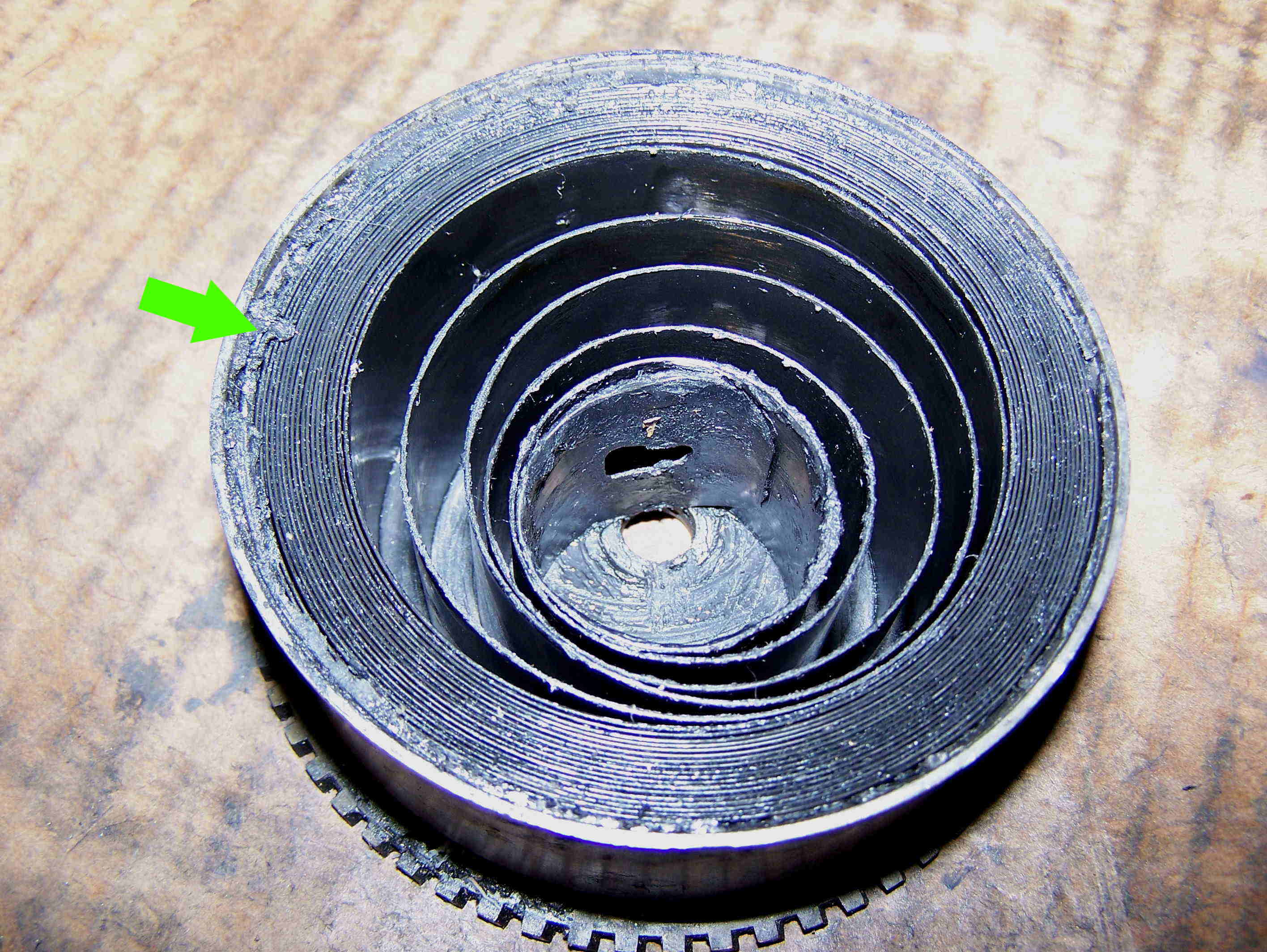

I haven't done that many motors, the ones that I have done show most of the graphite caked on the outer edge of the barrel, with some smaller amounts in the centre, like in my photo's
The green arrows show the caking, the red arrows show what looks like caked grease, but it isn't, they are very small areas where some has fallen from the edge when I removed the springs.
Lots was on the cover, but very little of anything was on the coils; nothing but a thin film of oil from the Vaseline and a scant amount of graphite (this assumes that graphite and Vaseline was used, they are both Victor motors that I bought from eBay for parts, the springs were just removed now)
There was no caking of dried grease on the coils, interestingly there were dry spots on the coils, so maybe after another 50 years in somebodies dry hot attic, the oily film would have dried up, and I can see a situation that you have described of caked dried grease
