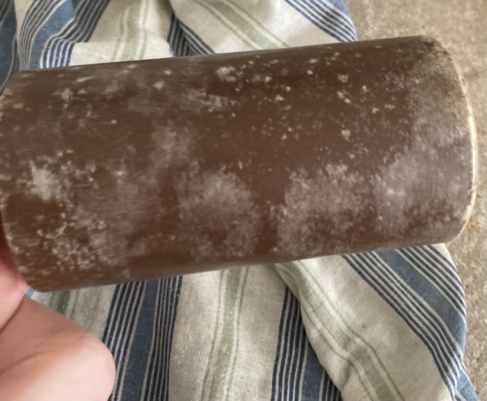

This thread is great because the impossible actually happened today…I FINALLY found a brown wax record! :shock: :o 😮😱 but I think it might be an original blank too…
