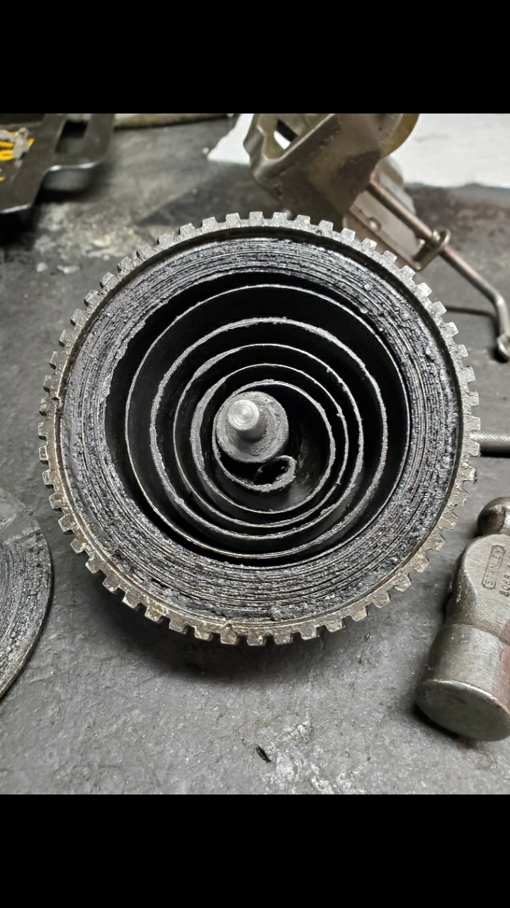

I'm not quite sure Jeff, but I believe it broke and the spring was bent up. He told me he repaired/reshaped the old spring.
Here's a pic of the open spring barrel he sent me.
JeffR1
Posts: 584
Re: Victor O
Post by JeffR1 »
Thanks Travis, curiosity satisfied. ;)
That is strange how it got that way, especially if it was working when you bought it, to get like that the turntable would have to be turned backwards with ones hand, or counter-clockwise, that would unhook the spring from the arbor and bend it back like that _ someone correct me if I'm wrong.
Winding it backwards would do the same thing, but that's impossible to do that.
