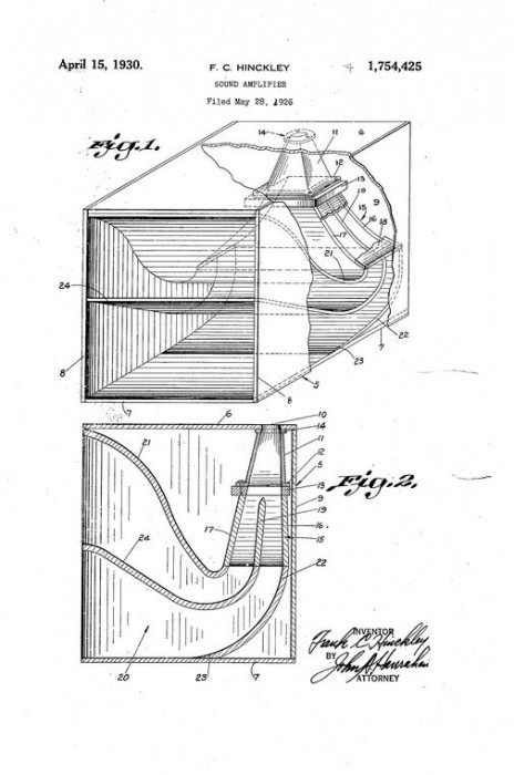

That's true. While both Columbia and Victor signed up for the the Western Electric recording process, only Victor (and later the Gramophone Co. through it's affiliation with Victor) had the production rights to the Re-Entrant style horn designed by Maxfield and Harrison. The large horn installed in the US-made Columbia Viva Tonal models was basically a double horn--one on top of the other. (Seen from the back -- https://www.intertique.com/VivaTonal810IDDemo.html ) There were some great photos posted of the horn's front view on this forum, but they are no longer available. However, this patent should give you a clue -- https://patents.google.com/patent/US175 ... rn+divided
The UK Columbia models, in addition the Plano-Reflex style horn, were also equipped with the metal bifurcated horn--as shown in the brochure--which interestingly enough, is similar in design concept to the all-wood bifurcated horns installed in some of the smaller Victor Orthophonic models such as the later production VV-4-4, the 4-7, etc. (The table top VV-1-90 was fitted with a similar style bifurcated horn but it was flattened on the bottom.)
A true re-entrant style horn is divided into four sections or conduits, which join at the horn's mouth, while a bifurcated horn is divided into two sections joined at the mouth. One of the more interesting horns was fitted into the 700-series Columbia Viva-Tonal models, produced in the US. That horn, which is tapered like a saxophone, has a single divider running along the length of the horn, creating two separate chambers.

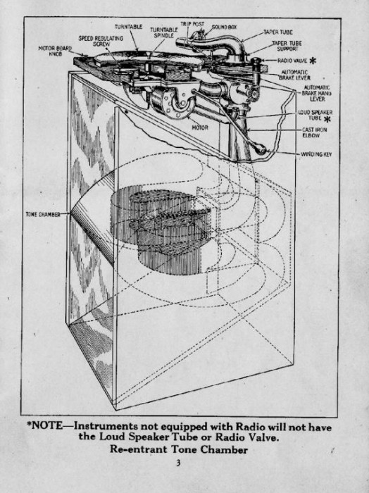

The definition of a re-entrant horn is "a horn which is shortened by causing the sound to pass through coaxial channels successively in forward and backward directions one or more times. " (see: https://www.iala-aism.org/wiki/dictiona ... trant_horn ), so the folded exponential horn fitted into the Columbia 112 would definitely qualify.
But, as phonograph/gramophone collectors understand the word--and in terms of the products offered by Victor/The Gramophone Co.--this style of horn is normally what is referred to as Re-entrant:
(From an Orthophonic Victrola owner's manual.)
While the Victor Talking Machine Co. did not use the term "Re-Entrant" in their advertisements, The Gramophone Co. did, though I don't think it was trademarked.
HTH,
OrthoFan
