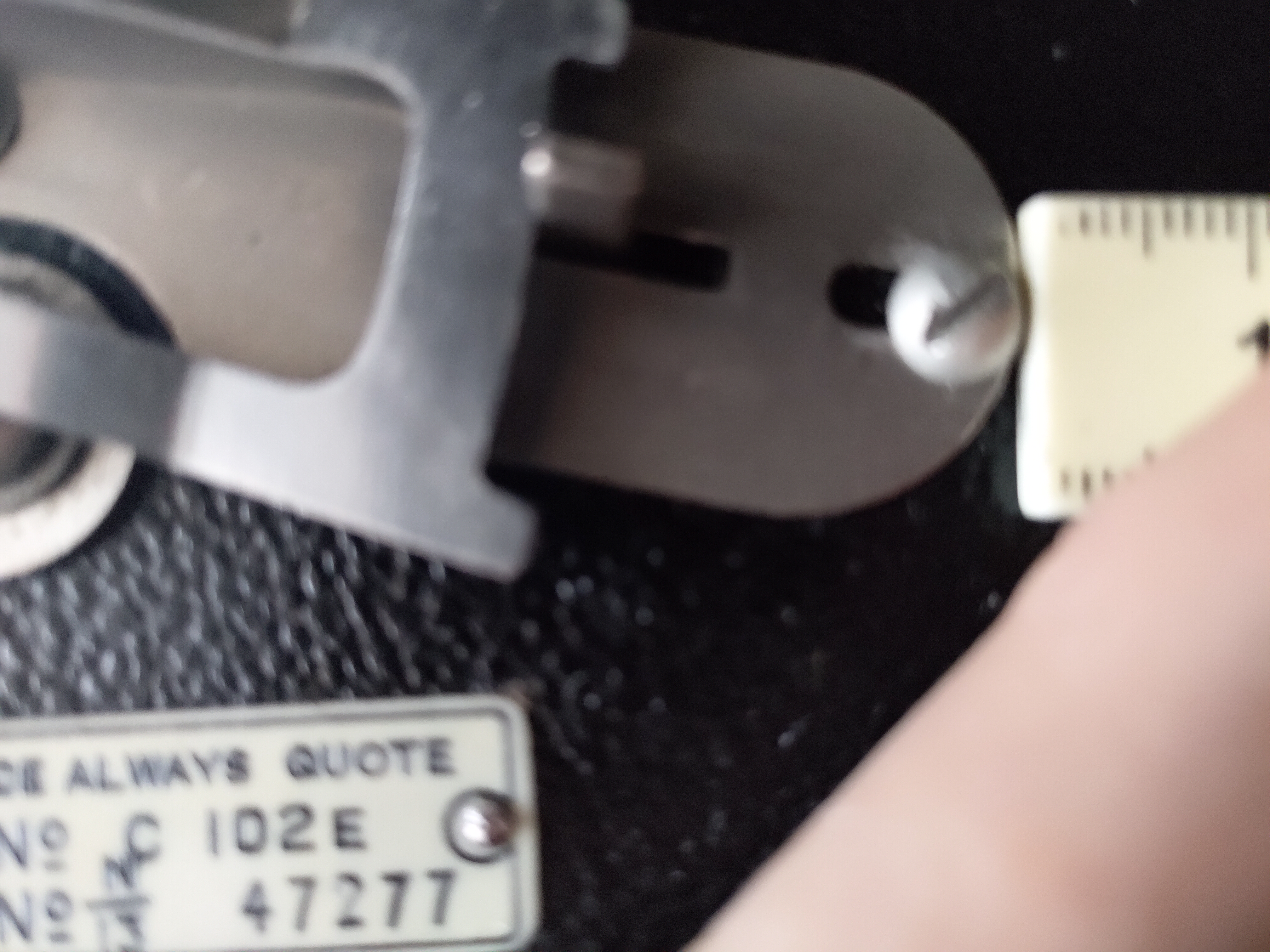

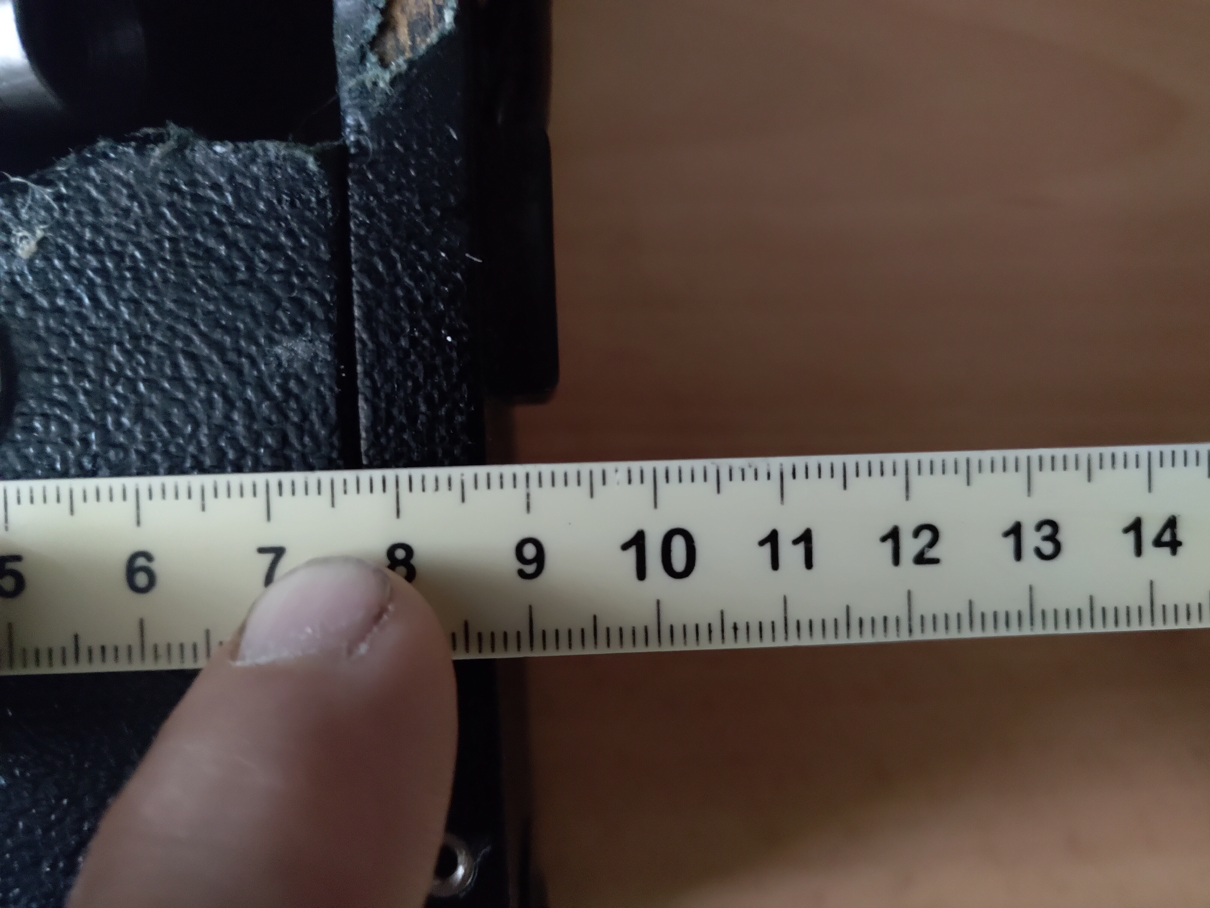

Unfortunately I have the rest of my 102's in a storage locker, if not I would compare the positioning of the metal plate adjusting the speed to the metal plate of another 102 with a flushed motor board before I find the drill. I upload a photo, in case somone has a 102 at hand with a flushed motorboard and can measure its position as I have done on the photo. The measurement was taken with the plate positioned as far left as possible. (measured in cm/mm) 76 mm to the edge of the motor board.

I've just measured mine from the same points, and it is exactly 8 centimetres.

These are interesting observations Barry, thanks for taking the measure. Do you think these 4 mm can cause the problem? I am prone to say yes...myself.
I am already looking for the drill, and move the plate 4 mm...
