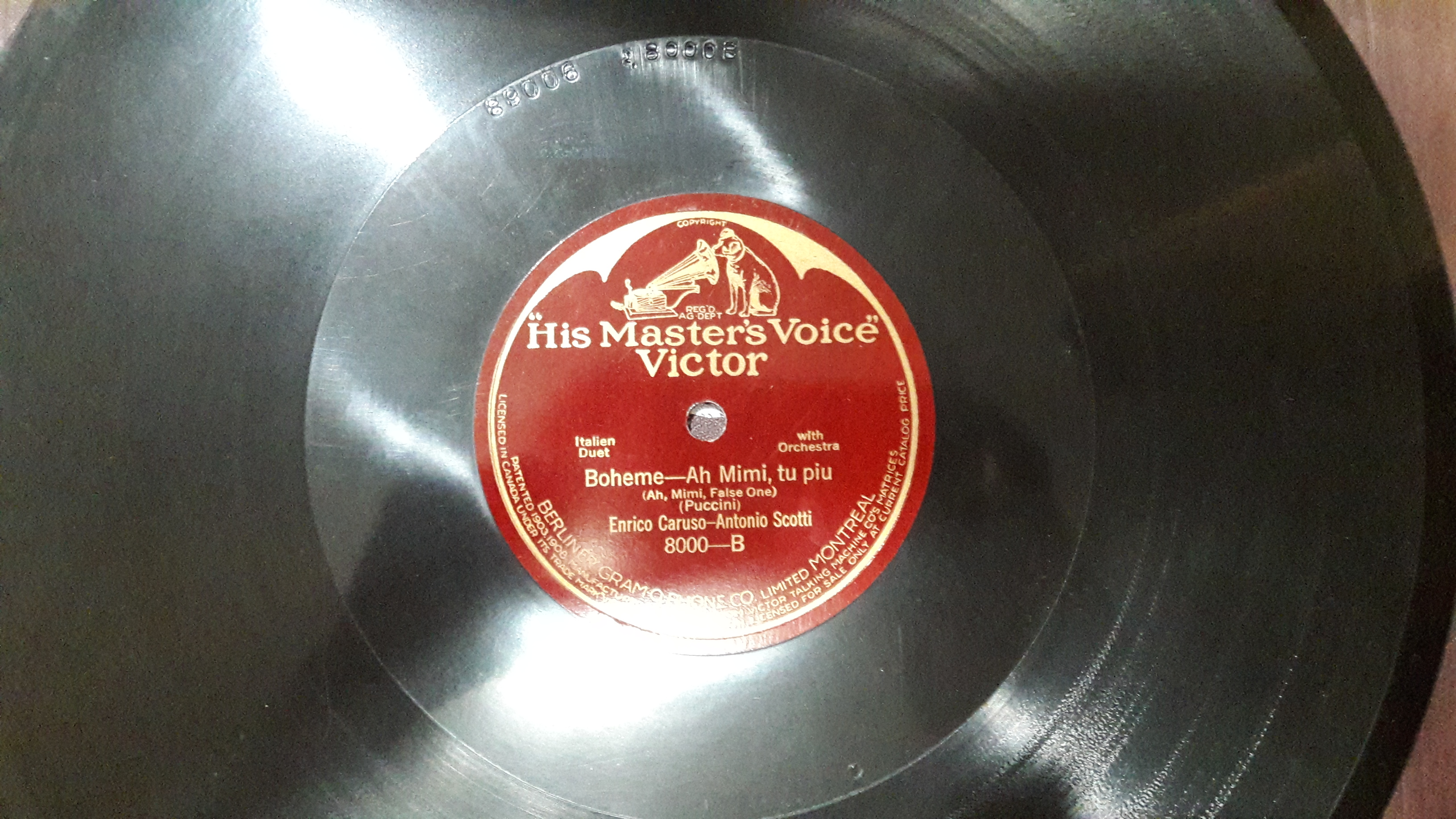

Re: Faust Prison Scene part III--Caruso, Farrar, Journet
The dubbing makes sense especially the problematic 1906 Carusos. The La Forza Duet 89001 and Boheme Duet 89006 especially. I have a 1923 Berliner pressing of these selections on 8000 a/b. But they are not dubs. However I cannot recall seeing a Berliner Gramophone dub in Canada. I have found it interesting that with the transition to double sided Red Seals in Canada, the Berliner Gramophone Company and from 1924 the Victor Talking Machine Company of Canada generally used the original masters with the double sided catalog number beside the original single sided number. Double sided Canadian Red Seals would often include the hand written Matrix number before Victor hid it in the recessed center (although in Canada until 1914, Berliner did not recess the center so that the Matrix number and othyere information was visable there).
I have two copies of the Faust Act V trio with Grand Prize labels only: on with the 1908 label and the other no date which suggest they were pressed in 1910-1914 and they are blank at the 9'oclock position.
My 1906 Di Quella Pira has the July 1906 label on the back which obviously will not be a dub. It plays okay with a finer stylus.
Here is the Boheme which looks as if it is off the original master.

The problematic was the finer groove dimensions which led to premature heavy wear. The La Forza duet by Caruso and Scotti on 89001 is,a good example. I have seen many copies with heavy wear for the first few seconds of playback. It seems that the February 1906 recording session by Caruso was very susceptible to the groove dimension problem as can today be seen and heard on discs recorded on that date.
The Canadian disc 8000 with the La Forza duet on side A looks as if it may be a dub but it doesn't sound like it. The written matrix number is missing but Berliner or Victor seems to often try and conceal it. The B side with the 1907 Boheme duet appear to be from the master. Perhaps by 1907 the cutting stylus dimension issue,had been resolved?
