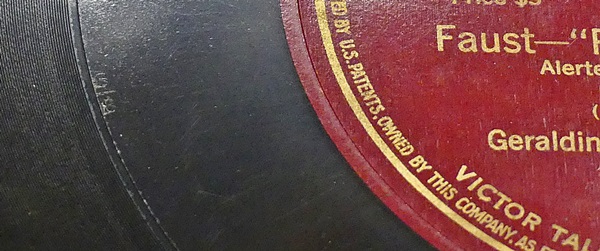

An example:
One commonly found, and audibly fairly obvious, instance is Caruso's recording of "Di Quella Pira" from Il Trovatore. All copies I've seen after the relatively early pressings have been S/8 dubs.

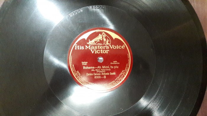

Here is the Boheme which looks as if it is off the original master.

The Canadian disc 8000 with the La Forza duet on side A looks as if it may be a dub but it doesn't sound like it. The written matrix number is missing but Berliner or Victor seems to often try and conceal it. The B side with the 1907 Boheme duet appear to be from the master. Perhaps by 1907 the cutting stylus dimension issue,had been resolved?
