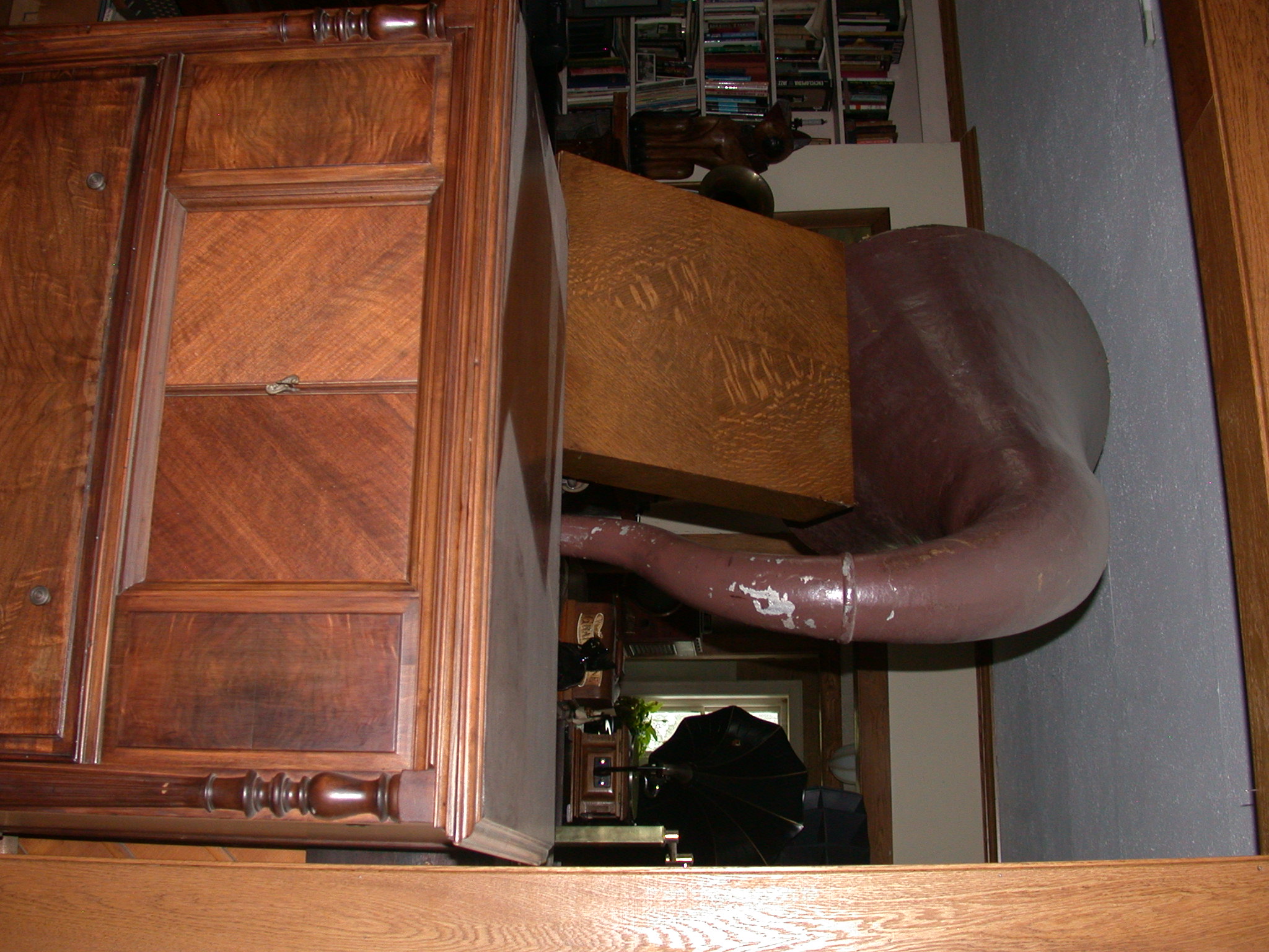

Excellent question Iain. The Mk IX case (without ballast) is quite capable of supporting even an Oversize horn on the cantilevered outrigger to the left hand side of the case but subject to one important proviso. The larger horn should be mounted in such a way across the width of the case so that the weight is taken where all possibility of tipping is dissipated. Years ago I used to reinforce the normal position of the overhung Mk IX support with wedges to allow use of the Oversize horns (slightly nose-heavy) without toppling, which system worked well until one evening they became accidentally dislodged with disastrous consequences. One learns from one's mistakes (hopefully)................! One also suspects that EMG quickly saw the good sense of having a conduit outlet at the centre of the case for all the (heavier) Mk Xs.
The attached photos (including some of the usual suspects !) make the point :

I am sure you are right and the general idea would indeed have been to aim for the C of G to be roughly over the spigot. The swan's neck design is attractive so there were probably cosmetic considerations as well. The spigot was made of strong bronze, rather than brass, as the diameter and wall-thickness was not great. However, most of the weight of Mk Xa and Xb horns is in the aluminium castings thus the extent of the bell does not make a huge difference to the balance. In my experience most EMG horns are slightly nose-heavy but the Mk Xa, Xb and Xb Oversize examples never suffer from the dreaded droop thanks to the extensive castings (all of similar dimensions) at the high stress points---excellent design. Earlier swan's neck horns---Mk IX and X---did droop/snap due to the lack of adequate metal structure .

I couldn't agree more about the center of gravity issue with the horn. And have always used the diagonal position for it.
