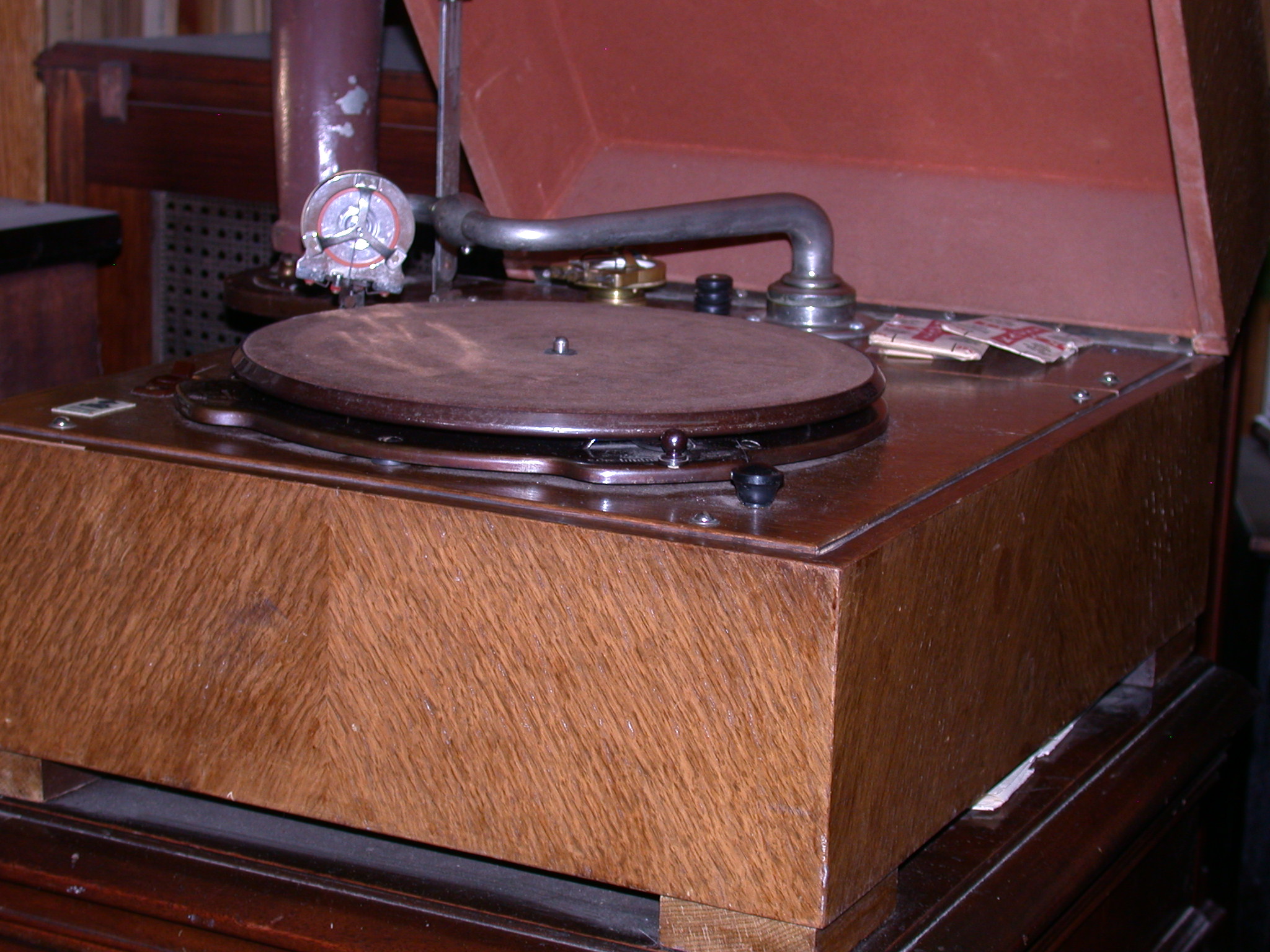

I've just finished combining parts from 2 Garrard motors to make one good one. A model AC 7. And it performs splendidly.
But I had to get inventive when having to concoct a set of 3 rubber washers used to isolate the motor mounting plate from the main top plate. The 60 cycle hum from the motor isn't too bad, but I can't get past the idea that it could be better if I could find modern and correct hardness replacements for the now old and hard as a rock originals. And I have what I'd call 3 metal spacer washers left over and I can't remember where they go. They were on the motor to begin with. Everything in /on the motor or mountings are correctly tight so there is nothing loose to cause vibration.

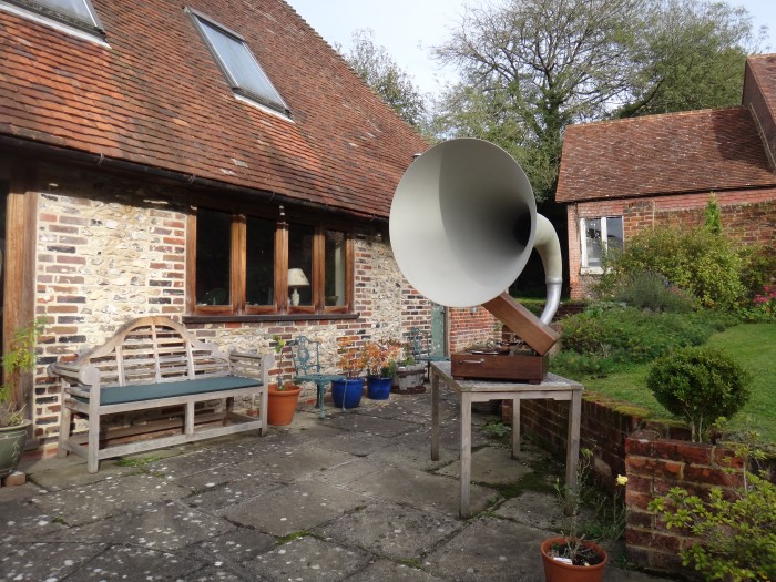

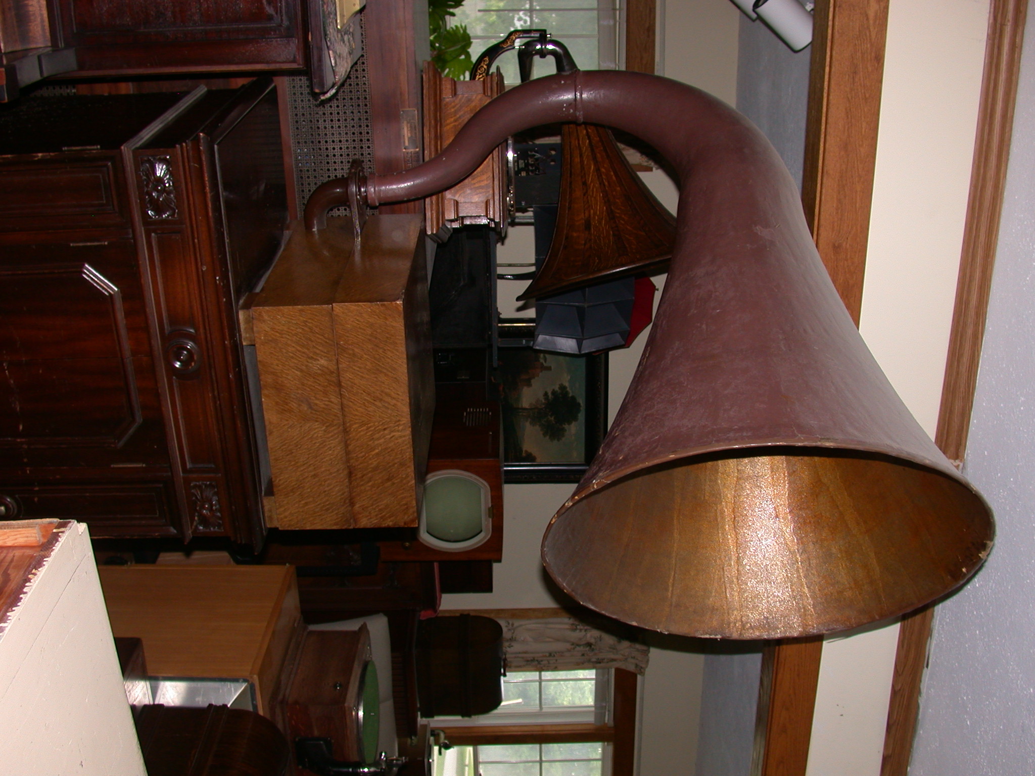

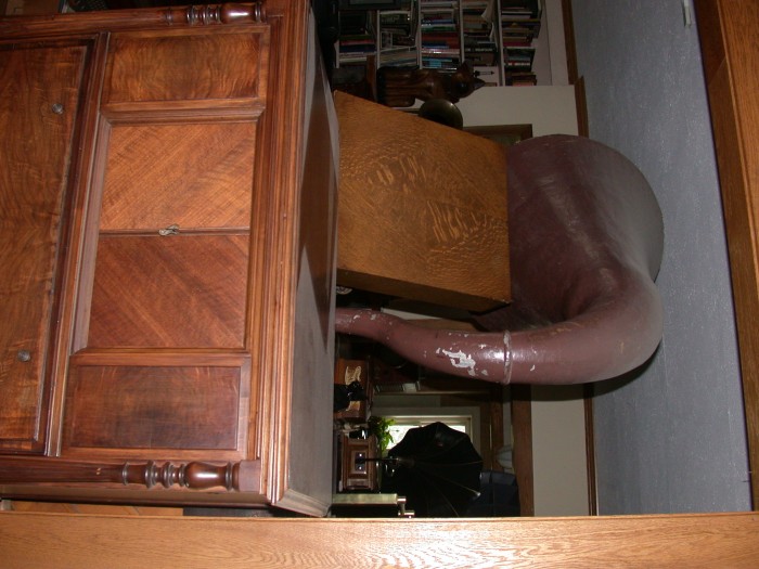

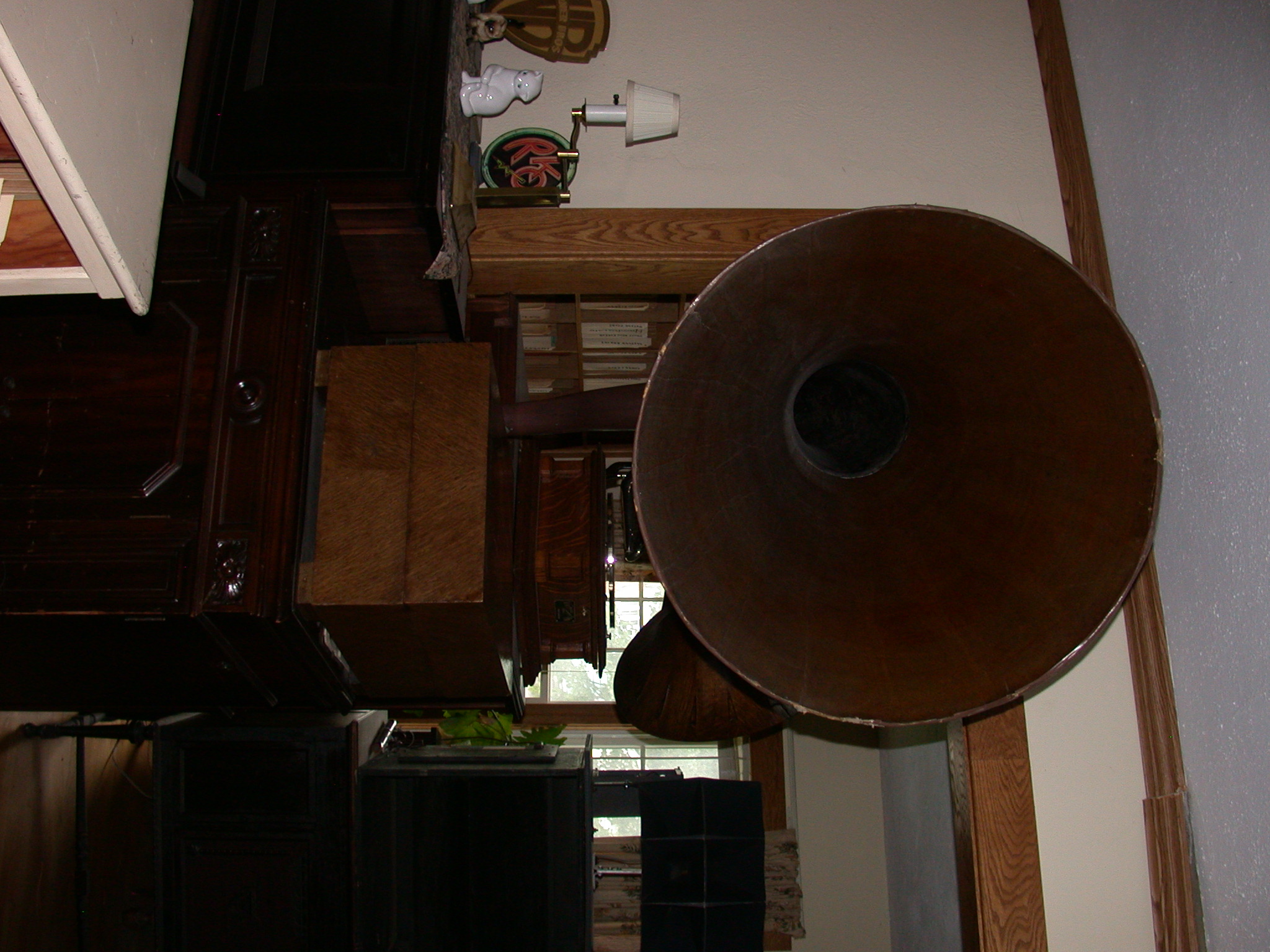

Graham, do you think it is necessary to put ballast into the bottom of the case or strengthen the side extension if fitting a larger size horn to a Mark 9 gramophone or is the original structure well capable of supporting the extra out of balance loads imposed?

Excellent question Iain. The Mk IX case (without ballast) is quite capable of supporting even an Oversize horn on the cantilevered outrigger to the left hand side of the case but subject to one important proviso. The larger horn should be mounted in such a way across the width of the case so that the weight is taken where all possibility of tipping is dissipated. Years ago I used to reinforce the normal position of the overhung Mk IX support with wedges to allow use of the Oversize horns (slightly nose-heavy) without toppling, which system worked well until one evening they became accidentally dislodged with disastrous consequences. One learns from one's mistakes (hopefully)................! One also suspects that EMG quickly saw the good sense of having a conduit outlet at the centre of the case for all the (heavier) Mk Xs.
The attached photos (including some of the usual suspects !) make the point :

Thanks for your explanation Graham. I never gave it much thought before, but just assumed that the curved shape of the EMG Mk X horns was designed so that the centre of gravity was over the spigot (but of course I may be wrong) As the larger horns were introduced did the rearward section of the horn project further back to maintain the centre of gravity or did the C of G move significantly towards the enlarged bell and hence introduce the toppling moment.

I am sure you are right and the general idea would indeed have been to aim for the C of G to be roughly over the spigot. The swan's neck design is attractive so there were probably cosmetic considerations as well. The spigot was made of strong bronze, rather than brass, as the diameter and wall-thickness was not great. However, most of the weight of Mk Xa and Xb horns is in the aluminium castings thus the extent of the bell does not make a huge difference to the balance. In my experience most EMG horns are slightly nose-heavy but the Mk Xa, Xb and Xb Oversize examples never suffer from the dreaded droop thanks to the extensive castings (all of similar dimensions) at the high stress points---excellent design. Earlier swan's neck horns---Mk IX and X---did droop/snap due to the lack of adequate metal structure .
Expert, by contrast, produced "up-and-over" horns with a greater preponderance of lightweight paper but minimal metal castings (plus metal under-gussets) the lighter of which have survived well. Many, however, were too heavy and do suffer from droop at the greatest stress points even though the strength of the bell mouth was augmented by an incorporated metal ring. The design cannot be said to be the best from a structural point of view. However, spigots were much larger in diameter and therefore stronger and made from thick-wall aluminium.

I recalled that have a "London" brand valve based portable machine in my attic and it uses the AC 6 style motor as the EMG, so I can use it to determine the correct placement of the rubber washers. It looks as though it was never disassembled. By your leaflet image, the 3 metal spacer washers appear to be used to adjust the motor/turntable height as necessary. It's fine without them. They were probably used to take up space on the 3 fixing bolts, underneath the motor sub mount plate, on the 3 nut/bolt assemblies.

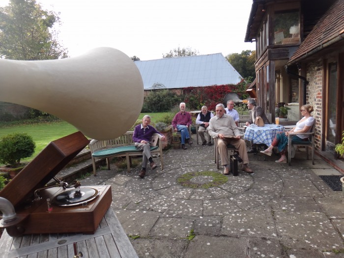

Wish I could have been at your garden listening party with a few select discs !! How perfectly splendid !!
Do you remember what was playing in that picture? I can easily hear Eric Coates, Sir Henry Wood, Geoffrey Toye, Sir Edward Elgar, Percy Fletcher or Sir Thomas Beecham holding forth. Or any host of fine British performers, In both popular and classical veins. Far too many to try to list.
