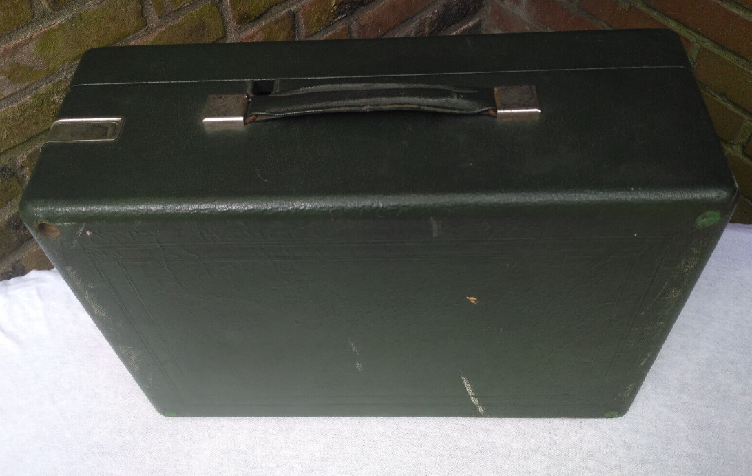

The picture here is not of my machine but is one of the same era (mid 30s).

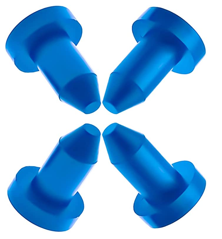

I am thinking about checking out kayak drain plugs. In North America, these are ½" in diameter and made of neoprene rubber. The holes for feet in the 102cs are ½". The plugs could be cut down to the depth of the foot hole and glued in. The plug flange would/could make a nice foot. Unfortunately these are also only in black.

But kayak drain plugs are available in (a lurid) blue silicone rubber.
https://www.amazon.ca/savone-Silicone-F ... 44&sr=8-21
