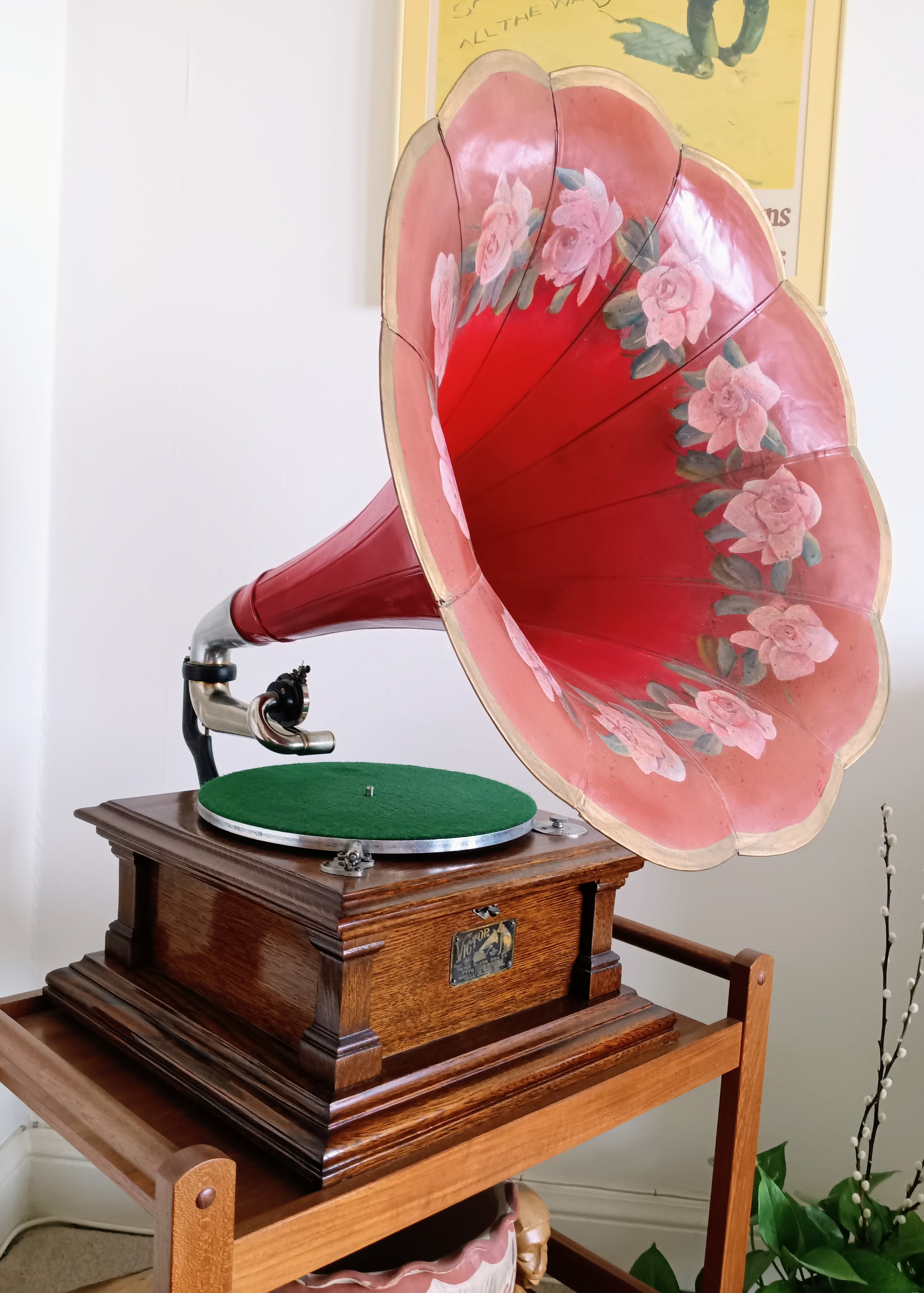

By that definition, I think my circa 1907 Victor V would qualify as a Frankenphone! :o
(Click images to view full size.)
When I received it from the former owner--the granddaughter of the original owner--some 38 years ago, it has been badly damaged. (The granddaughter's former "boyfriend," call him "Bruno," had picked up the Victor V and thrown it against a wall! Fortunately, the horn was not attached at the time.)
Not only did the case need re-polishing, but one of the three mainsprings as well as the governor springs had to be replaced. The cracked apart motor board had to be re-assembled, with wooden dowels installed inside the joining edges for support. The front board was smashed, so I had to glue the parts together and cover it with a matching piece of oak veneer.
In addition, the horn is an after-market H&S style morning glory horn--repainted about 70 years ago. The horn's elbow is a "reproduction" aluminum replacement. The horn support is held in place with two conventional black painted bolts. (I was told that the originals went missing at the time the granddaughter's father owned the gramophone.) Lastly, the Exhibition sound box, which was rebuilt by the late Bob Waltrip, has a triangular hole and is obviously a replacement for the original sound box.
