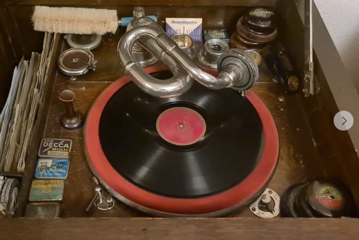

Re: longest tonearm?
Ha!
Not quite what I’m after, but impressive all the same!
- Posts: 328
- Joined: Wed Mar 22, 2017 3:13 pm
Simply amazing!!!! But how about the sound?

- Posts: 4453
We simply don't know yet... about the sound of the rare spiral tonearm. There seems to be no video of this machine.
